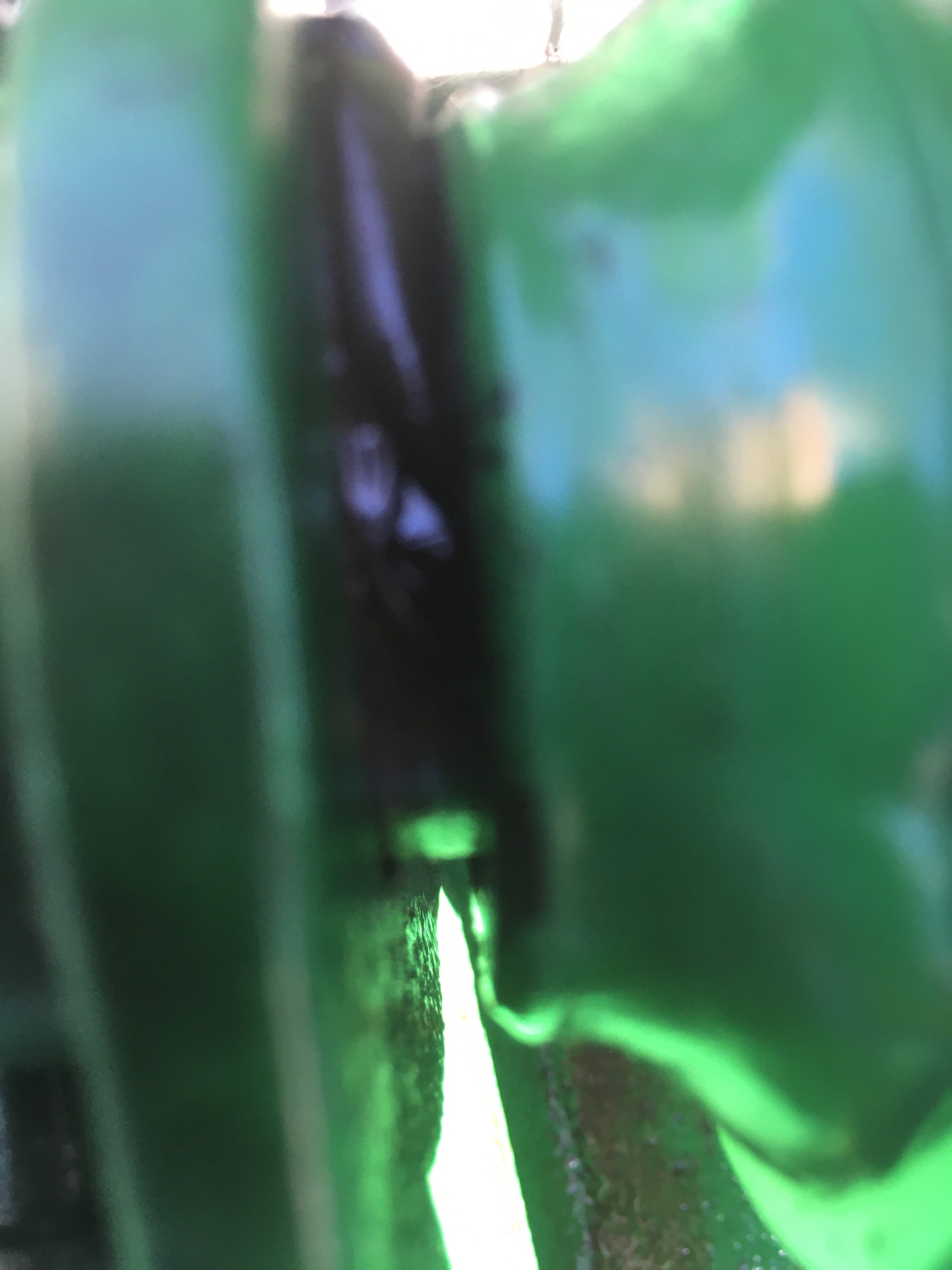

   / Good morning!!!! #104,649
Ahh the bead of grease forming in the cleaned out joint, a pretty sight. I followed LouNY advice and took out the zerK (zerk itself was not clogged) and cleaned the grease from the joint, sprayed it with carburetor cleaner (we don't have brake cleaner) moved the bucket back and forth, repeat 3 times, reassemble and the grease bead appears. Thanks.
   / Good morning!!!! #104,650
That's good news Don.
