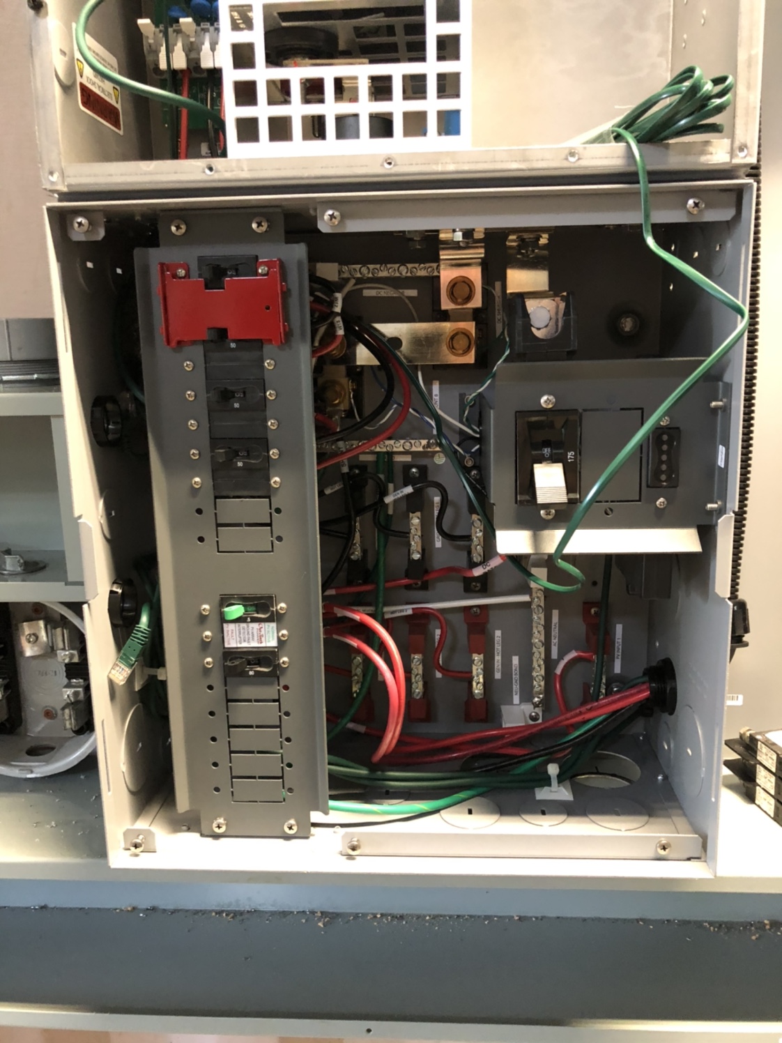

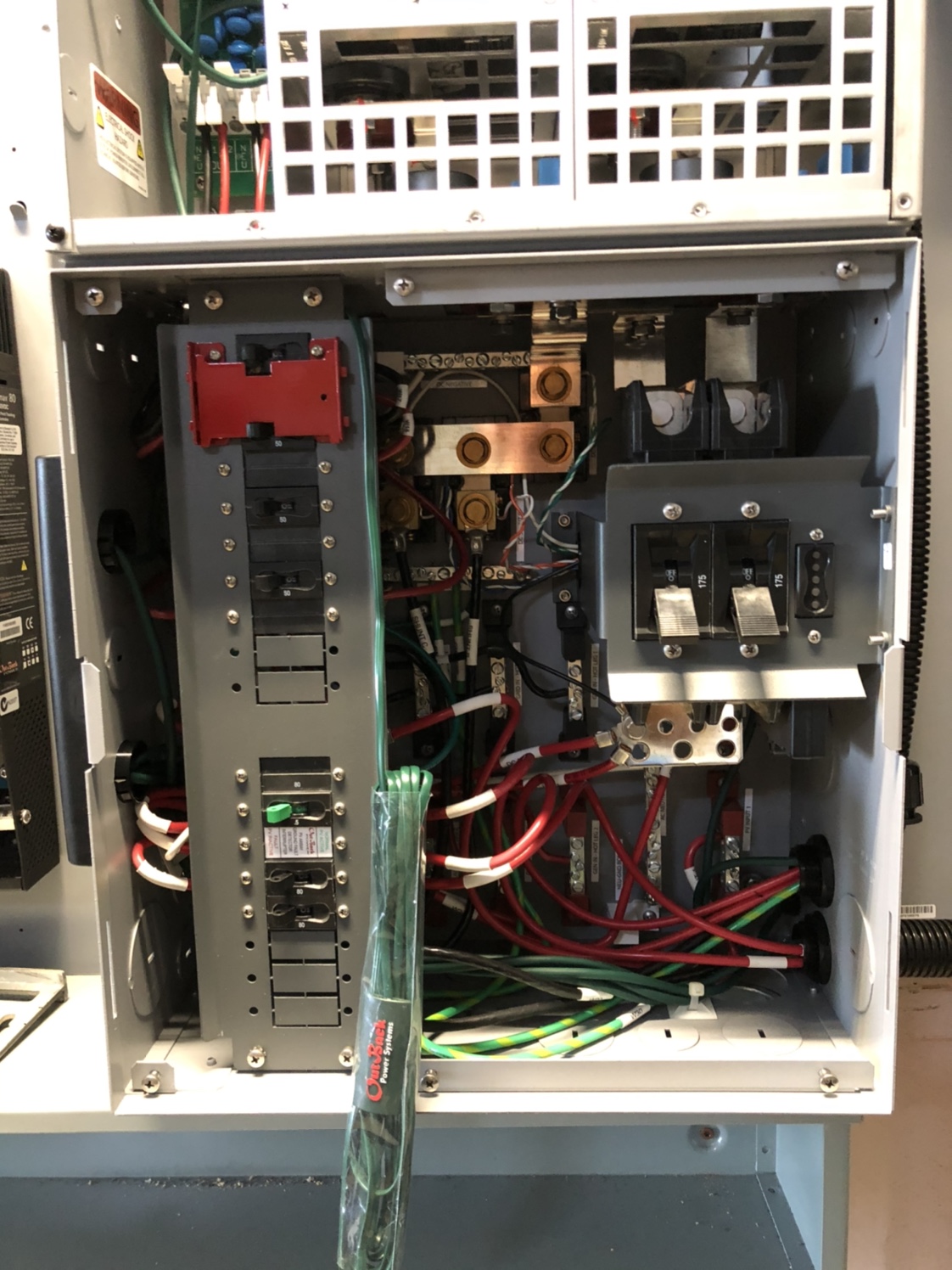

Notice breakers in lower left for FM80 CCs
4048
8048
Is the 4th FM80 not wired yet?
Is green breaker the FM80 dc out with shunt? Or is shunt in the 175a dc breaker?

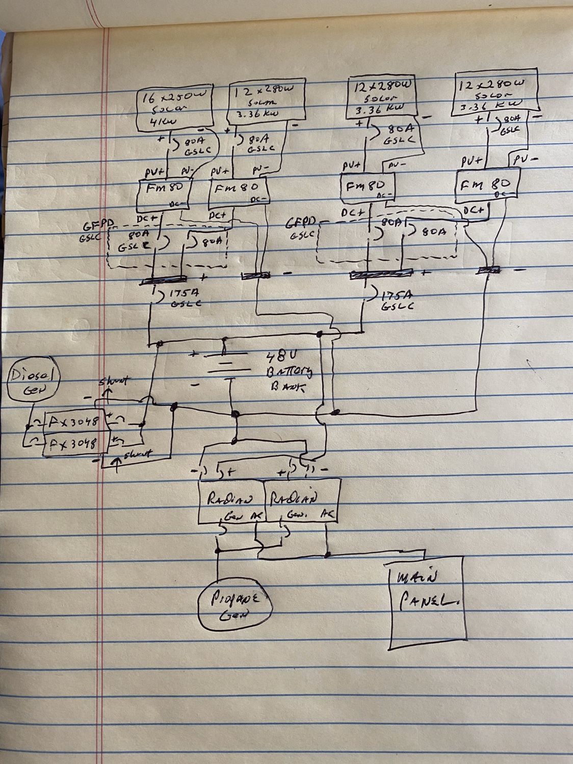

I believe the FM80 breakers are in the Load center. That is part of today, adding the 2nd CC and appropriate breakers to the 4048 system.
System will only use 3 shunts.
A - all the Radian inverters
B - all the FM80 CC
C - my FX external chargers.
I’ll get an as is pic after coffee, then update after all together.

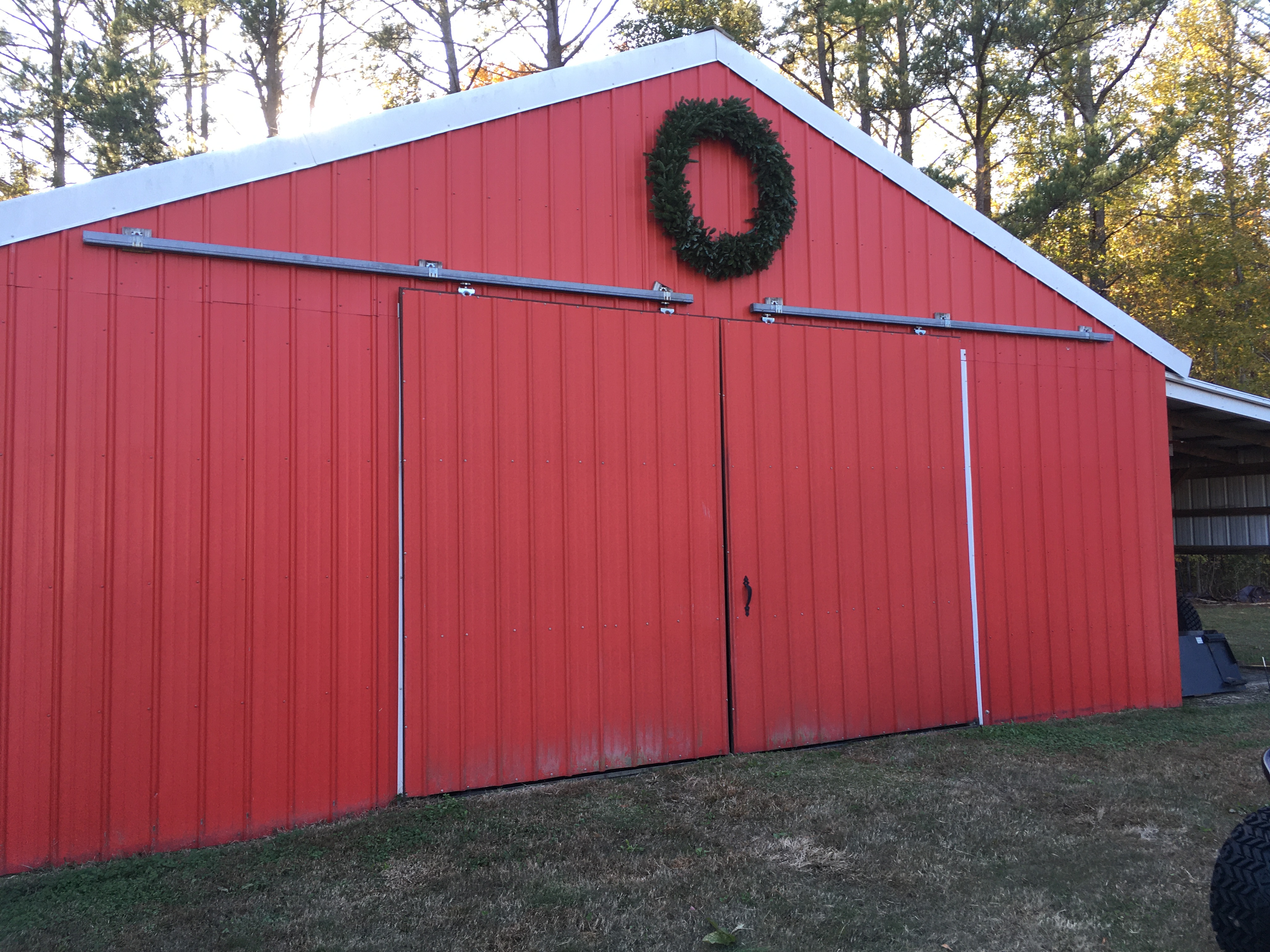

very successful afternoon with next door neighbor. Taking Ron's suggestion, heated up the yellow cover of the rv power cable and with some twisting
around it went right on. One down. Then, since he was here, and my xmas wreaths were delivered from Master Gardener benefit sale, we put up the big 36 inch wreath on the barn. And thank you, thank you to the prior owner. Nice fat nail already sticking out of barn in just the right place.
Not the first wreath to go up there in 30 years.
Now to get a red bow on it and some led lights. I was asked to put it up plain since they wanted a picture of this size for next year's catalog.
Little more effort decorating at top of ladder but doable.

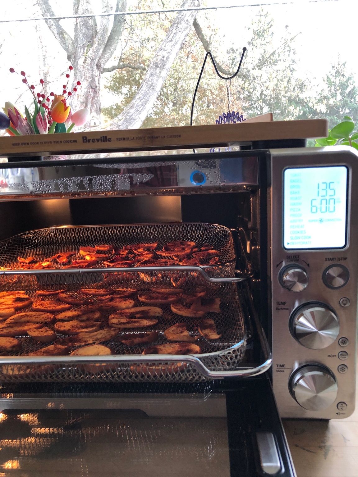

Coffee is done brewing. 35ー with mostly cloudy skies this morning. Heading to 43ー with mix of sun and clouds. Dentist appointment got canceled because hygienist cut her finger. Hope she is back tomorrow for rescheduled appointment. Conserved energy most of the day. Going to try dehydrating some apples today in toaster oven.
When you go away for a long trip, do you disable diesel backup? If it runs you need to manually reset the FM80 breaker to have panels charge batteries.
Not wired. The Prewired 4048 comes with just 1 CC
Green breaker is GFCI
No, generators stay enabled.
No resetting, the CC have own programming.
