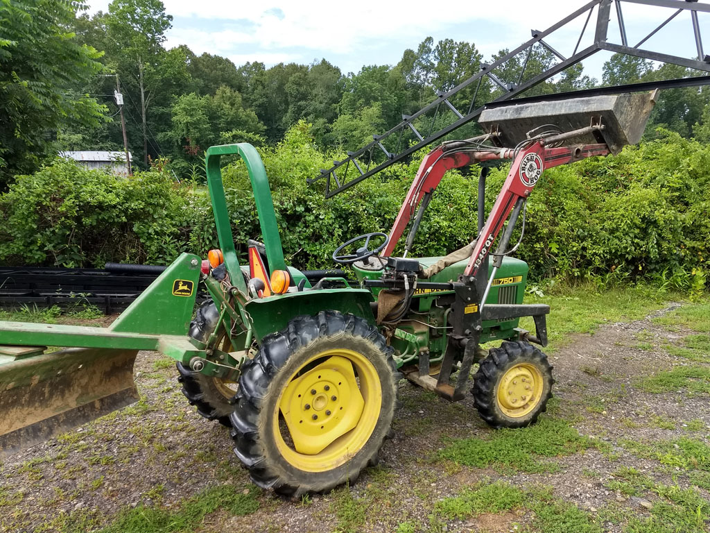

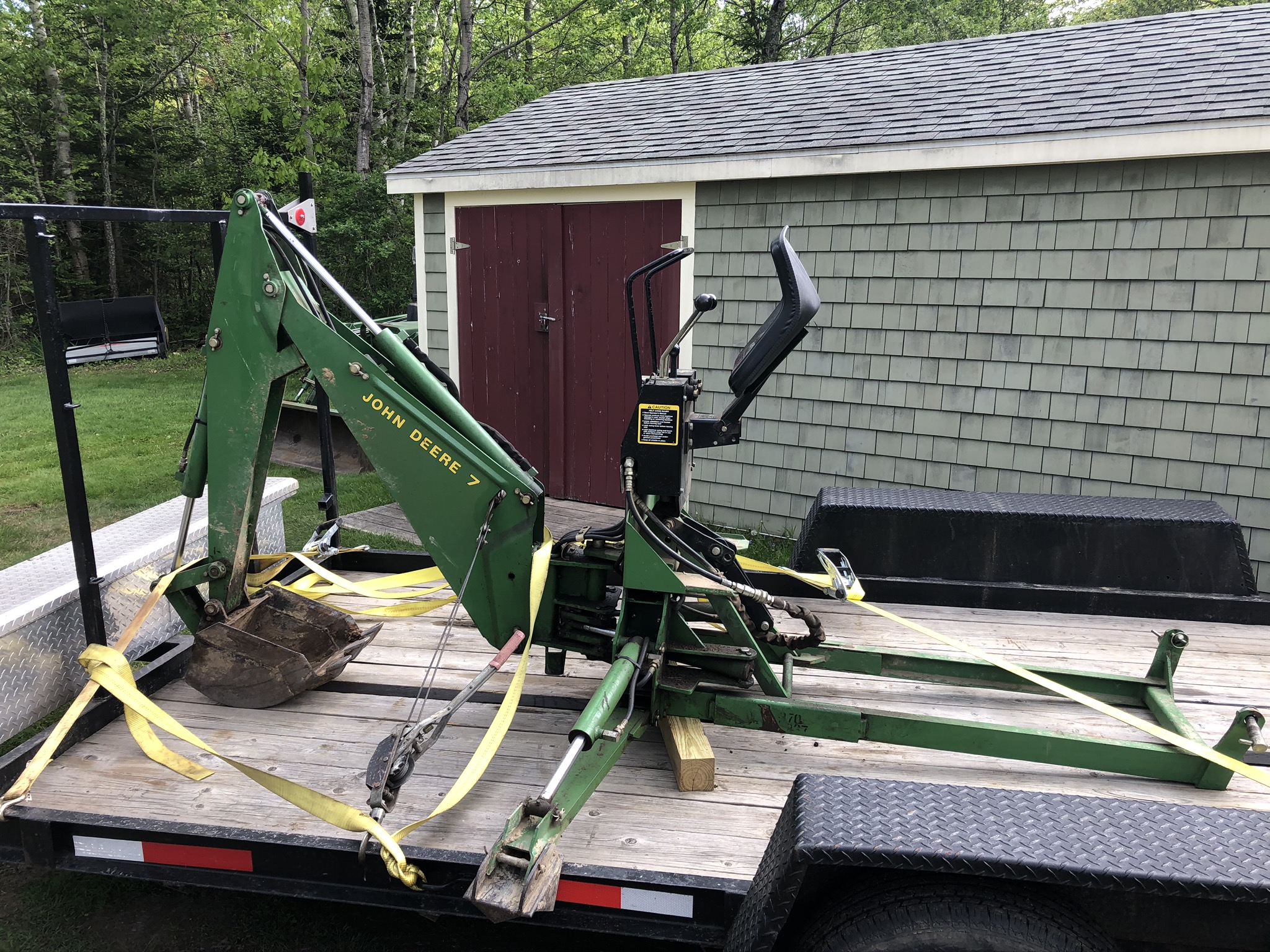

I have my late dads JD 750 that we have had forever and I have always wanted a backhoe for it. The Bush Hog front end loader has seen a lot of use over the years.
I found a #7 backhoe that looks to be in great shape. Thing is it is coming off of a 955 tractor. So is it going to be hard to find a subframe? Or should I just fab up something since I am a 45 old year machinist?
Below is my 750 and the backhoe I am buying.

Since you obviously do have the technical skills, I would definitely suggest that you make your own sub frame.
I think it would be VERY difficult to find a sub frame already made for your tractor, since others are ALWAYS looking for such things.
Perhaps you could get some factory built sub frame diagrams, or pictures before you begin.
That is a BEAUTIFUL clean looking little hoe!!
DO NOT BE TEMPTED TO EXPERIMENT WITH THAT HOE ON YOUR 3PT. HITCH!!

Take a look at how similar hoes are mounted on a frame support with JD tractors.

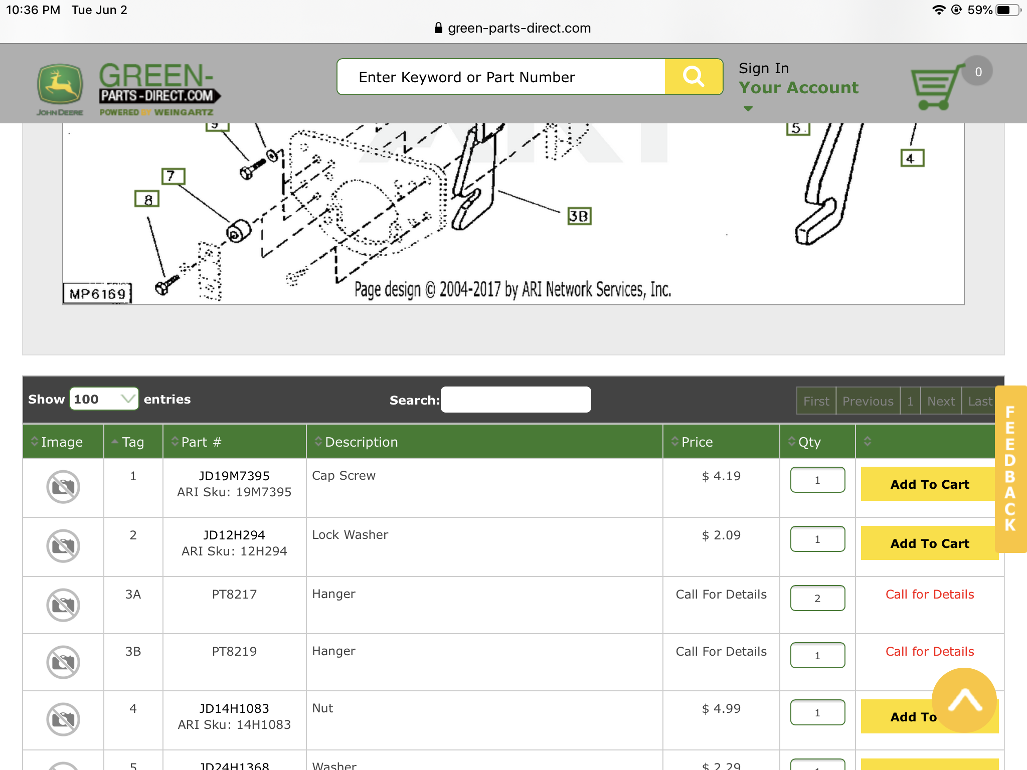

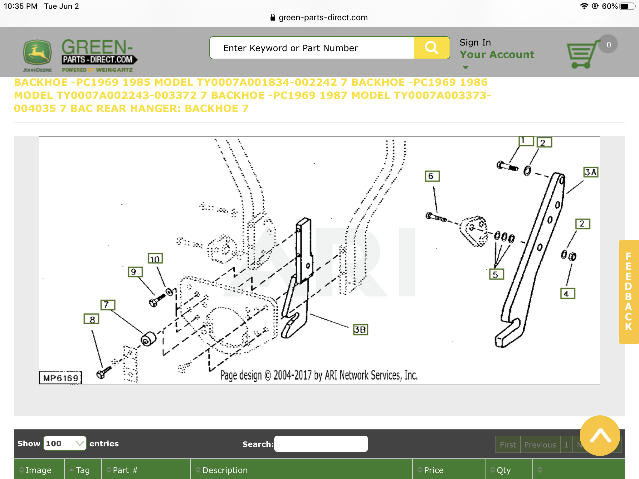

Go to the jdparts site and for the model #7 you can look at the hangers spec'd for the 750 as well as those spec'd for the 955. Gives you a chance to compare the parts for fab'ing your own.
John Deere Parts Catalog

My 750 does not have draft control. This little tractor is 4x4 non power steering and completely manual transmission. It is a pain to operate, but it is a tough little bugger.
Yes, they sure are tough. Those 650 through 1050 JDs were just about the perfectly tough simple compact tractor. Made by Yanmar for JD, they used the newer 3 cylinder Yanmar engines, frames, and most importantly: that patented bevel gear front axle. By that time Yanmar had gone completely to power shift transmissions and hydrostatic power steering for their own tractors.... but for the JD models they coupled the new engine to their older manual transmissions. The result was a tractor that is still near bulletproof some 35 years later and probably good for another generation.
For awhile, JD offered a bolt-on accessory power steering assist cylinder for the smaller 50 series. Cost was about $700. That was a hybrid solution to try to ease the over-heavy steering on those tractors with a load on the FEL, and never was real popular. The steering-assist cylinder ran off the tractor hydraulics and added hydraulic power to the drag link. If you find one, it might be worth having. The power assist cylinder was bad about leaking, but easy to fix... annually....

When you pick the model of your tractor on their site it dont refresh to the picture you need. Or dont show a picture at all. Pretty much useless.
I sure would like to have pics of the 7 mounted on a 750.

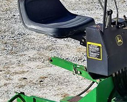

Here is another pic of my subframe.
