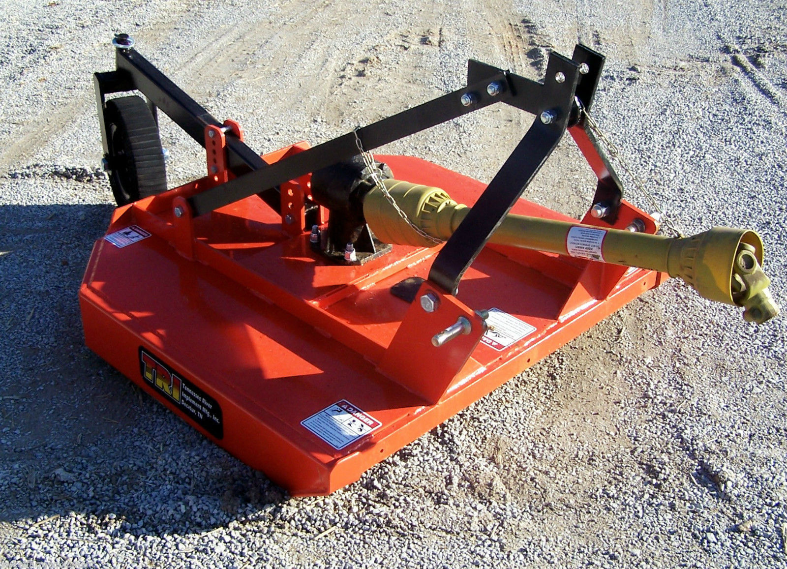

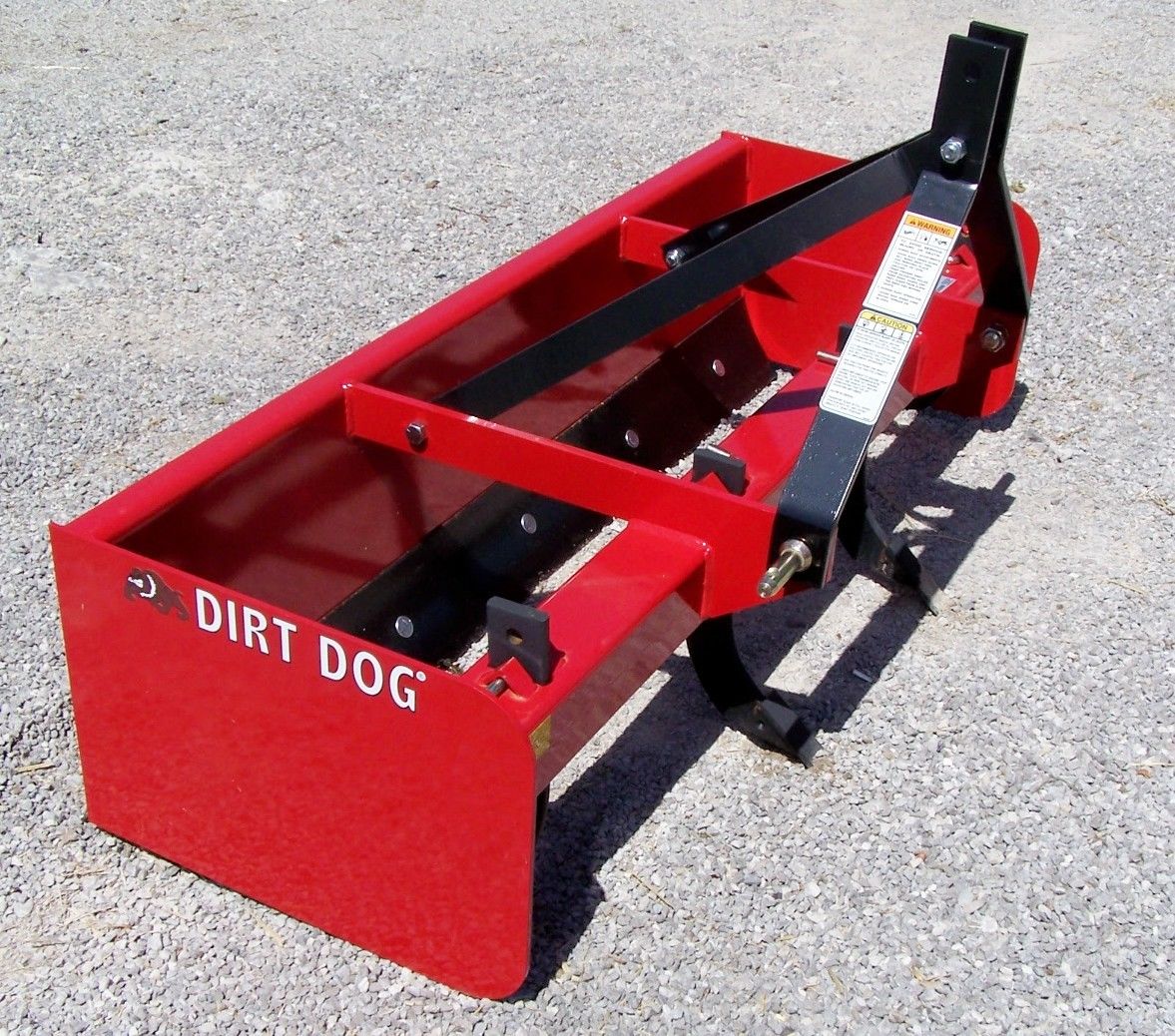

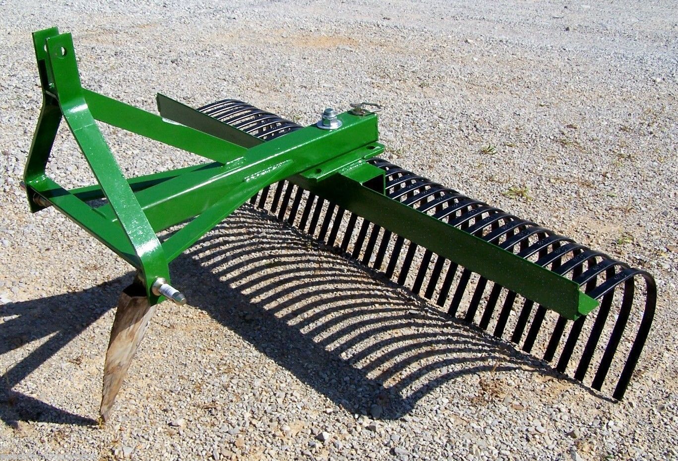

I can deliver to Theresa Wi, a new Tennessee River 5 ft rotary cutter, new Tennessee River 6 Ft Landscaper rake and a new Dirt Dog 5 ft box blade for $2500. Ken Sweet
