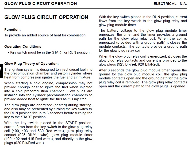

If it may be the 4100, then here is a blurp from the service tech man.

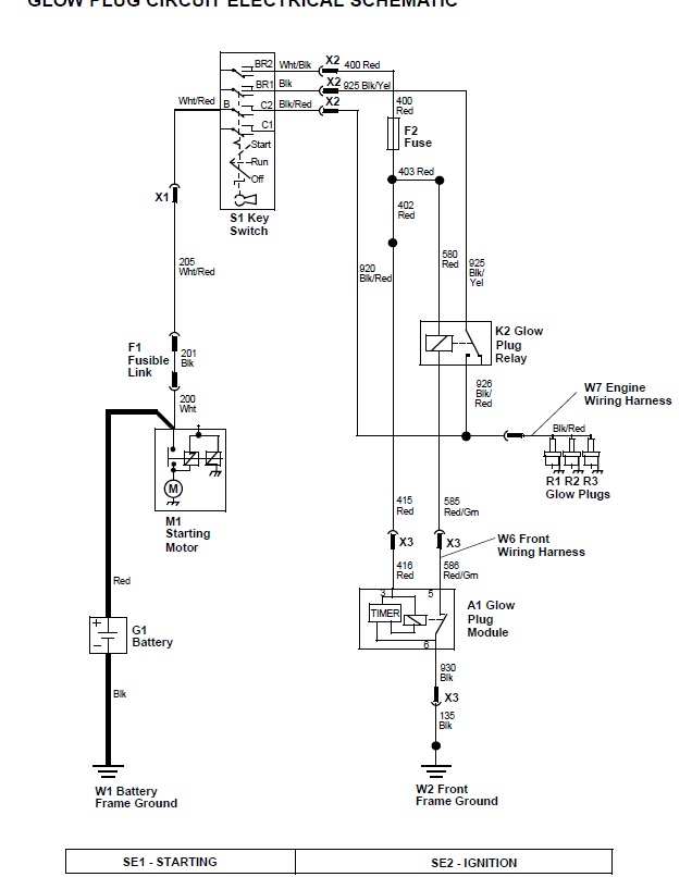

I have power to the fuse when I turn on the key and the motor and battery light come on then after few seconds the dash lights get brighter and I hear a faint click .but no power at plugs . I take a 12volt test light clip one end to block prob to terminal on glow plug there is not ever any voltage at plugs

Here is a section I found on the 4100, in the service tech manual. Maybe help you track it down...

/ Glow plugs no power #13
Use diagrams to track voltage to/at relay and passing through rest of circuit. Determine where power drops off. Again verify any fuses in circuit both visually and with ohm reading across the actual fuse- removed from it's holder.
/ Glow plugs no power #14
My guess is a faulty GP control relay or bad ground on GP timer.
