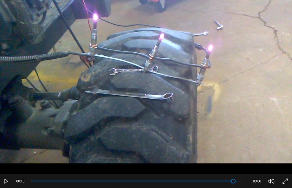

Since I got my M/F 1529, last fall, it has always seemed to cold start kind of dirty to me. I recently pulled the glow plugs and checked them for visual performance. They did have some carbon deposits, which led me to believe, that they weren't getting hot enough in 15 seconds. They all measured about the same resistance and all glowed. In the initial test, the center G/P didn't appear to me, to be quite as strong. After about 15 seconds. FYI: These NGK G/Ps are $70.00 ea. from a dealer, but can be gotten for less that $15.00 ea. on the Internet

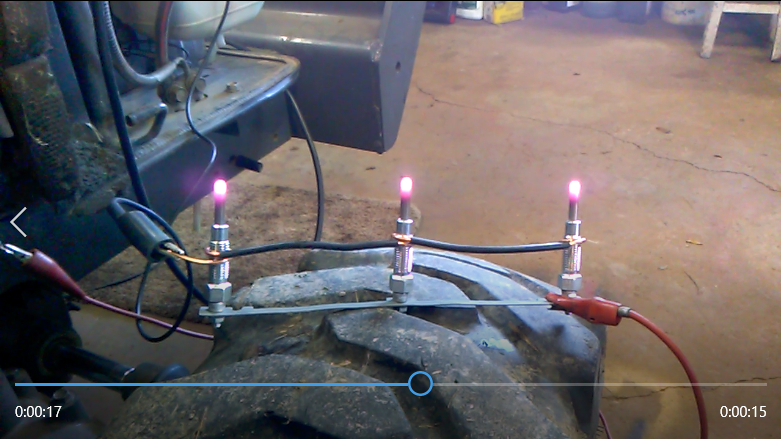

I got 3 new G/Ps and did the same test.
I believe, the new G/Ps allow cleaner cold starting, but it's been a little warmer, so haven't really come to a final conclusion.

These NGK G/Ps are supposed to be "QGS" (QuickGlowSystem) with a time factor of 6-10 seconds. With 3 of them in parallel, and using an 8 second average time, it would seem that a 24 second "G/P on period" should bring them to optimum performance. (Only 1/3rd of the total current would pass through each.) ??
