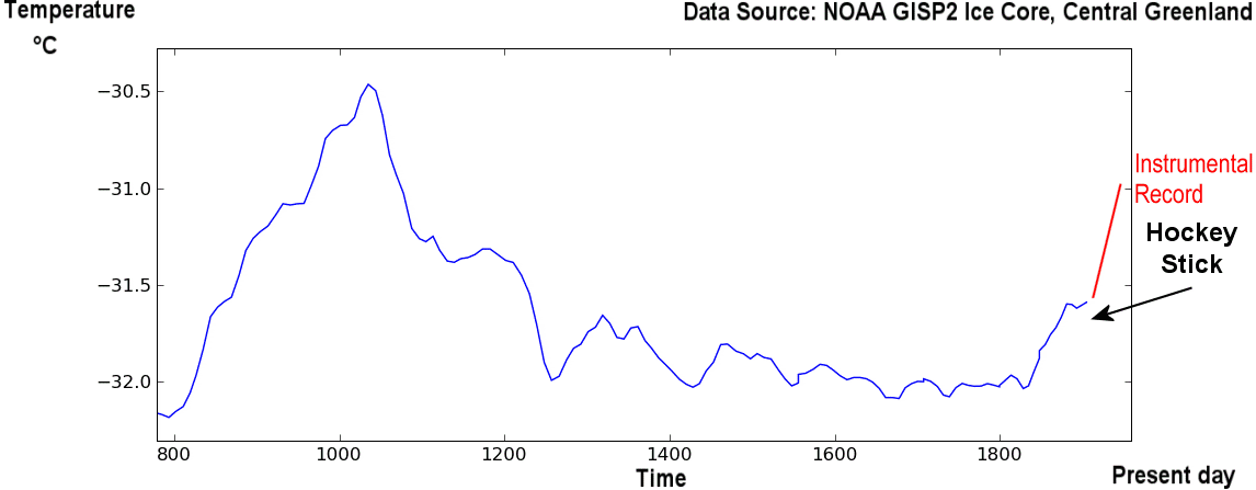

Back to global warming:
You have heard the word "unprecedented" used in regard to our current apparent warming event. Looks like the medieval warming period was a bit warmer than now, doesn't it? This is data from NOAA, not some crackpot. And that pesky medieval warming period was left out of the 2001 IPCC report. Must have missed that, somehow, but they did have it in an earlier report. Including it in 2001 was just inconvenient, I guess.

/ Global Warming News #278
OMG, how did we survive that and the black plague? Hotter than now, do tell!:eek: Sounds like a skeptic story to me. :D Are the dinosaurs OK? :rolleyes:
You have heard the word "unprecedented" used in regard to our current apparent warming event. Looks like the medieval warming period was a bit warmer than now, doesn't it? This is data from NOAA, not some crackpot. And that pesky medieval warming period was left out of the 2007 IPCC report. Must have missed that, somehow, but they did have it in an earlier report. Including it in 2007 was just inconvenient, I guess.
What the graph shows is ice cores taken from Greenland indicate it had a significant warming period. Other collected data shows that approximate level of warming extended into parts of Europe also.
What the graph doesn't show is that the entire globe had a similar and uniform warming spell. From what I have read, when evidence that this was a global condition is looked for, they don't find it.
If you think they didn't find it on purpose, or whatever the case may be, the best way to prove that is to collect and analyze data yourself. Maybe you could start a foundation that collects donations to fund climate research. It is possible you will have many contributors.
In the reading I've done, and it's good this thread encourages that, I have never seen any reference to a researcher denying there was a Medieval warming period in Greenland and adjacent areas.
