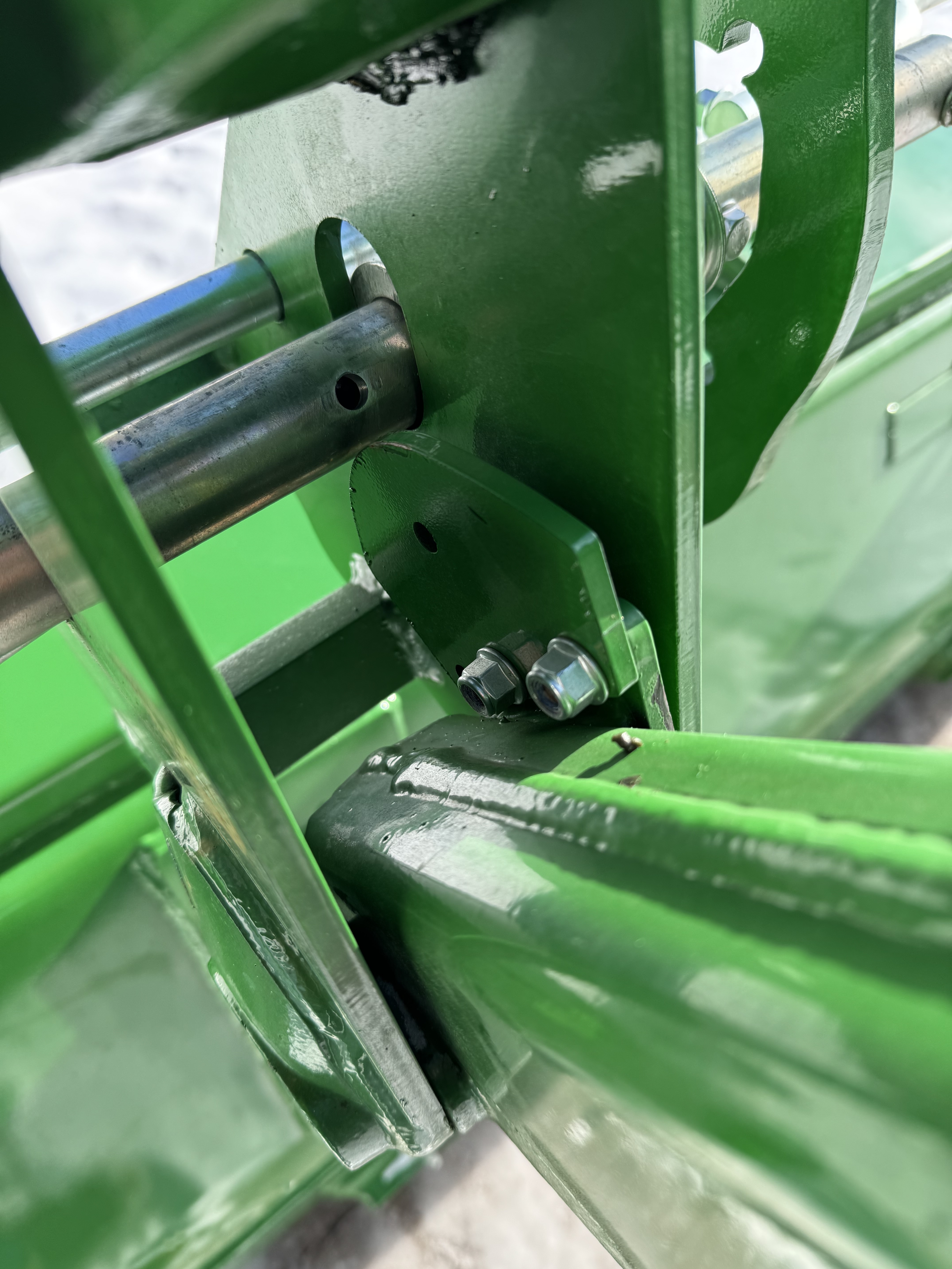

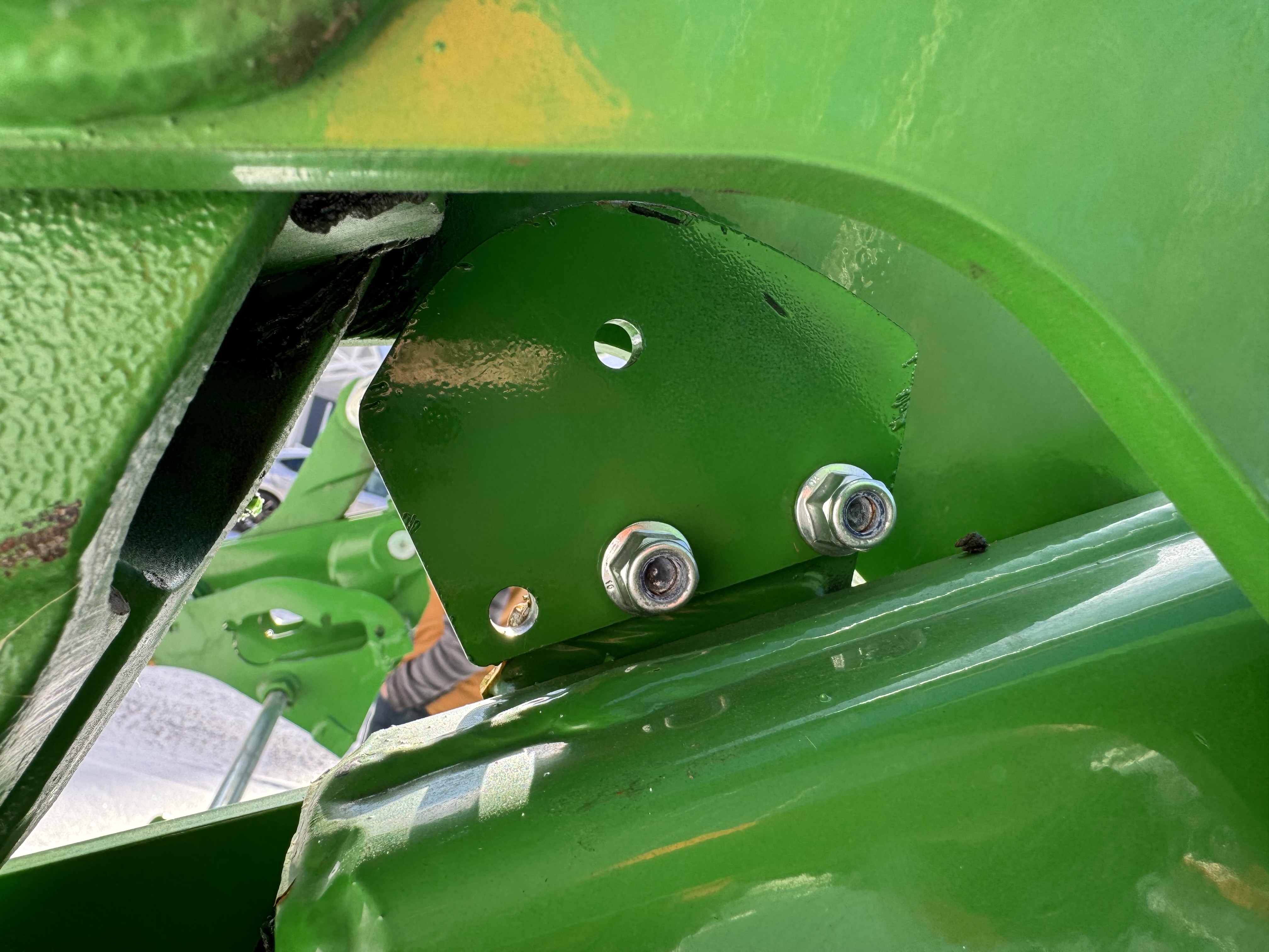

Here’s my global on 540m loader . Is yours missing the curved piece of steel attached with 3 bolts? It pushes up on the rod to dislodge the little locking rod on outside of frame , happens about last 3” of curl back.

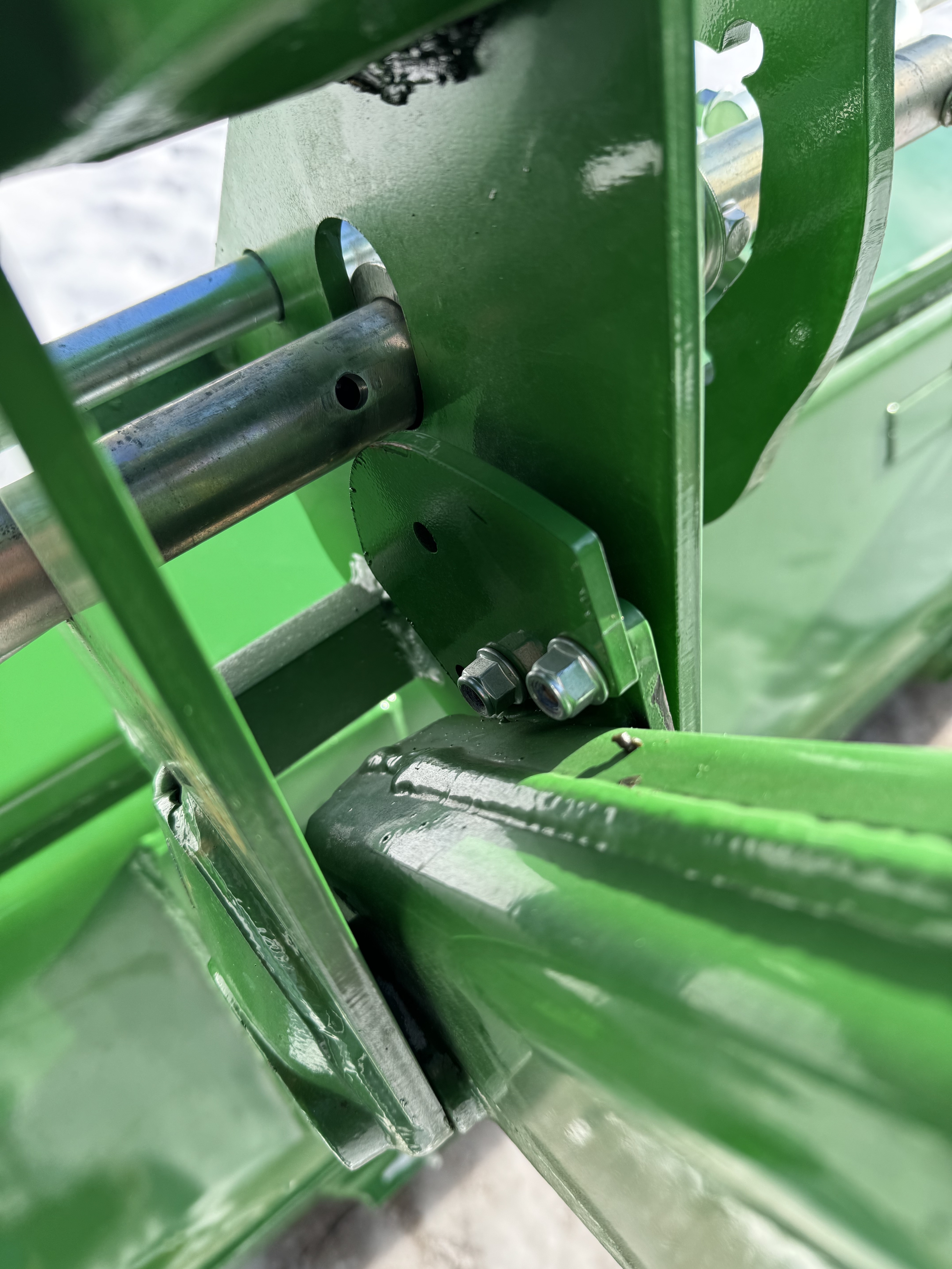

That sounds very similar to the style of auto lock on my 540R loader . Ear on attachment pushes the lever disengaging the J hook. 540M uses a different trip style, both work excellent

my loader has the curved steel plate that seven gables mention and it automatically latches when I hook the bucket up but not the forks. The forks are AP16G by frontier and weigh 550lbs. I am wondering if the plate can be adjusted somehow?
/ Global / euro not automatically latching #14
The global trip system used with the 540m loader functions independently of whatever attachment your using, the curved trip plate is bolted directly to the loader arm . It should trip and lock without any attachment mounted when you fully curl the tilt back.
It trips with your bucket so it tells me the trip system is working.
As to weather theirs any adjustment to the trip plate I’ve never loosened the 3 bolts to see but I kinda doubt there is.
Next time you hook the forks up your just going have to look very closely and try to see what’s stopping the system from snapping closed. Take some pictures and post would help us all .

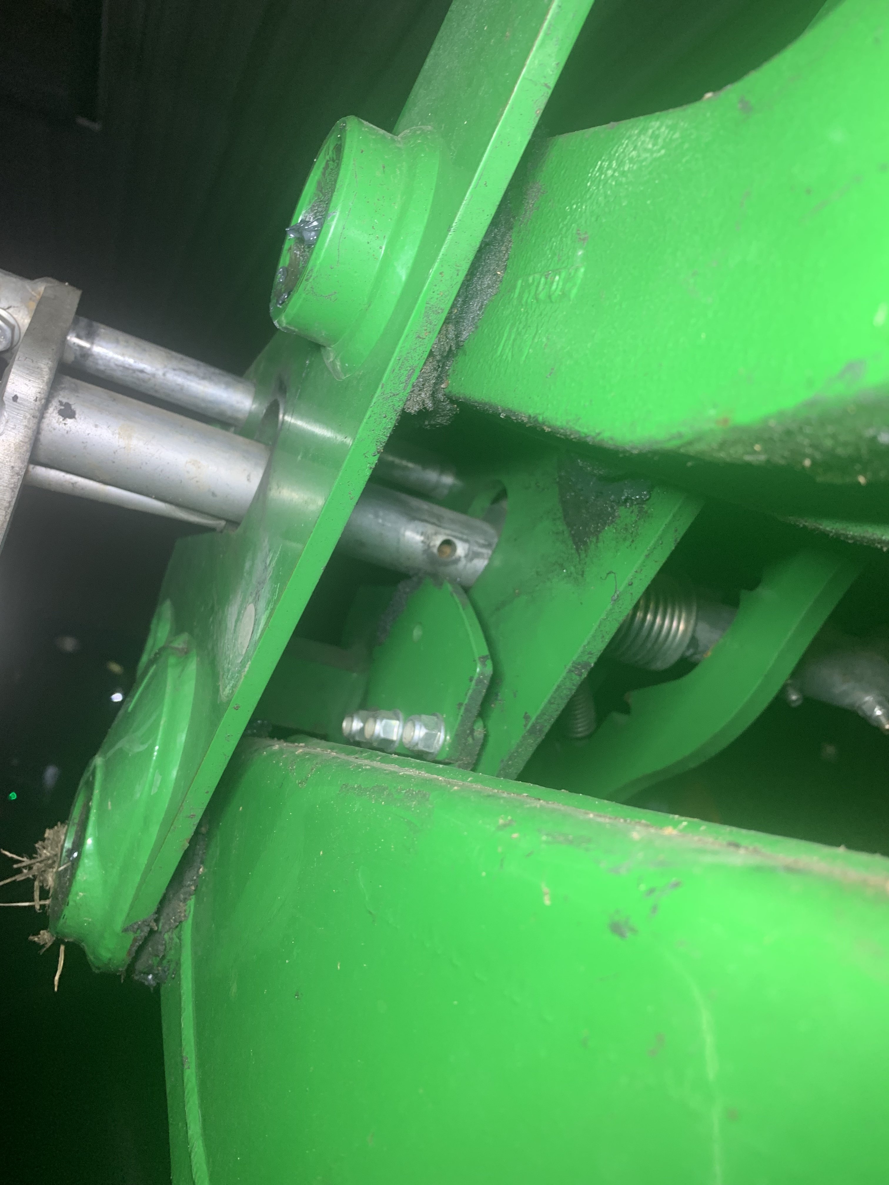

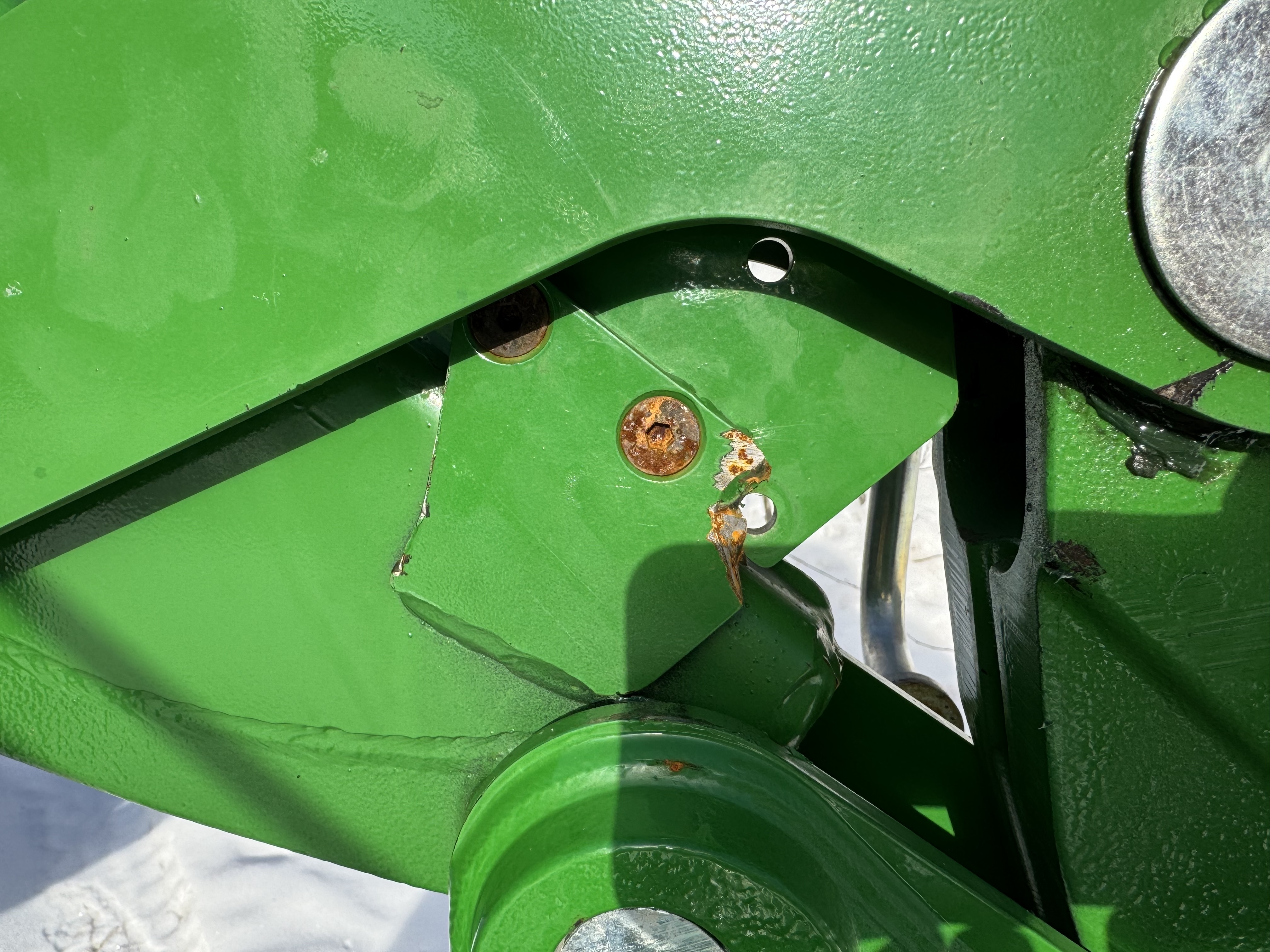

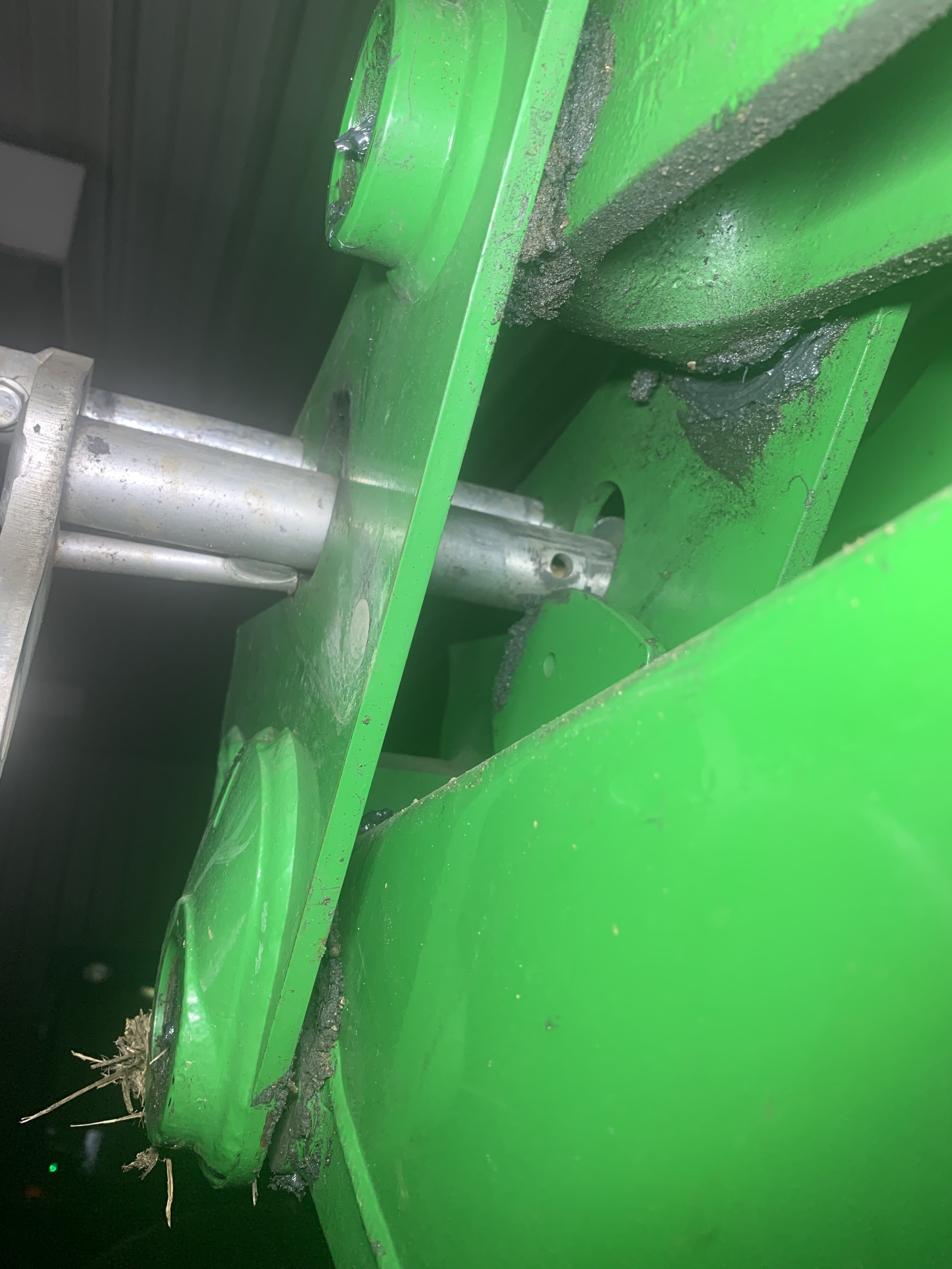

It does not automatically lock with just the loader. Looking at it in the fully curled position without any attachments there is about 1/8” gap between the bump plate and spring pin. When I add the bucket that gap disappears but it’s not enough to force it to bump, I think the weight and vibration of the bucket is enough to release it but not so when using the forks and definitely not when empty.
i attached some pictures even if they’re hard to see. I noticed the loader mounting plate that’s welded on is sheared and missing the third bolt hole. I’m not certain that’s contributing to the issue though? The hole pattern on the bolted on plate does not appear to have any adjustment ability. Do I have the wrong bolted on plate or something? I am stumped.

Comparing pictures it sure looks like either my bolt on plate is too small or the welded on mounting plate is welded too low on the loader?
