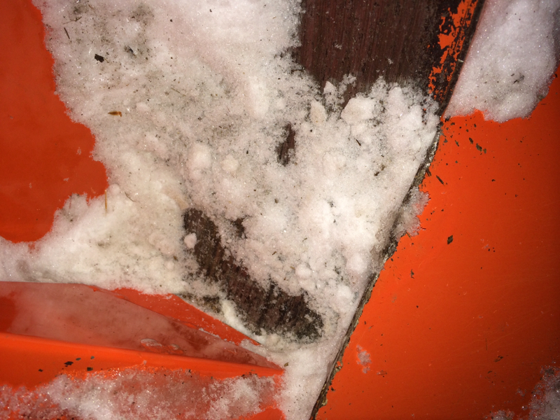

I've just spent the last couple of hours removing the blower and installing the loader on my BX 25 in the middle of a foot and a half of snow in the dark at 5 degrees. I was using the blower on the light powdery snow when the fan stopped turning. The augers are fine. The shear bolt is broken but all the pieces were still in place. But the fan is completely jammed and will not turn even though I disabled the mid pto. I can't see anything stuck in there and I know I didn't hit anything. Really frustrating since the storm is only half over and the worst is still to come. I think this is the final straw for this blower. It just keeps letting me down and with a blower when you need it you need it now. Luckily the loader never fails.

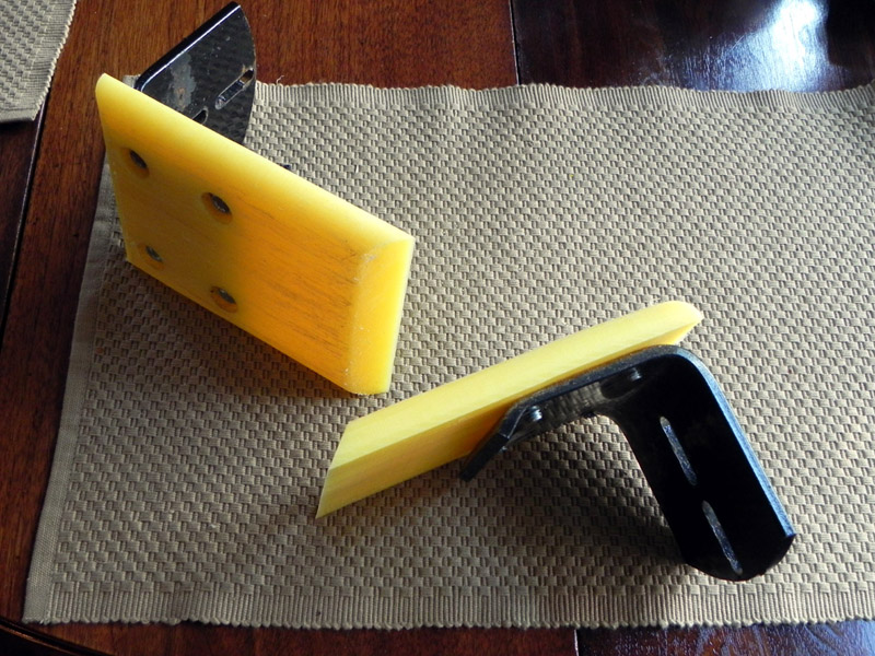

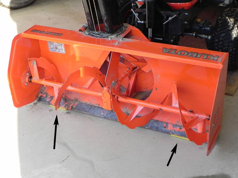

Bob, when my new BX25 and BX2750D were going out to blow snow for the very first time I started off at maybe 2000 rpm. I went about 15 feet and sheared a fan bolt. So I changed it and in doing so I let the old shank drop into the bottom of the shroud. Well, I got back on the tractor, started her up, and engaged the pto. Thunk. The fan stopped dead; it never got spinning. WTF? And now the fan was locked and would not turn. I know how frustrated you can feel about your 2750D. After looking around a bit, I found the old shank jammed between the end of a fan blade and the shroud. So I blew a total of 15 feet and was on my third bolt! In the end I sheared 6 fan bolts that first winter.
This is an awesome snow removal tool. It will move tons of snow; I blew for 2 hours today. You just need to learn its idiosyncrasies and hang in there. A couple of things I did that helped me was to start running at WOT and I made some new skids which actually extend beyond the cutting edge. Since doing these 2 things I have reduced my fan bolt breakage to maybe one a year (1 auger bolt so far this year).
So don't give up on that blower!

Well Dean you are pretty much right on the money, except it's not a piece of the shear bolt. In fact, I'm not too sure what it is, maybe a piece of rock? It's almost the same color as the housing so it's real hard to see. Looks like it's about an eighth inch thick and man is it wedged in there. It's visible from both sides so there is no obvious direction to turn it. I pounded pretty good on the blades trying to get them to turn but no dice. Any suggestions? Here's a picture of what I'm talking about.

The first thing I'd do is melt that snow away to see what you're dealing with. You can't figure a course of action until you know what it is. You can use hot water or a torch maybe. If it's a rock maybe you can break it up. But you need to see what it is to figure out how to deal with it.

get a hand torch and heat away the snow/ice. Looks like a rock has wedged tight in there.
I agree with Dean. Melt the snow away with some hot water. I doubt it will take much to clear it away, then you can see what you're doing.

Yeah, melt it then move it. What comes to mind is not beating on the blades, but breaking up what's jamming them. I think you could use an air driven chisel to break the jam quickly then back to plowing! JMHO. :thumbsup:

Ahhhh! An excuse to go buy a tool I don't already have! I like it! It's supposed to warm up in a couple of days so I'll melt it out then but I'm pretty sure it's a rock the more I think about it. I like the idea of going at the object and not the blades. I'll give that a try.

Yeah, now you're thinking! An air driven chisel is not an expensive item, and with a few good chisels you can get a lot of impact right where you want it. Think of it this way, whatever got jammed is now wedged in place, your objective is to unwedge the object, not your fan. If you can pulverize the object the fan spins, and then you are back in biz.:dance1:
