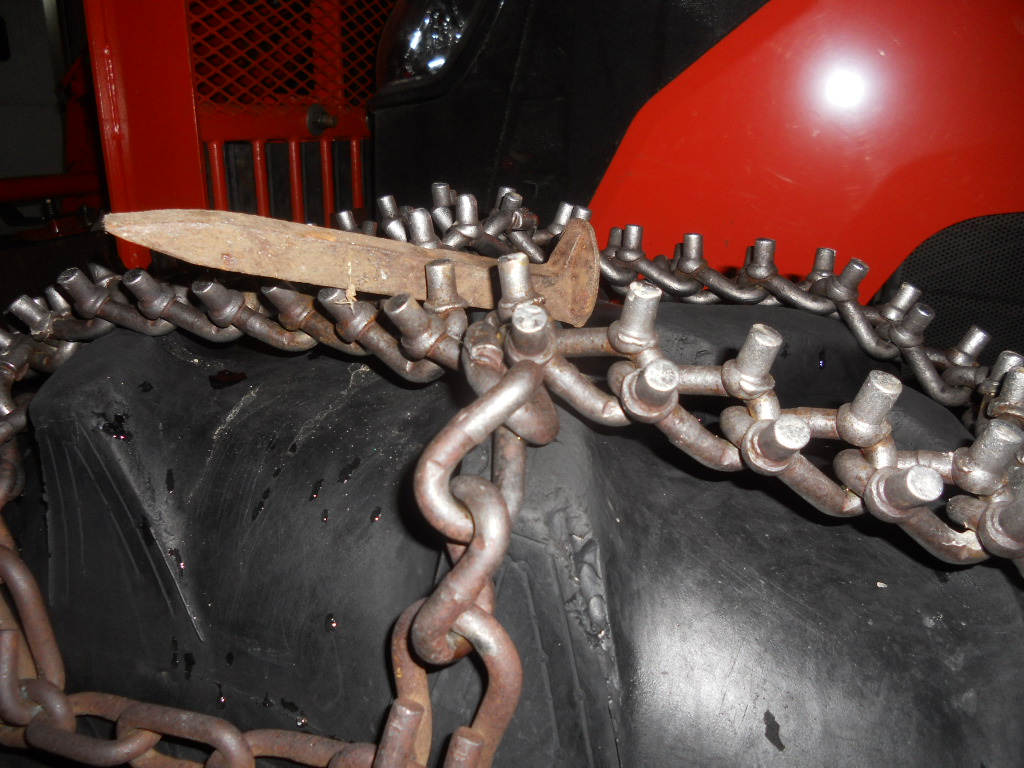

I think in your situation, I would up grade your chains to a studded "Trygg" ice chains, front & back. You'll swear they're "ice magnets", but prolly 2x the cost of other types. Those studs are carbide. 12.4 x 36 - 3/8" Studded Farm, Grader, and Loader Chains - 603904
My friend does a lot of plowing with his tractor commercially, he usually has a heavy "box blade" on the back for weight and pulling snow away from buildings. We've been hashing around the idea of mounting a hyd. winch to it for self extraction. A 8000# Ramsey planetary hyd. winch can be had for about $1300. I have one for another application and it's a good winch.
IMHO you usually want winch yourself back to where you were (not stuck) :D and you rear remote's are right there, it would be fairly simple to attach it to with plenty of heavy "structure" already built into a box blade. I would want the winch already on the tractor, ready to go. Like you said, it's a long walk back to the barn, and I would suggest that 99% of the time (snow plowing) you'll want to pull it backwards.
   / Getting Your Kubota Out of Mud / Snow While Working Alone #44
The trygg chains would work well but the issue would be does he have inner fender clearance for the carbide studs???
