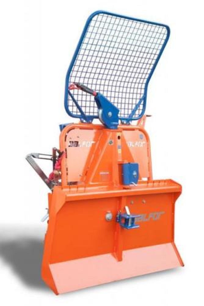

The best would seem to be a 3pt skidder winch but the cost is high and I'm usually using another implement like a snow thrower or rear blade.

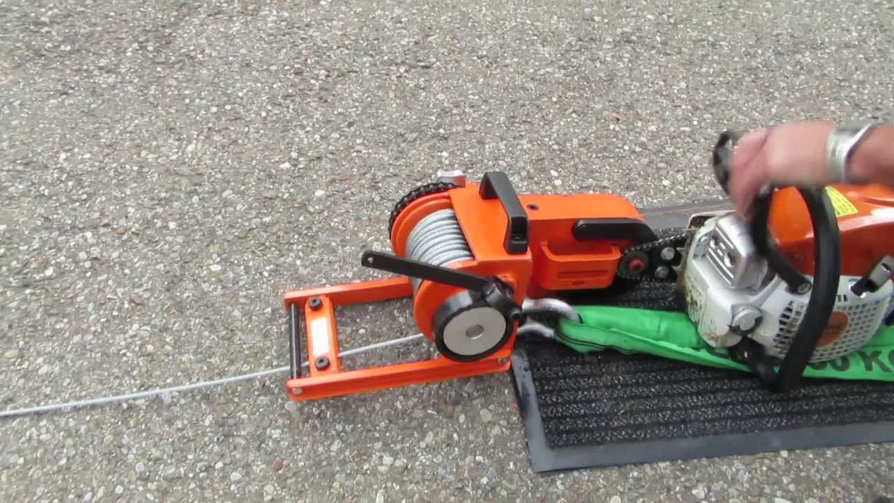

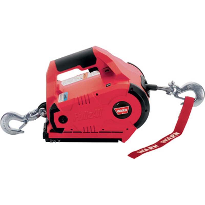

Portable electric or gas powered winches that can be carried onboard are a possibility but Aren't as powerful and require being out of the tractor seat to operate.

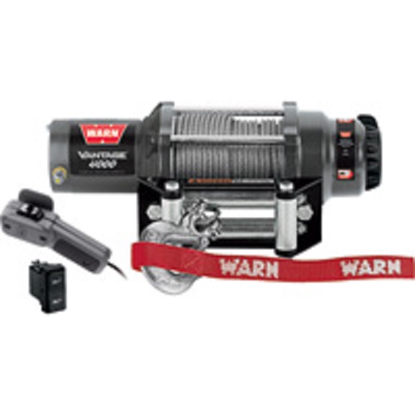

Jeep / ATV frame mount winches would seem to be a possibility. When mounted to the front tractor frame, it would not interfere with either FEL or 3 pt implements. The effectiveness of these winches would be limited by the rather small battery capacity of most compact tractors but the remote control feature would allow you to be in the seat using tractor power to assist.

The only way I would use a bucket mounted winch would be to pull the tractor straight forward. Putting a lot of side pressure on the FEL is asking for trouble. I was thinking of "hanging" the winch on the front tractor frame with the FEL bucket raised out of the way.
