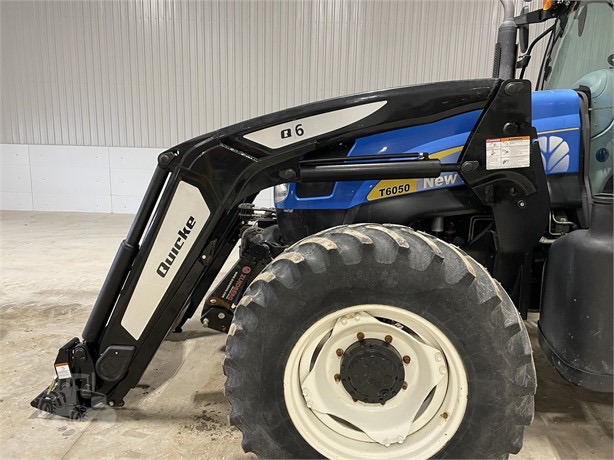

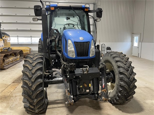

Here’s one I bet most of you haven’t seen:
Studded R-1’s !
This New Holland T6050 was used for snow blowing up in the Great White North
I’d like to buy it, but not a big fan of open center hydraulics.
Comes with brand new Quicke Q6

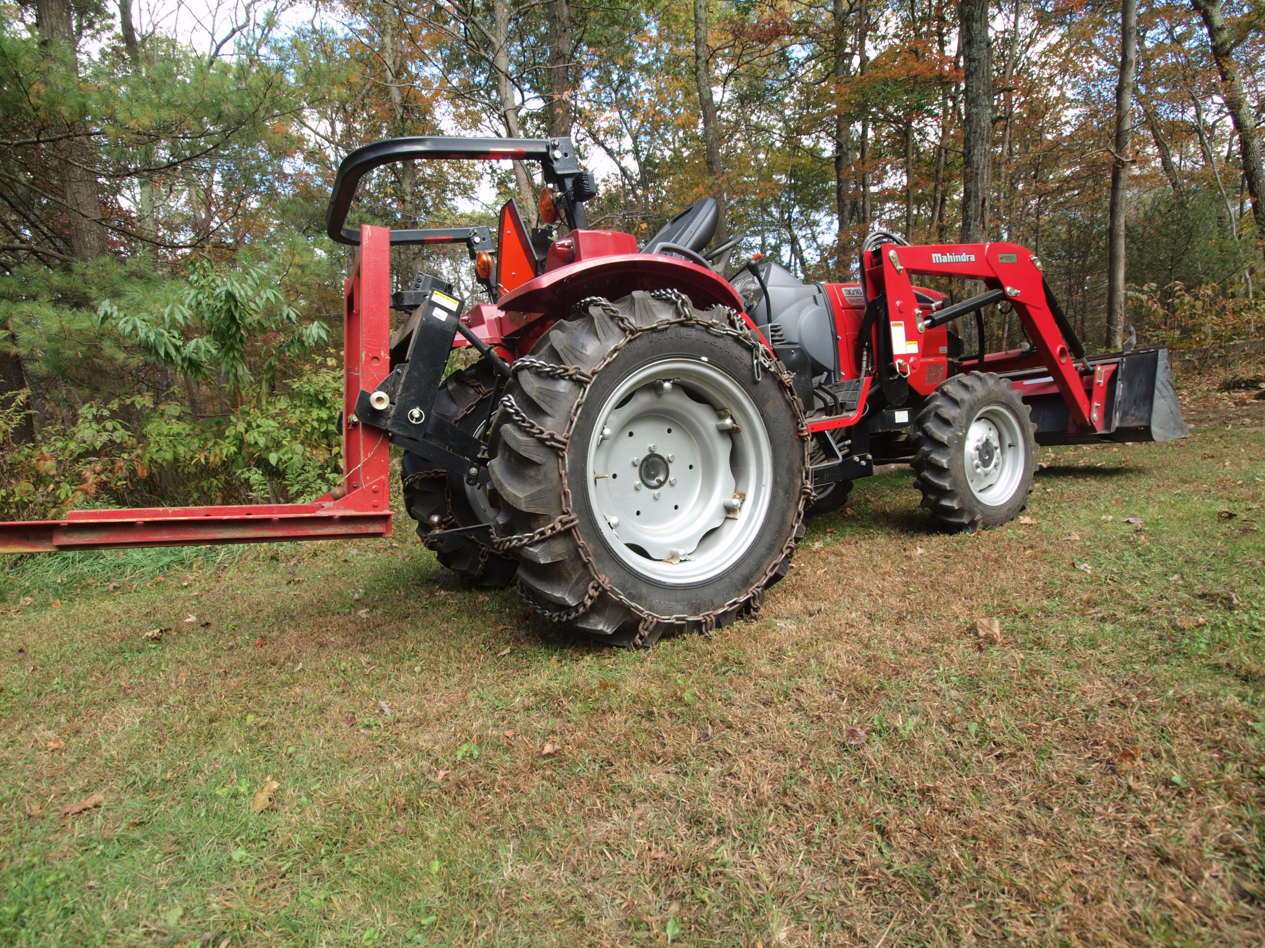

Let me bust another myth here. You do not have to get specialized chains for ags. Ladder chains will do just fine. they look like they're falling between lugs but in reality, that's only at the top of the tire.
At the bottom, they're falling "out" of the lugs and are the first thing to contact surface. Just don't sock up your chains too tight.
I've been using ladder chains on my ags for years and they appreciably enhance traction plus they're only 4 link.
Whether in the woods skidding logs or plowing snow, they have been a big help.
Ladders on all fours (get 2 link for fronts) and the tractor becomes almost unstoppable.
Are they end all type of chain? Nope. But they get the job done.

Sorry but you are wrong!!!!!!!
Any chain is a good improvement over bare rubber of any kind.
However I have used most every style of tractor tire chain.
From 4 link spaced double ring chains to two link spaced alternating double ring and v bar reinforced, too two link spaced street and ice lugged chains, various dou grip or H patterned.
None of them will come even close to the studded Euro patterned tire chains;
the OFA's, the TRYGG's, the Aquiline Talon's.
The traction and ride quality are unmatched of these chains.
