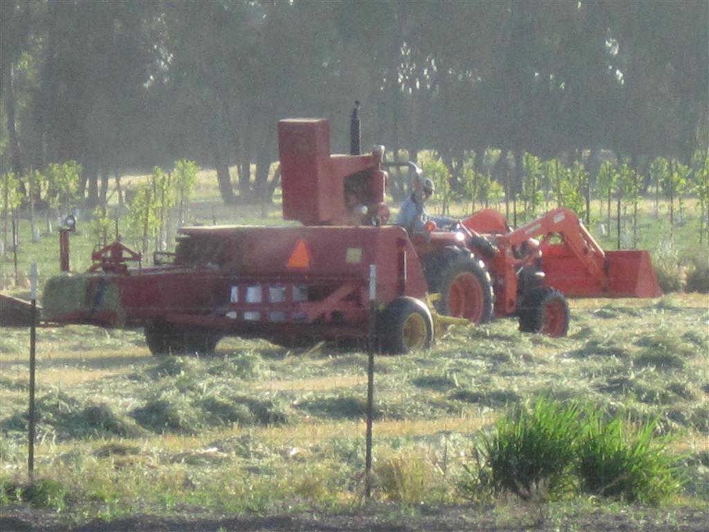

Hello,
I'm interested in getting started in square bale production. Small square bales around 50 lbs.
Currently I have a Kubota L3830 with loader. Also have a 1953 Ford Golden Jubilee.
Basically I need advice on picking good quality used equipment. Cost for this project is a big factor. I want best quality as well. So over the last 50 years which balers, cutting bars, etc were the best.
I will need a mower. Should it be a sickle or disc type? What brand is best?
I will need a rake... I'm familiar with the trail type New Hollands. Any other suggestions?
Baler.... Need one of those too.... I've heard New Holland and John Deere are the best for square balers. Which models are the best?
Bale collector... I really want to automate process of picking up and stacking bales. Anyone using collectors?
Thank you for any advise.

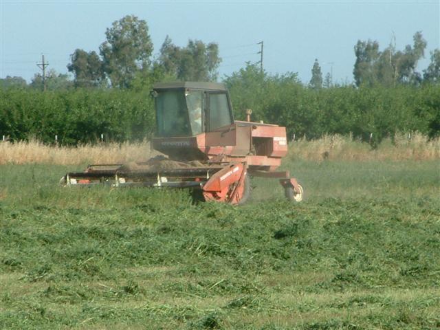

Mowing is done with his partner's Hesston windrower.
He bales with a New Holland 3-twine baler (100 lb bales) that has an on-board engine so he doesn't need to run the baler with the Kubota's pto.

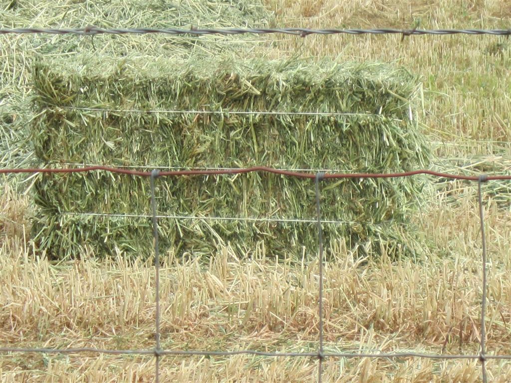

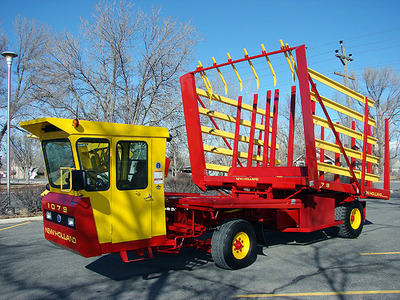

He rounds up the bales (generally 400-430 bales) using a self-propelled New Holland bale stacker that belongs to one of his high school buddies.

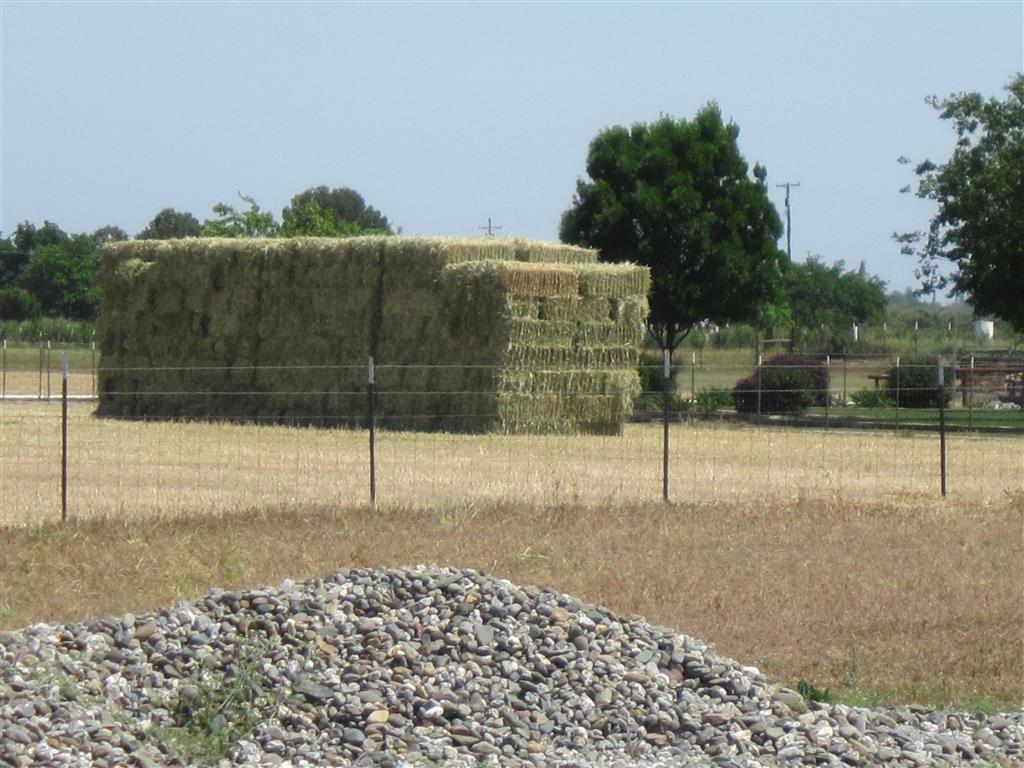

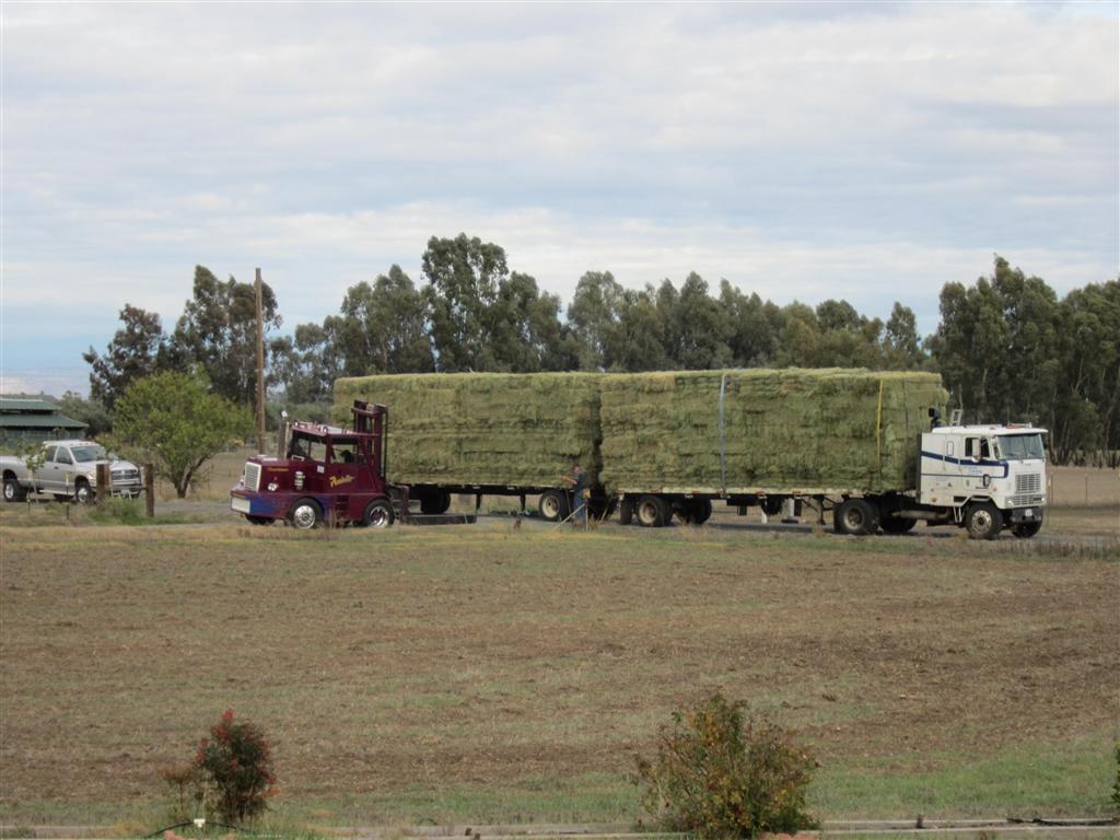

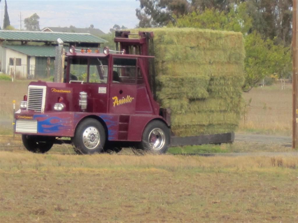

He loads the bale stacks using a bale squeeze that another buddy owns.
Last season he sold his crop to one buyer at $14/bale.
