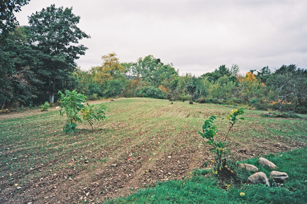

Please note that I do not have any Degrees signifying my competencies but I could furnish pictures of my "Garden by the Driveway" established in an area which was hard to mow and therefore converted to other uses. This was heavy rocky clay soil amended by seaweed, chicken manure and sawdust.
Picture attached of rotatilled sod with a subsaquent winter rye crop.

Subsaquent winter rye. Did you seed the rye egon or is it just "volunteer"? Different farms here use peas or different annual type ryes to help amend the soil.

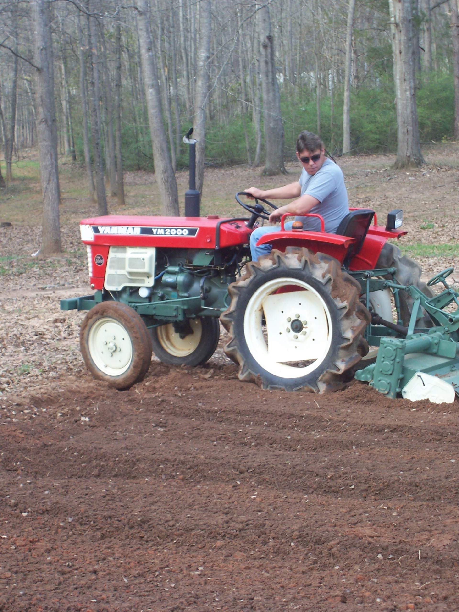

Just curious if you guys might think that I may have gotten alittle carried away with the tiller.This is the first year I have used a 3 PH tiller on my mothers garden.The old sears walk behind has proved to much do to an injury.I will have to admit that the early planted crops seems to be doing noticeably better than in the past.
That would seem to be answerer for your question. :D
I seeded the winter rye. Broadcast by hand and harrowed with a home built contraption that actually works well for this application.:D
The Deer Like me.:D

Thanks egon Looks good. Deer do like rye!!!:D

Nice set up, carey063. Looks all ready to plant.
Do you use the hamburger as an armrest 8^) ?
