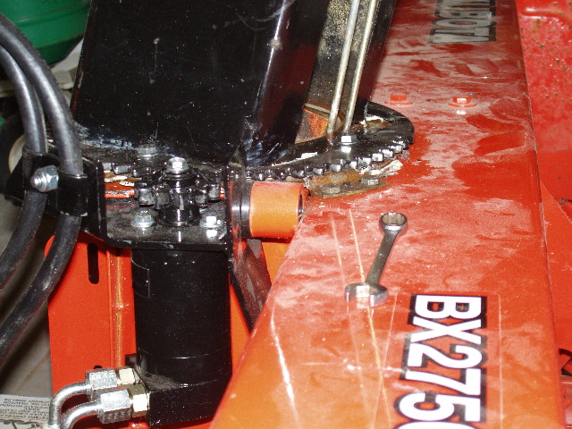

Mine IS a BX2750 blower. I had a hand crank the past 3 winters and it was fine but the new handle bearing for the 50 series is a joke and I did not want electric on the rotator so now that Kubota has the hydraulic kit I opted for that. It is a bit pricey but so is my time to source everything to rig something up. The kit has a heavy ring and pinion gear. The wire worm would not take the stress of a hydraulic motor very long.
/ Getting ready for Winter? #28
Could you please post some pictures of the new ring and pinion hydraulic set up? Thanks
I hope the detail is ok. All the parts are black.

/ Getting ready for Winter? #30
That looks pretty slick. Have you used it yet? My neighbor has a John Deere tractor with a blower. His rotator has a linear hydraulic cylinder that tugs back and forth on a cable that wraps around the chute. A very clever setup. If I were a clever person I would figure out how to rig a similiar setup on my machine.

/ Getting ready for Winter? #33
Not yet other than to test it. It seems to work well.
