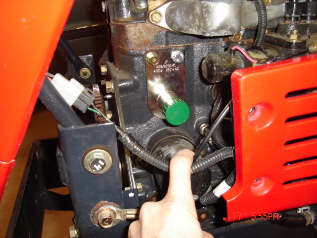

Scott, I got one for my 2310 a couple years back... it was pricey and I don't use it real often, but the install went very well --it fit beautifully-- and it sure is nice to have it when it's really cold!
Here's a tip- during the summer when it's not used, you can remove the electric feed from the heater and cover the opening with a standard garden hose cap- same size and thread. That helps to keep the electric cord/plug from getting damaged and keeps the heater connections clean. (I'm assuming your block htr is the same, of course.) Just be sure to remember where you put the electric cord...:laughing:

Great tip-I'll be doing this in the spring.

irvingj, thanks for the tip about removing the MF engine block heater cord. Mine has been dangling all summer, and I wondered if there was a better way.
I've used my heater a few times already, and it seems to warm up that area nicely, and fast. Veteran tractor guys, please share your thoughts on how much engine idle time is needed if you've already warmed it up with a block heater. I see the comment about turning up the RPMs from idle before moving out. Does that still apply if the engine has been warmed with a heater?
