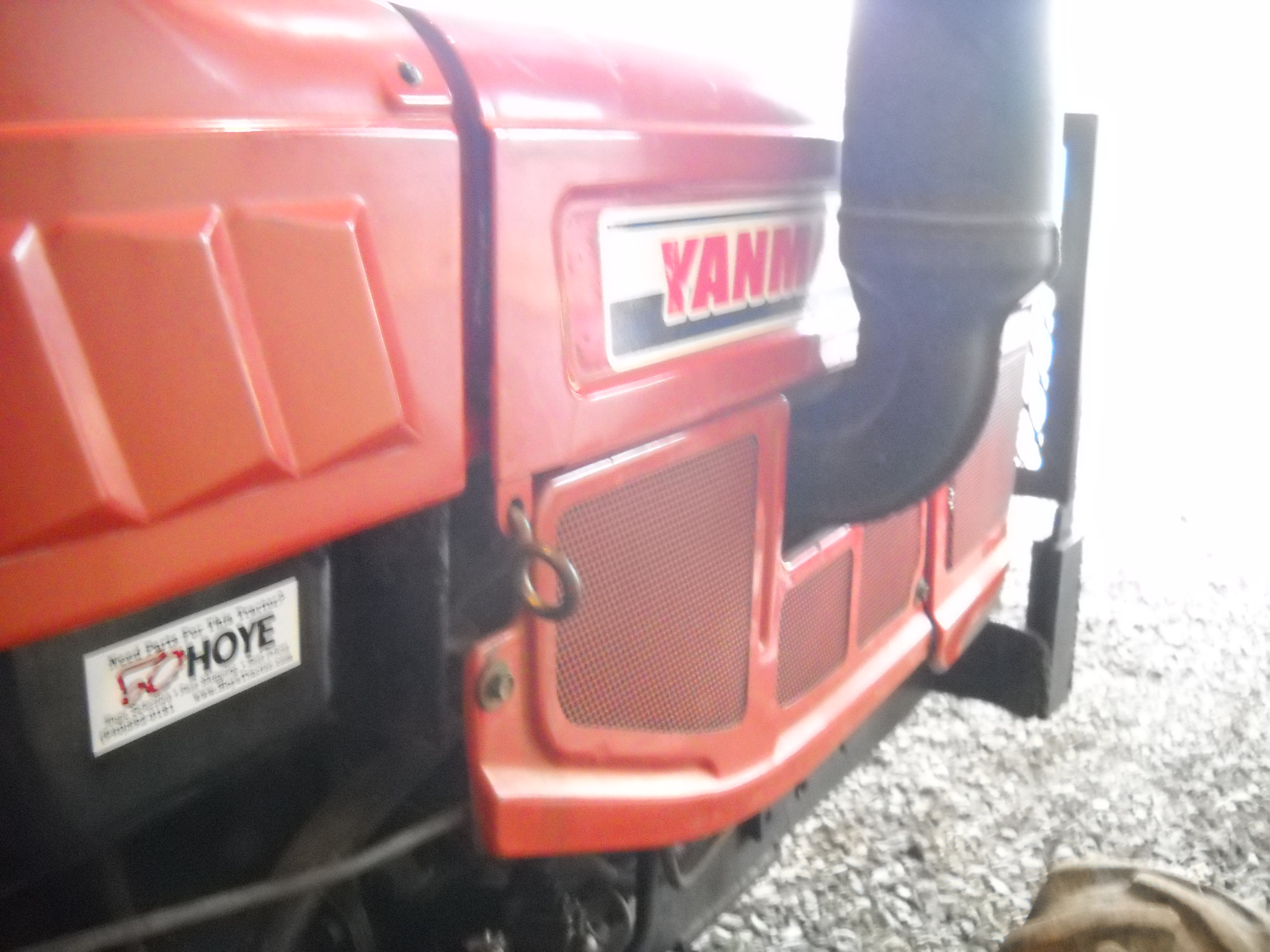

Well on Saturday it was raining, what a shock, we have had rain for 21 days straight so far. :eek: Anyways, I decided it was a good time to replace the hour meter cable in my YM169D that I ordered from Hoye several months ago. I Also needed to charge the battery and fix the fuel gauge problem. So i first took all the bolts out that hold the dash panel on and got a space between the sheet metal and the fuel tank that i could reach my arm in. Tried to unscrew the hour meter cable and it was a good battle, but it came off with some grunt. I wish I could have just taken the dash off, but After taking the nut off that holds the steering well on i couldn't get it off, even tapped on it with the rubber mallet and no success. After getting the end off, i took a look at my fuel gauge deal on top of the fuel tank. Cleaned off some of the dirt and turned the key, what do ya know, it works, just was dirty. :thumbsup: Next up was the other end of the cable. Talk about a hard location to unscrew a cable, you can see it just fine, getting your hand or in my case pliers in there and turning them to unscrew it is very difficult. After finally removing the cable, i grabbed my new one and lined it up so the slot in the end fit snug on the business end of the cable. Tightened it down and tightened down the other end. Once everything was hooked up I bolted the dash panel back on and started at the battery. It is a new Interstate battery, originally got it for my Simplicity 9518 but swapped it out with my YM169D since I needed the extra umph the new battery offered. Since it was now dead, i couldnt figure out why. But when I hooked up the charger, i found out i had put the battery on backwards. :ashamed::( Not a good thing, so I unhooked it and let it charge overnight. By morning it was fully charged again, hooked it back up the right way this time and my tractor fired right up. Now it starts better, the RPM and hour meter have came back to life, and the fuel gauge works. This is not the end, I still have a head light out, would like to add more lights and orange turn signals, get a cover for the fuse box, get the shift pattern decal, and a few other minor things before i call it anywhere from completely fixed up.

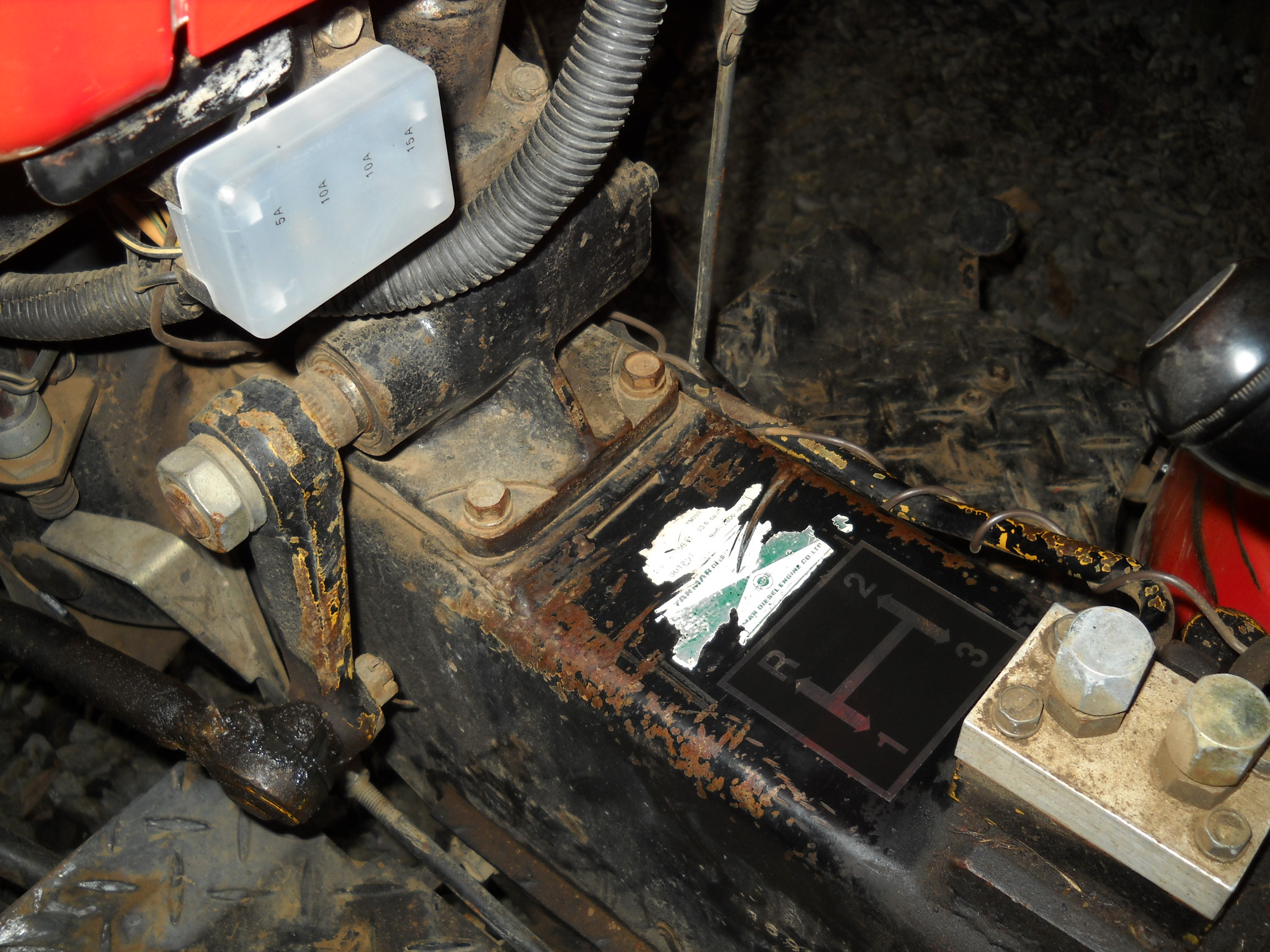

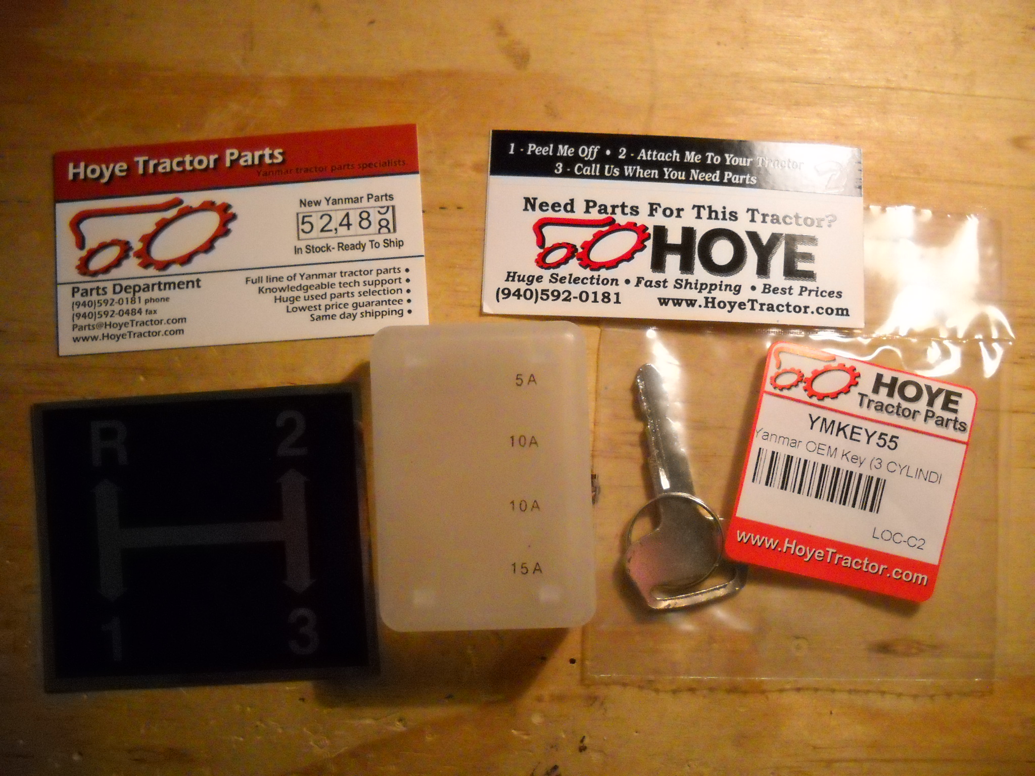

Well, I just ordered a shift pattern decal, fuse box cover, and and extra key from Hoye today. :thumbsup: I feel like I am spoiling my tractor now.:laughing:
/ Getting my YM169D fixed up

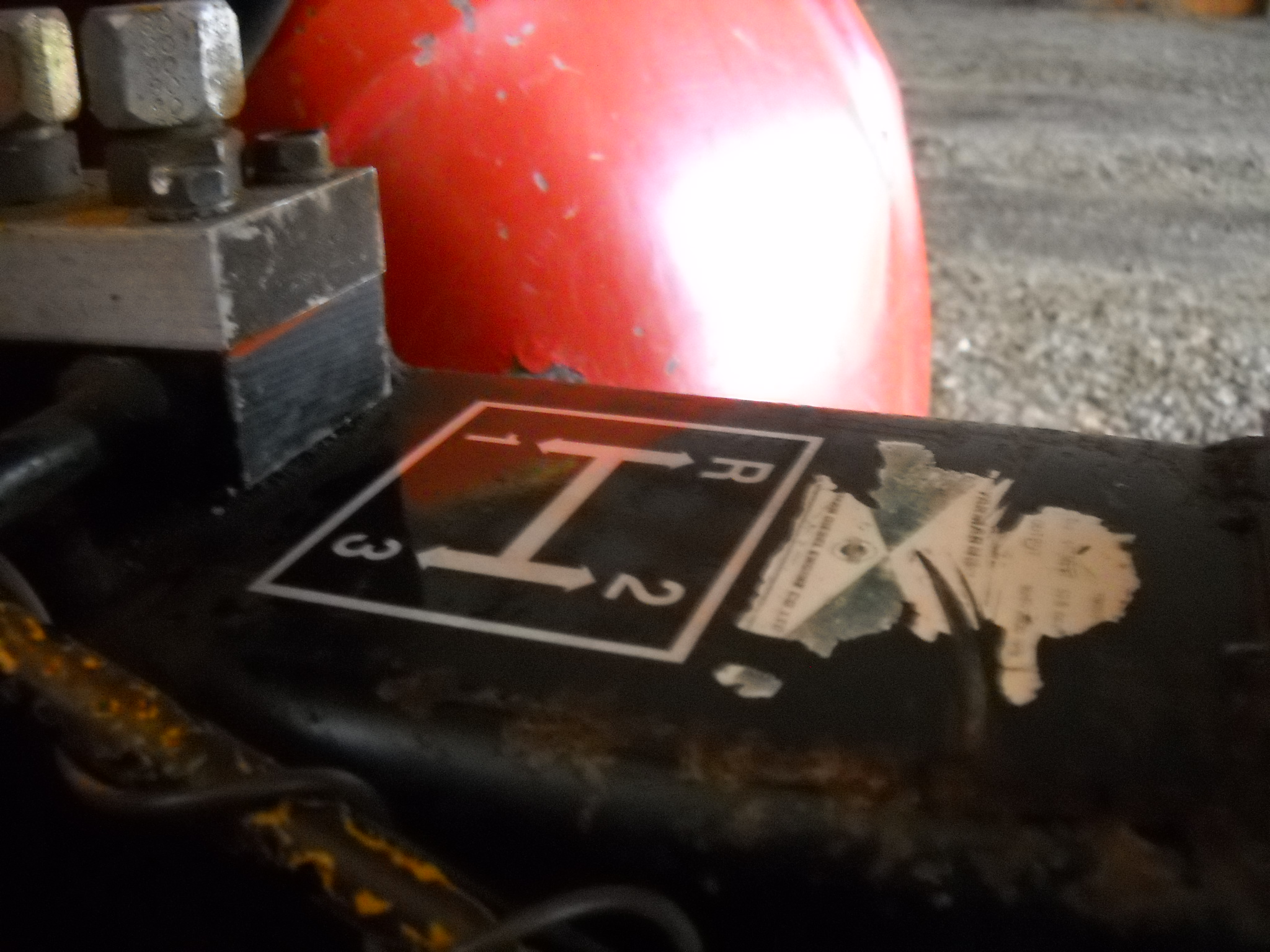

My parts came in yesterday and i got to put them on my 169d. The shift pattern decal is a very nice thing to have, especially if i had someone use my tractor, now they can figure out what the shift pattern is. :thumbsup: The fuse box cover looks very good on the fuse box and should do a good job on keeping the fuses protected and out of harms way when I operate in the brush. The extra key will be nice as a back up key as well.:thumbsup: And the finishing touch, I now have the Hoye sticker on both sides of the fuel tank. :thumbsup: Thanks Hoye! :thumbsup:

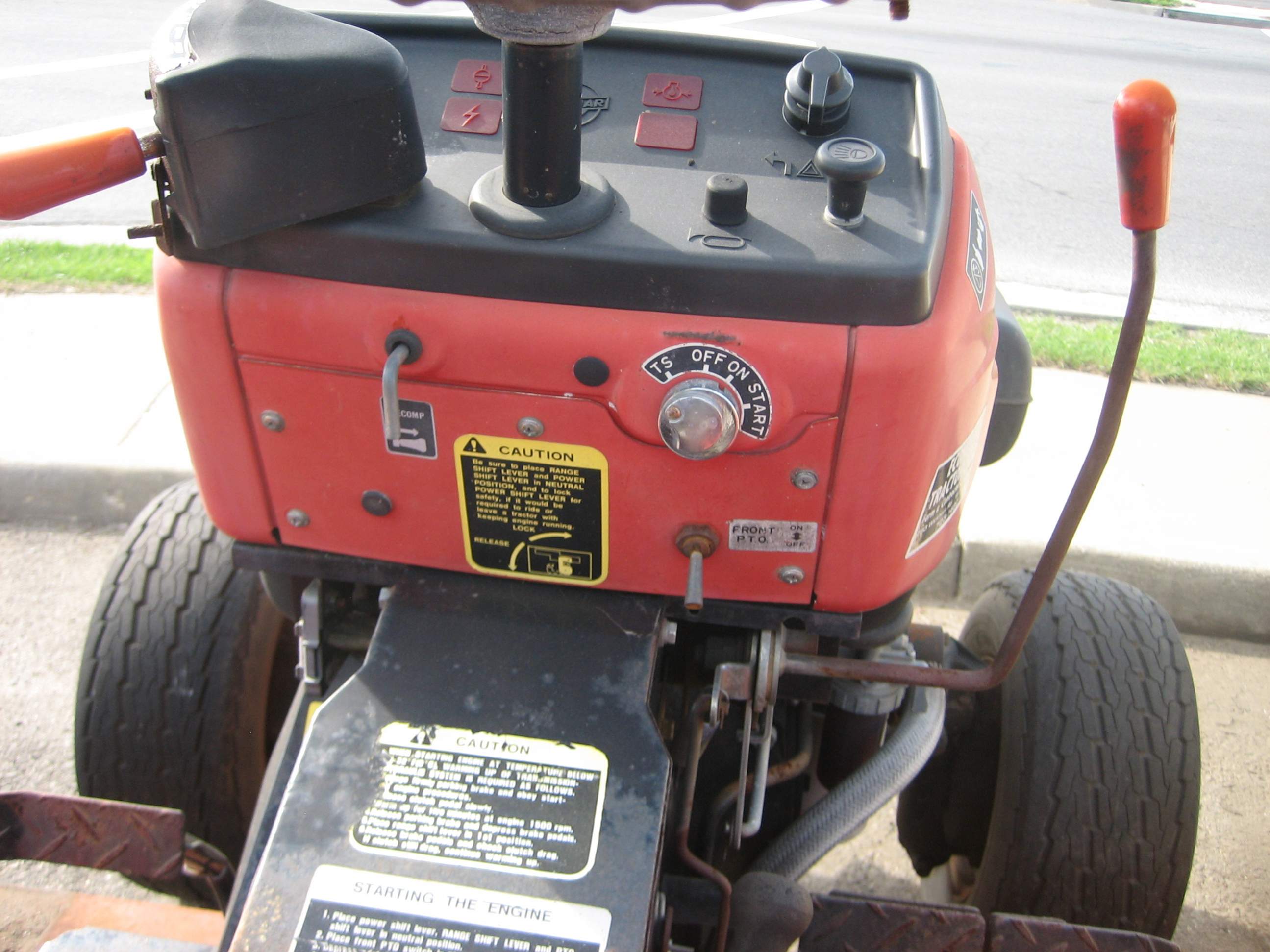

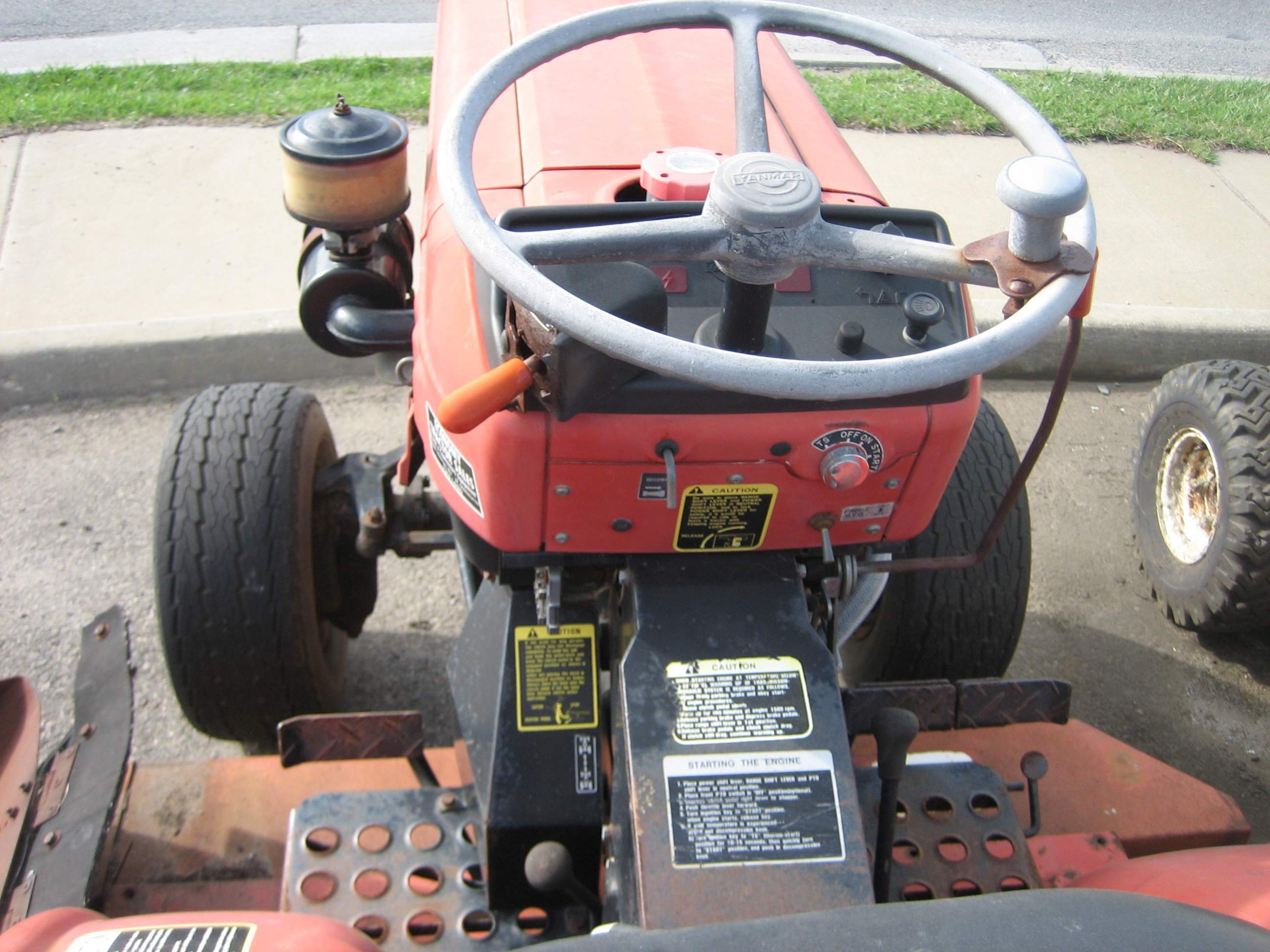

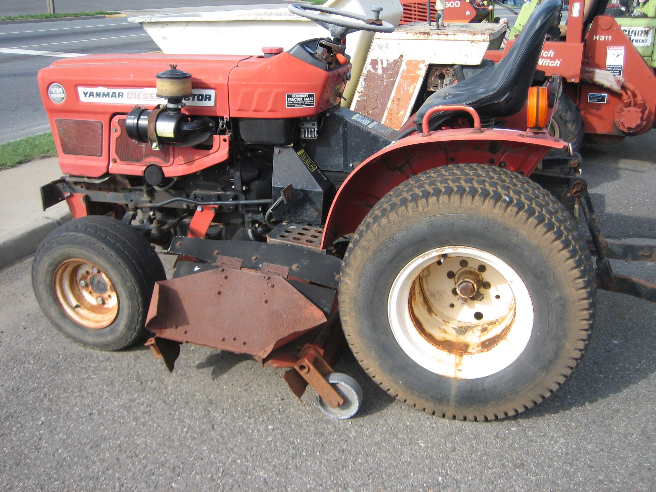

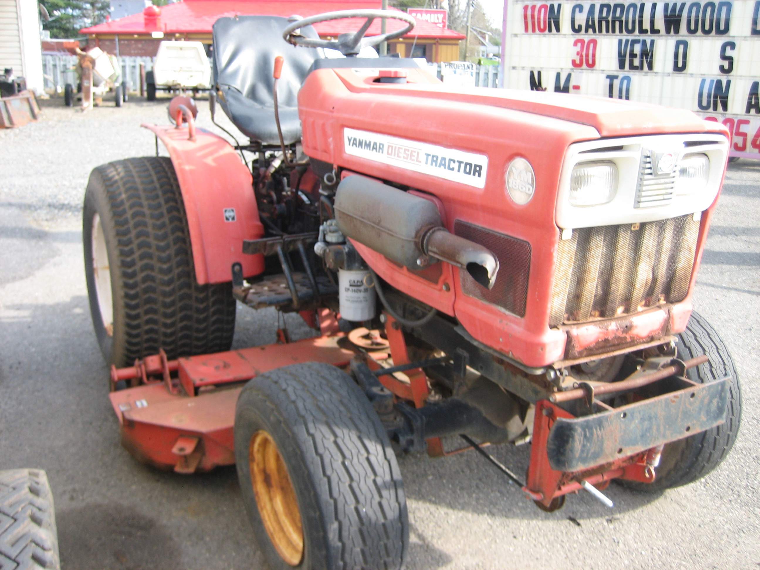

Jerrybob. Not trying to take over the thread but here are some photos of a 186d i have had my eyes on a couple years. It is neat because the powershift is on the dash and it has turf tires and a mmm. Any idea on the difference in powershift on the dash and down below.
I thought they were always on the dash. I have looked at a few 186 and 187's and really like the powershift. If i had the $$$ i would even consider adding one to my fleet. :laughing::D:cool::thumbsup:

Interesting......never knew they made a 186D with shift on the dash. My tractor shifter is down below and the powershift is great! I also have the service and parts manuals from Hoye.......no mention on the 186 or 186D of a shifter on the dash??? Personally......I've never seen one on the dash. As for the 186D.....I really like that little tractor.......runs great.....does everything I need it to do. As for seat time.......did some gravel work for a neighbor about two weeks ago and had to take down three trees here on our property. That little tractor performed well in both tasks. I've thought about a backhoe someday......not sure if I'll get there at this point. Hope both of you have many happy tractor days in the future!
/ Getting my YM169D fixed up #15
Interesting Pete........I've never seen the dash mounted shifter. Do you know if that was an option or year specific? Like I mentioned......my 186D service and parts manuals don't seem to mention the dash mounted shifter. Also......I see you're a Pacific North Westerner.....so am I.....that 4 wheel drive sure comes in handy with the rain and mud. Happy tractoring!
/ Getting my YM169D fixed up #16
If I recall correctly, the YM186(D) floor shift model was only manufactured from January thru June of 1980. Then Yanmar changed and put the PowerShift lever on the dash.
The same was true for the YM336(D) also. It is the floor shift models that are somewhat rare. The floor shift models were sold until inventory ran out; early to mid 1981 for the 186 and late 1981 for the 336.
/ Getting my YM169D fixed up #17
Thanks Gary......I did not know that about the different shift models. Being that the floor shift was made for such a short period of time......I wonder why my service and parts manuals do not refer to the dash shift?????? Thanks again for the history information.
/ Getting my YM169D fixed up #18
I found it weird that the sales picture clearly shows it on the dash as well as the opps manual. But the service man. only shows the one down low. Jerry where in SSW are you located, I am in Elma.
/ Getting my YM169D fixed up #19
Hope your regulator and alternator wern't fried by the backwards battery. Also make sure you get the leaky rear fixed. You will rust that rim out. When you dismount it make sure you or the shop wash it with soapy water to get the calcium off. Im sure you know this though.
/ Getting my YM169D fixed up #20
It amazing what you find when you turn the page.......my parts manual does have both shifters (dash and floor) listed with diagrams.....sorry for the error.
