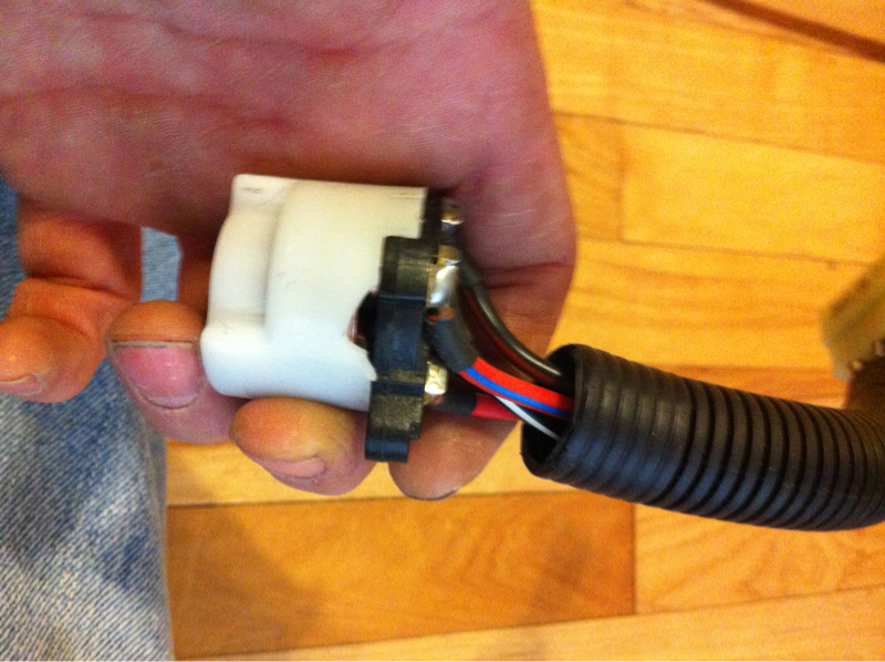

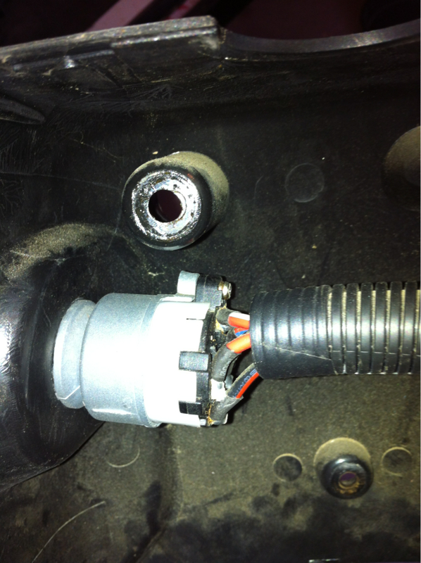

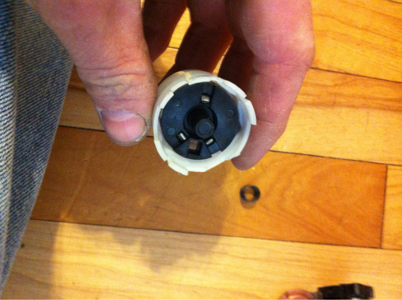

So I put the new one in started right so I went over to pull out more wood . Then I shut the tractor off to use the chainsaw then loaded the wood in the bucket then went start and again nothing I had to take it a part to clean and put it back together to start the tractor. I 'm going to call the dealer to see when the update ignition switches are coming.

So I put the new one in started right so I went over to pull out more wood . Then I shut the tractor off to use the chainsaw then loaded the wood in the bucket then went start and again nothing I had to take it a part to clean and put it back together to start the tractor...
lande ... there must be something else going on here other than just the switch. A new switch can't go bad in such a short time. Maybe juggling the wires to work on the switch restores a break in the wires, or something. A Diesel will run just fine regardless of the electrical system (except for the stop solenoid) so it's quite possible that the problem in your start system returned seconds after starting the engine.
When I opened up the new one the copper had greenish tint on it. I do think there is something else I talk to a dealer that are still waiting for the updated switches. When they get them from kioti they will come and install it and test everything else.
Did they send you a new switch or an old one they took out of somebody elses tractor? That doesn't sound like a new part to me.
Good point, sounds fishy to me. Is a Kioti dealer that bad of a company to send old parts to a person? And a new part fail that quickly? Plot thickens.
Do you leave the tractor outside uncovered exposed to the elements? Use some dielectric grease on the contacts keeps the water out and them from turning green. https://www.google.com/search?q=electrical+grease&ie=utf-8&oe=utf-8&aq=t&rls=org.mozilla:en-US:eek:fficial&client=firefox-a#hl=en&sugexp=les%3B&gs_rn=1&gs_ri=serp&gs_mss=delectrical%20grease&pq=electrical%20grease&cp=2&gs_id=1m&xhr=t&q=dielectric+grease&es_nrs=true&pf=p&client=firefox-a&hs=ip2&tbo=d&rls=org.mozilla:en-US%3Aofficial&sclient=psy-ab&oq=dielectrical+grease&gs_l=&pbx=1&bav=on.2,or.r_gc.r_pw.r_qf.&bvm=bv.41642243,d.aWM&fp=cb613fd398c77cdc&biw=1024&bih=638
Odd the switches don't have the dielectric in them already. Use a large piece of heat shrink tubing and hermetically seal the switch too.

I think they took one out of a tractor on the lot because kioti corp hasn't sent the updated switches it was in hopes to get me by why I wait for the updated one.
