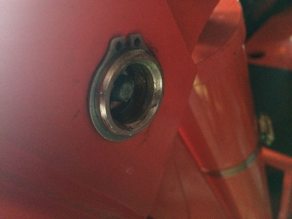

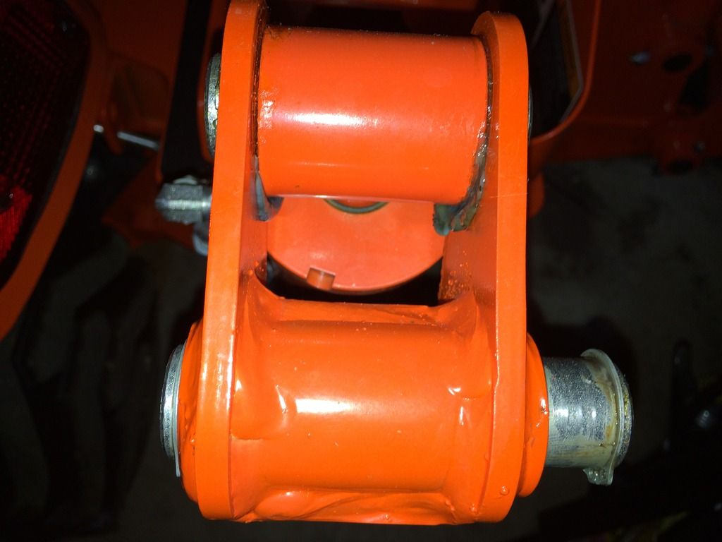

Problem solved!!!!!!
The easiest and safest way is to remove the pin that holds the pad on the outrigger. With one pad off, I measured just under 47". That should get my in the gate. If it looks too tight, I'll just take the other pad off. I think it's going to take around one minute, to get them both off and back on. That's acceptable, to me. Risk is around zero.

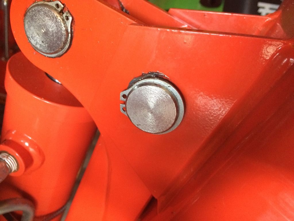

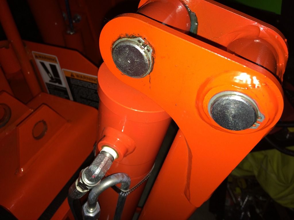

Each side has a snap ring on it. It looks like this:
Backhoe Side:
Tractor Side:

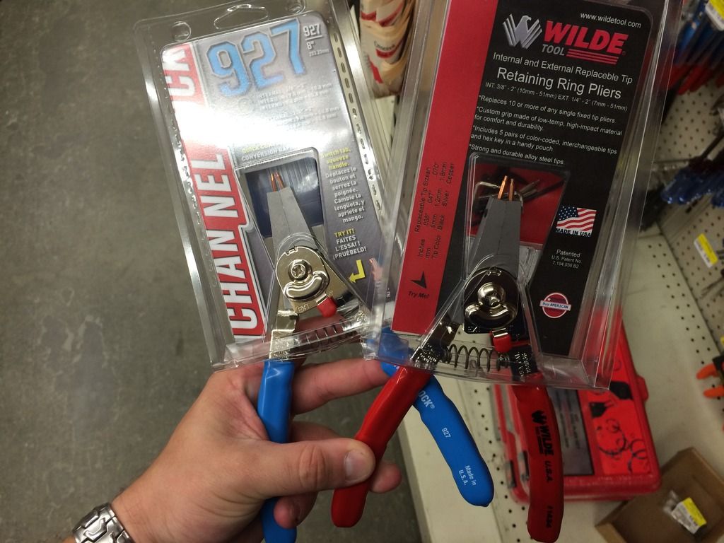

I bought this Channellock tool, to remove the clip, very simple to use. For those wondering, the Wilde #1434 is the exact same tool as the Channellock 927. The only differences are the red handles versus the blue and the small red bag versus the blue (for the extra tips). Oh, the other difference is the label. The Patent number is the same. I try to buy stuff made by Wilde, as it's not made far from my house.
I went with the Channellocks, they were $23.99 versus the Wilde branded one at $24.99. No sense trying to match tools. My slip joint pliers are Wilde and my welpers are Channellock. Other tools are Menards brand (Used to be known as Allen). I'm on a slow crusade to replace my cheap/low quality tools with tools made in USA, as much as possible.

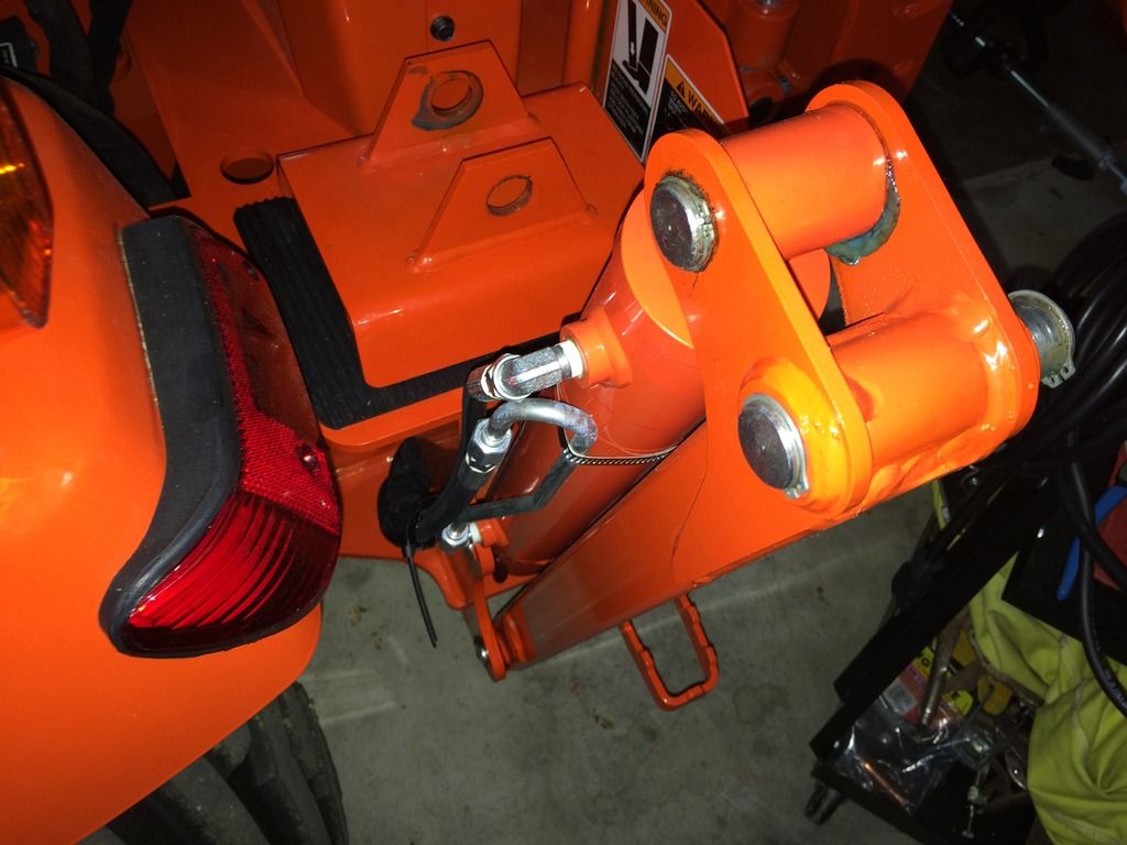

Here's what it looks like, with the pad off. I was concerned the bottom frame rail may fall down, since the cylinder is on the interior pin, but the frame is held to the cylinder with the interior pin. The pin to remove the pad only holds the pad.
I put the pin back in, for transport.
