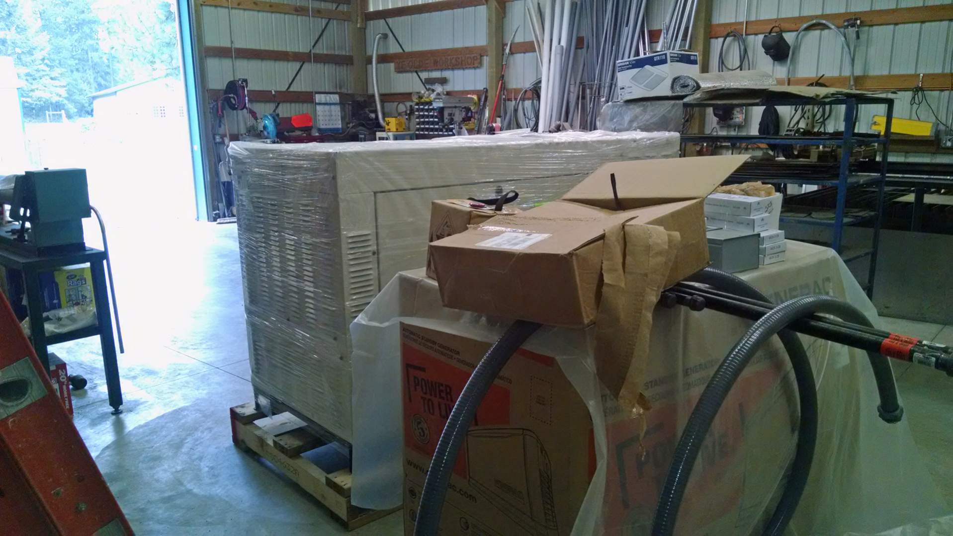

Everything is wired up as described above and a neighbor electrician looked it over before we confirmed that it works as intended!

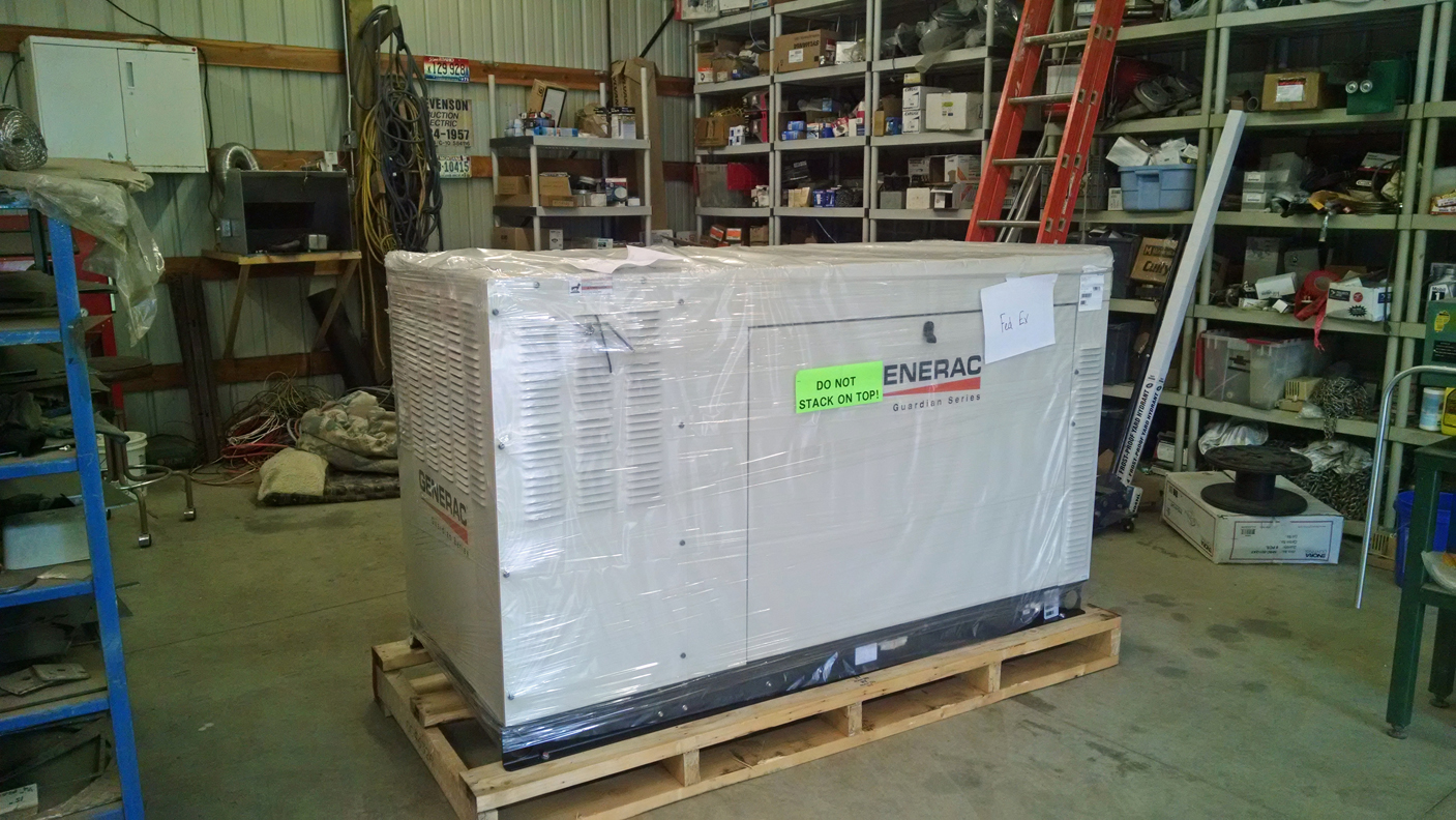

how this for a generator... its a 45KW generac
ankes the 22KW generac look like a toy

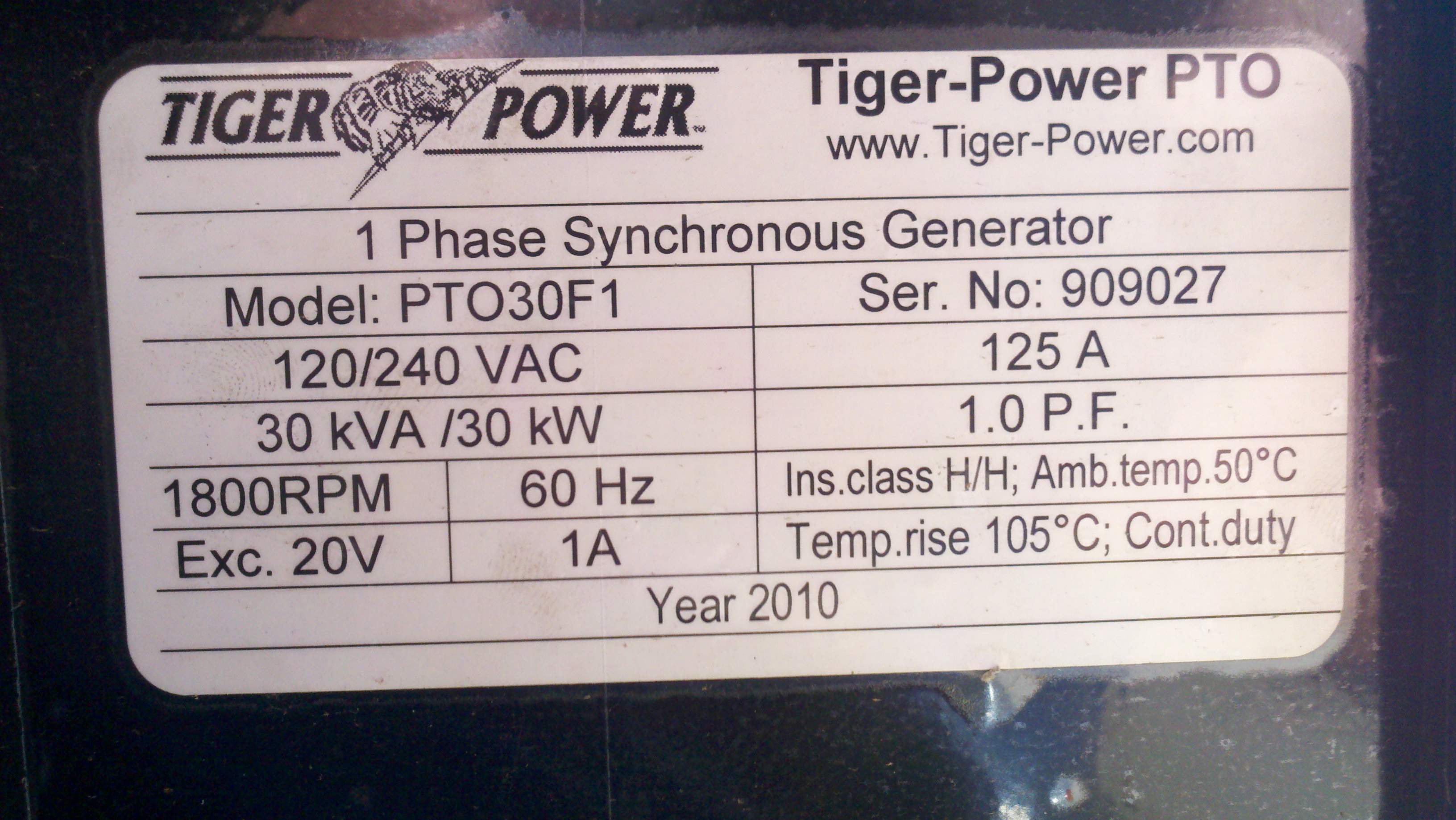

I see that 'tiger power' meter is labeled 'kw'. Does anyone know if it is truly kw. It is most likely showing kva.
Howdy,
The Tiger Power generator is listed as power factor 1.0. So it would be 30,000watts=30kw=30kva with a ample 90kva surge rating
