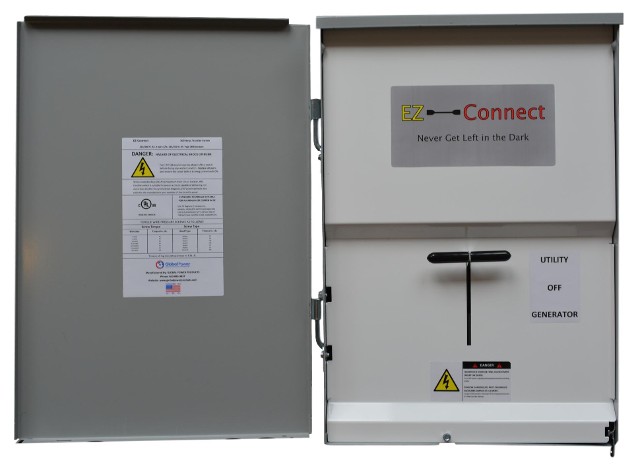

Howdy,
Another product has come out for connecting a generator. From the same company which does the Generlink.
Global EZ-Connect.
It looks to be a straight forward 3 position transfer switch. Made with a generator connection on the side of the unit.

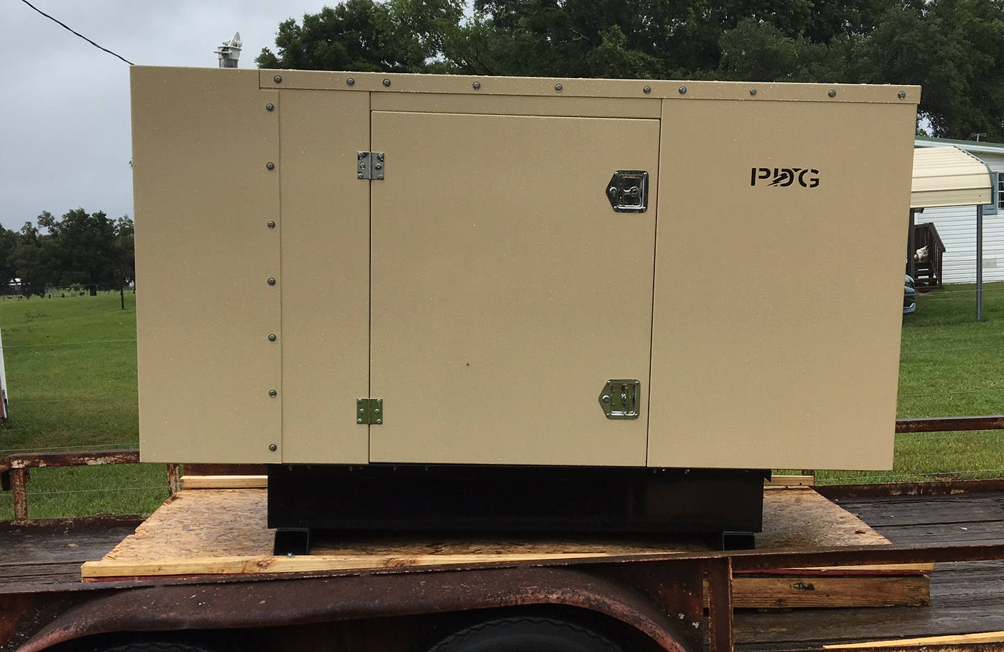

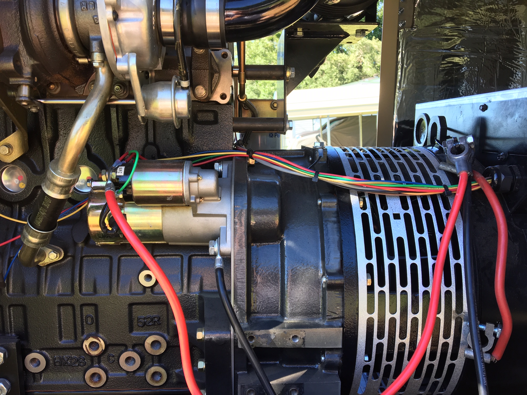

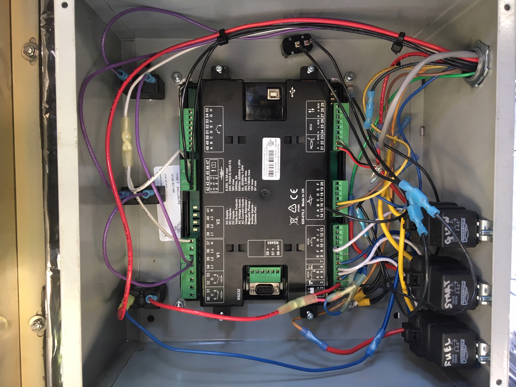

Here are some pics of the 35kva, Perkins, mecc-alte, with deep 7220 controller, generac 200 try switch, set and test ran it today
