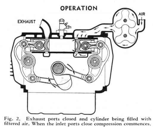

There are some new (USA) diesel technologies in development. Achates engines (Michigan) makes a two-stroke, opposing-piston diesel. This has 3 cylinders and 6 pistons (2 in each cylinder), two crankshafts, and no head. About 30% more fuel efficient than a traditional four-stroke diesel of the same horsepower, and also has very low emissions. On the question of overseas diesels, it's important to remember that those companies have been making diesels for along time, even more than DD or Cummins. Yanmar has been making diesels since 1912.
   / General Question on Diesels #18
The old british commer trucks had opposing piston engines back in the 50's but I don't know if they were petrol or diesel.
   / General Question on Diesels #19
Its diesel
   / General Question on Diesels #20
I doubt as refined as those described by Mike Madison, didn't realise they were a single crank.
