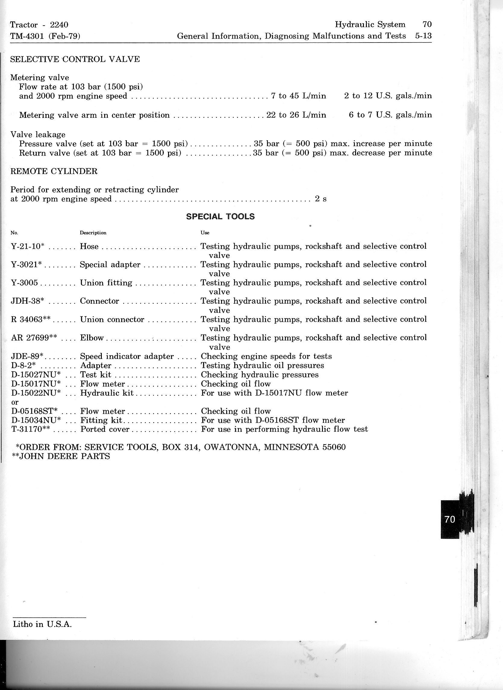

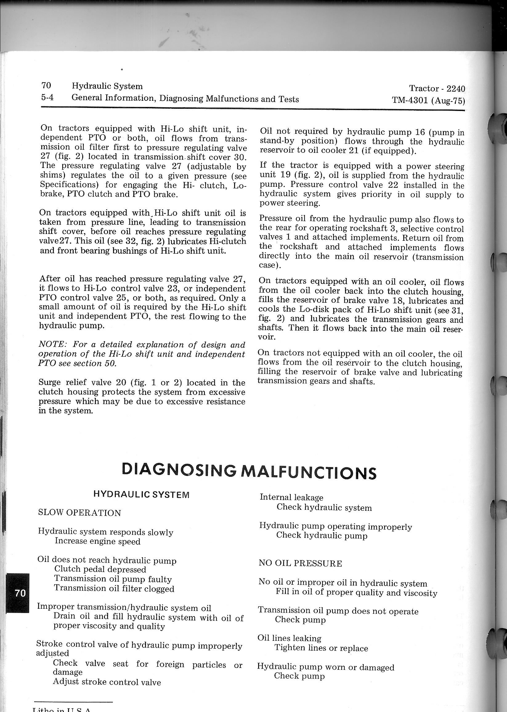

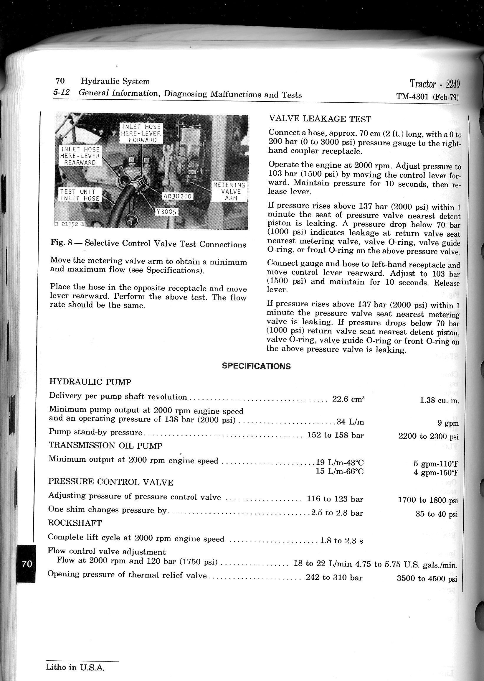

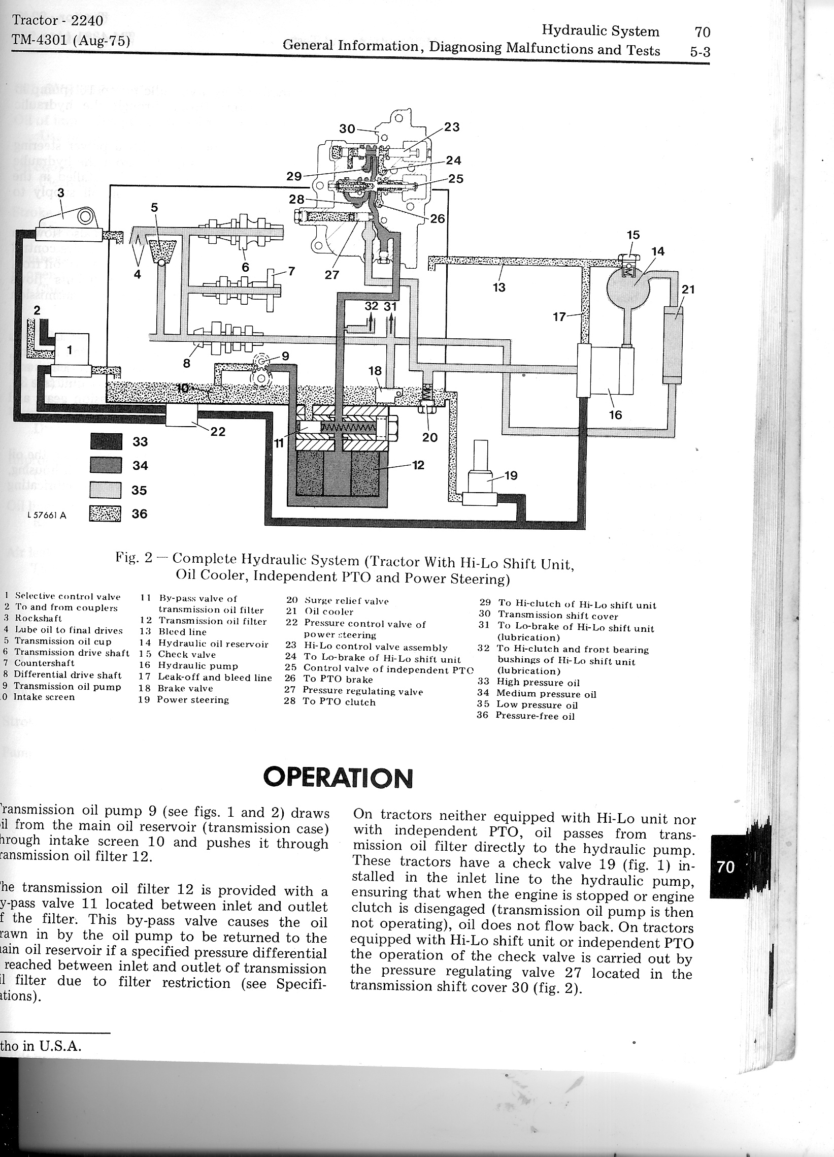

The 30 year old 68 HP (50 HP PTO) tractor I recently bought and am working on has a CC/CP hydraulic system. The backhoes and trackhoes I've used seem to be also.
As I've read on here over the last month, it seems as though nearly all the equipment on the forum have OC/CF hydraulic systems. I have been trying to figure out the reasoning for this. It would appear that it is a simple matter or economics, but helps me to understand the world of tractors which I am becomming a part of a little better.

Yes it is a matter of economics, a good example would be to look at the Sunstrand 8 piston variable volume pump diagrams and compare it to a two section gear pump. Lots more machining and small parts in the piston pump.
The 2240 when new was offered with either a power reverser or hi low options. Do you have either of these options on yours?
Just independent PTO, MFWD, and FEL. No Hi/Low or Reverser. It didn't even come with any rear remotes. I'll add those myself later. The only major problem it has is that it appears to have had steering damage and had the power steering housing replaced with a used unit with very extensive wear (the rest of the tractor only shows minor wear). I'm in the process of completely rebuilding the power steering housing.
