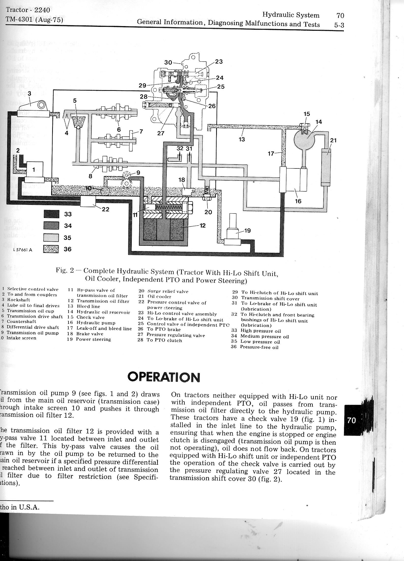

Here is the diagram from the tech manual.
No Hi-Lo shift or reverser on this tractor.
/ General hydraulics question #18
kenstrac nailed it. That is indeed how my system works. Didn't pick up on the charge pump portion being open center. Power steering works off the main pump though. Tranny lubrication, Independent PTO, and brakes off the charge pump.
Good drawing...but I like symbol drawings better though, they tell in detail how everything wroks...
there is nothing in the drawing verifying that the "charge pump" (your book name it transmission pump) supplies the main pump....
The "charge pump" system is a CP (the transmissionvalve #30, is a CC), and CF at the same time, which means max power taken out constantly....we can call it Constant Power system....this is the same princip as a engine pressure lubrication system....pos 32 in drawing shows flow path to pressure lube....
systems like this usually have a low flow and low pressure.....drawing says "#34=medium pressure oil", 300-500psi is my guess....book should say...and flow a few gpm....
Main pump is probably a variable displacement pump and main system seems to be a CC/CP system.

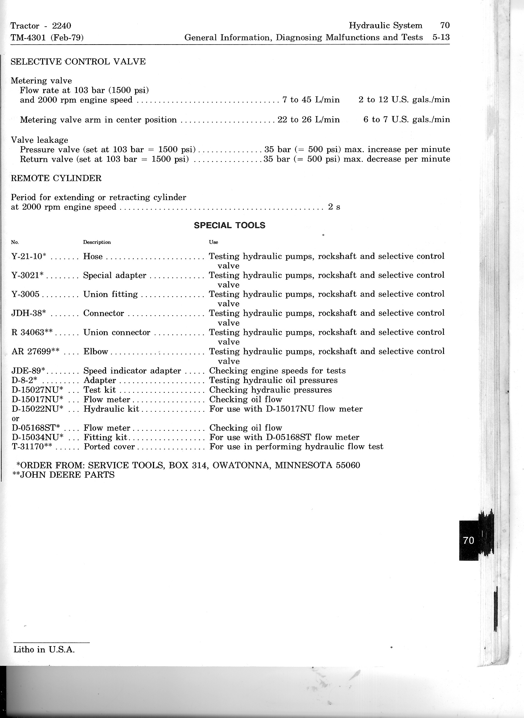

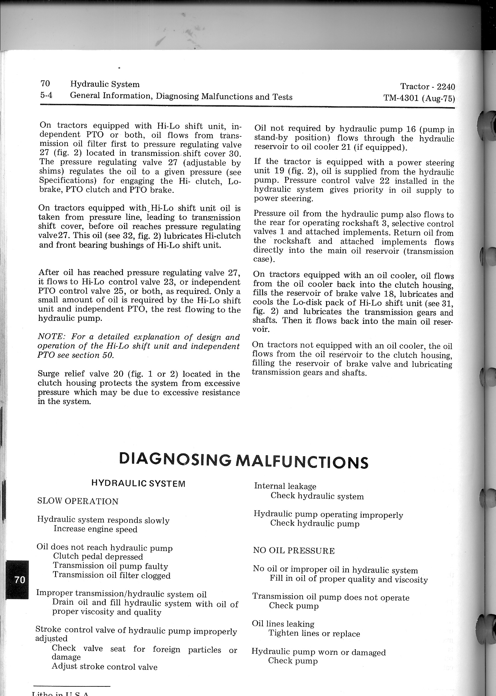

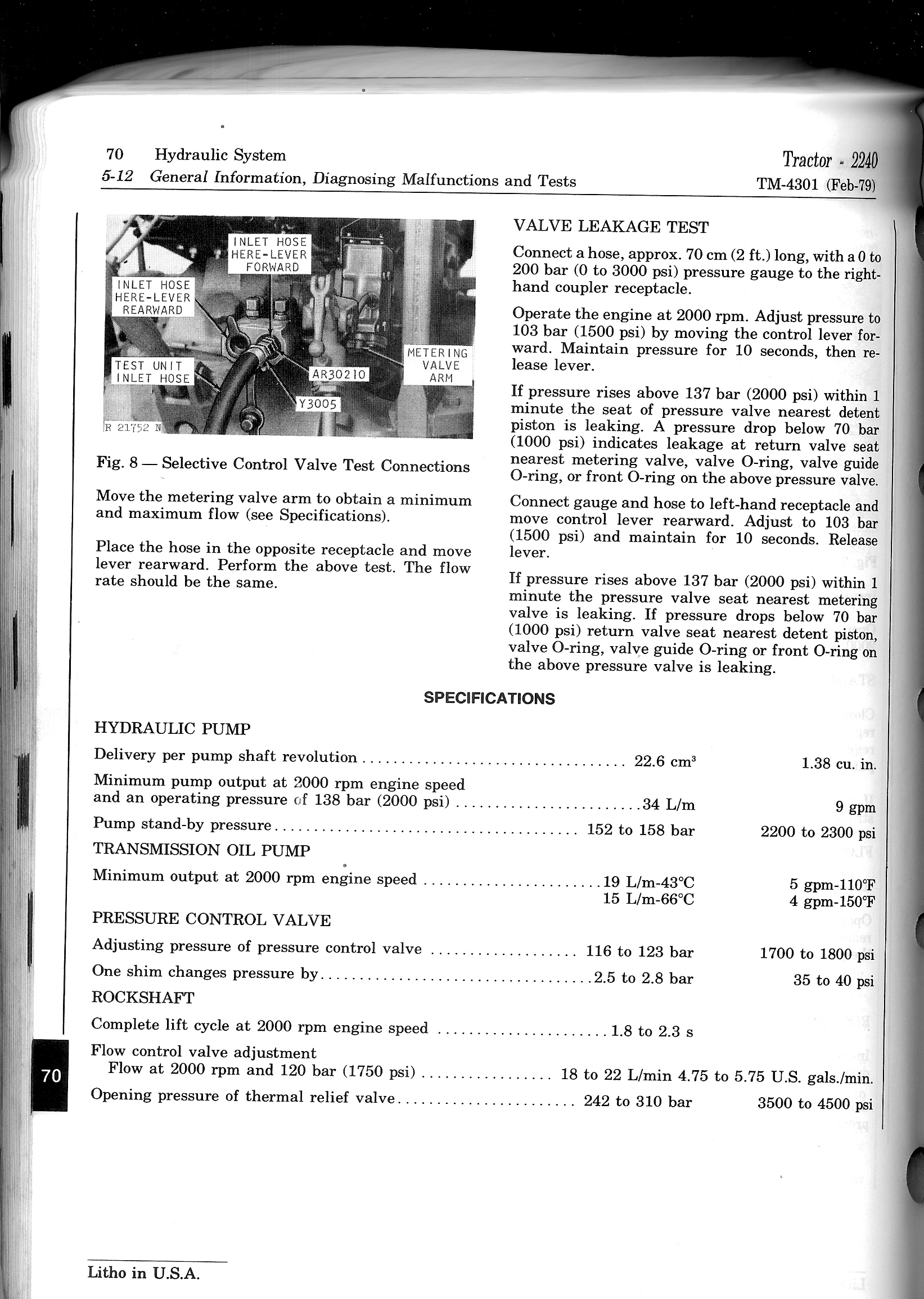

Sorry, I should have included the second page and specifications.
Oil is fed to the main pump through pressure regulating valve 27 @ 1700 to 1800 psi.
Oil not required by hydraulic pump 16 (pump in stand-by position) flows through the hydraulic reservoir to oil cooler 21 (if equiped) then back into the clutch housing, fills the reservoir of brake valve 18, and lubricates the trans gears and shafts. Then if flows back into the main oil reservoir.
