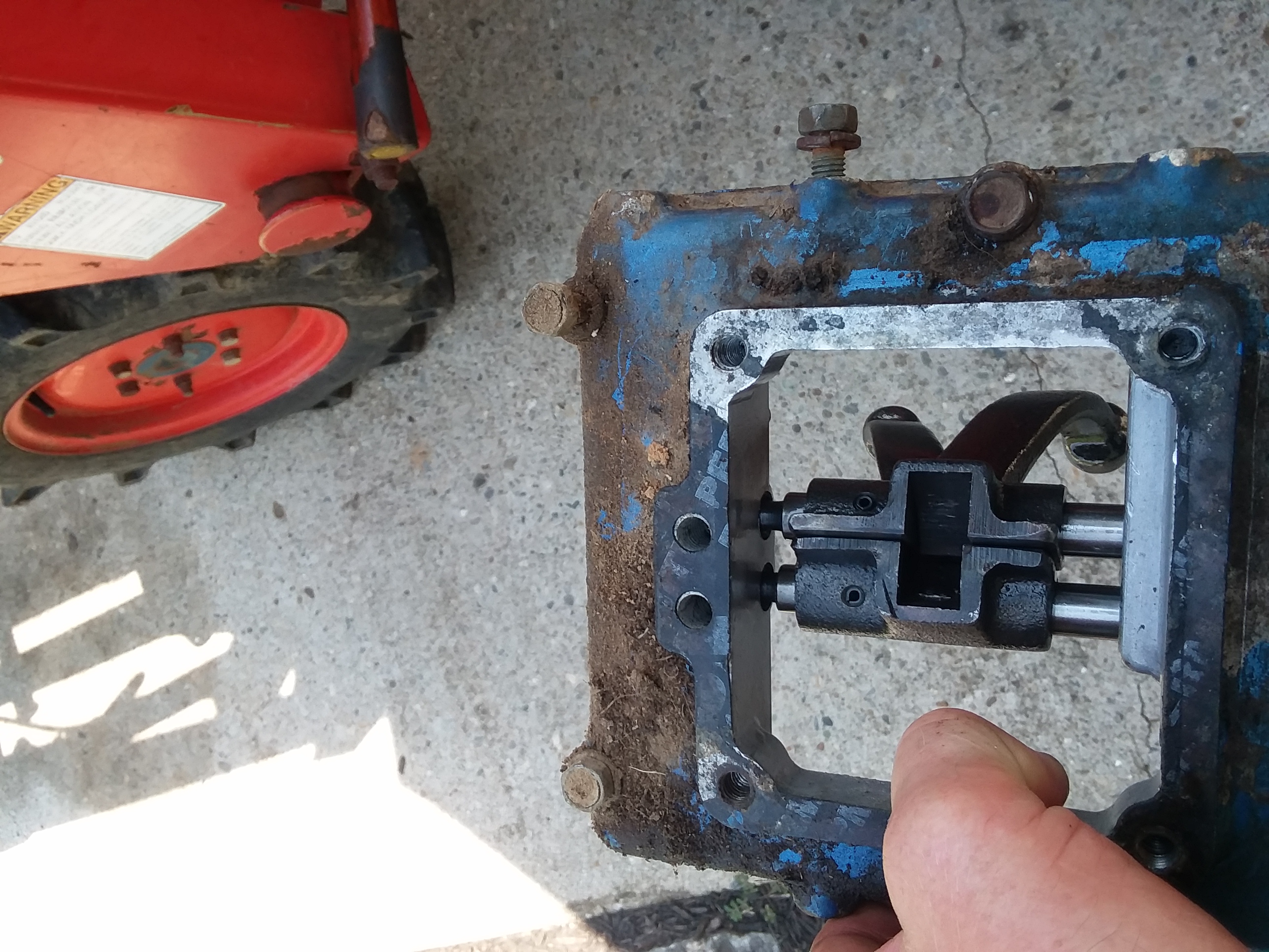

Took the shifter lever cover off and this is what i see..... kioti trans.jpg
Have tried to pry the left traveler up (forward) even removed the detent spring and ball bearing at top of picture....to no avail. Cannot get it to come out of 3rd.

Try moving the 1-2 shaft/fork (right one) forward/backward, and see if that frees up the 3-4 shaft. You should start with removing both detent springs and balls. There is a "blocking" pin that rides in grooves in the shafts (opposite ends from the detents). I am guessing that there is wear in that groove/pin and/or the detent grooves that is allowing both shift shafts to be slightly out of neutral at the same time, and that has jammed the 3-4 shaft in 3rd gear.
If 'jiggling' the 1-2 shaft doesn't help, take very careful notice if either/both shafts seem to be frozen in place. The forks are held tightly to the shafts, but there will be a slight 'looseness' between the forks and the grooves they ride in (typically 1/16" +/-). This "looseness" should be enough to determine if the problem is in the shafts, or in the synchronizers/sliding gear (looks like yours has the sliding gears - but it is kind of dark in your picture).
With both detents removed you should be able to move both shafts front to rear, and rotate - A VERY small amount, but enough to 'feel' that the shaft itself is not frozen. You should also be able to push (front to rear) on the gears ( synchronizers) that the forks ride in, and verify that they move freely (again, a very small amount, but enough to know that it will slide on the splines).

I am able to move the left (3/4) fork forward about 3/8 to 1/2 and inch. I will try the 1-2 fork next....

Maybe one of those locating split pins has sheared and allowed the selector to move along on the shaft.

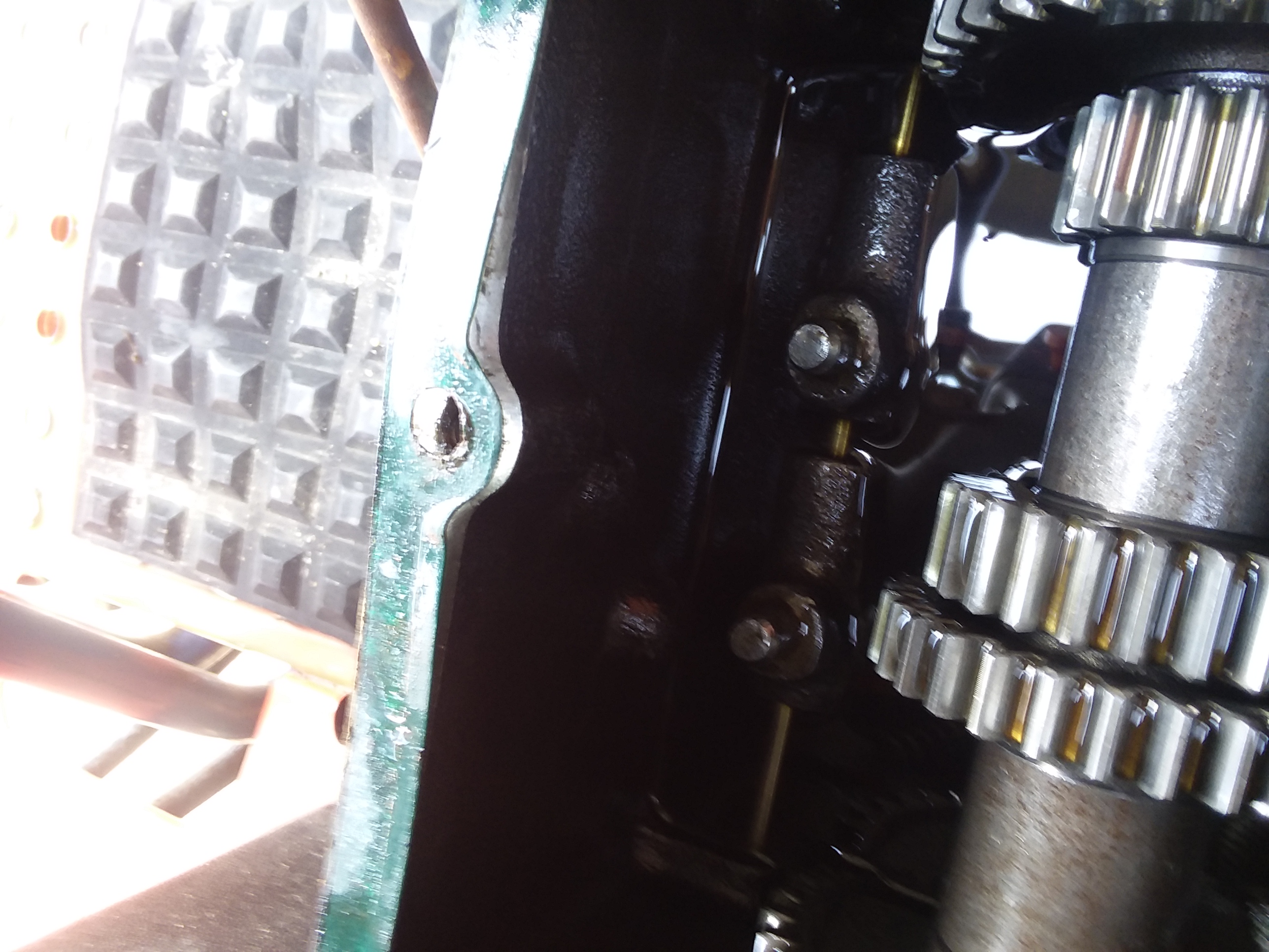

I took the next layer off and removed the "forks" and both of them slide independently. When one goes up or down the other is locked into position. The "balls" that they lock onto in the 2nd picture do not move freely. the bottom one jiggles for and aft but the front/top one does not. The left one is the 1/2 (right side slider) and the right/back is the 3/4 slider.20190627_112822.jpg20190627_112830.jpg

"I took the next layer off and removed the "forks" and both of them slide independently. When one goes up or down the other is locked into position. The "balls" that they lock onto in the 2nd picture do not move freely. the bottom one jiggles for and aft but the front/top one does not"
This seems like a very unusual transmission! Usually the cluster gear is on bottom, and the sliding gears on top. I may not be looking at it correctly, but it seems like the forks go down into the trans oil, and the sliding gears are completely under the oil. I think the "balls" you mention are the upper most part of the forks (the rest of the forks are below the oil and are not visible)
It sounds like you are saying that in the "layer" you removed, the two shafts do go back and forth freely, and that the lock out function is working also.
The "balls" (forks) should slide freely on the shaft; and it sounds like you are saying that at least one of them (forks) is not. If it were me, I would begin by draining the oil so that I could see into the bottom of the transmission. It should be relatively easy to determine if the fork is 'bound' to the shaft, or if it is the sliding gear that is binding on the splines.
