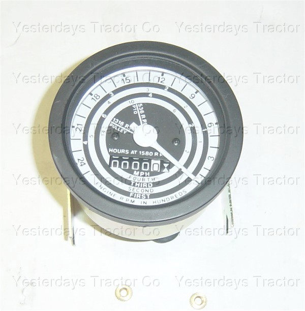

Thanks! :) So there's a chart around the edge of the tach with different rings for different gears for different RPMS? Anyone got a picture of that. Sounds interesting.
Yep.. here's a pic... meter denotes rpm in hundreds.. and there is a ring for each gear that shows ground speed in mph.. thus.. look at the needle, and then choose the ring for the gear you are in.. and you have ground speed... etc.

Thanks for the picture. Weird that it reads counter clockwise, though. :)
Pretty neat and simple concept.
