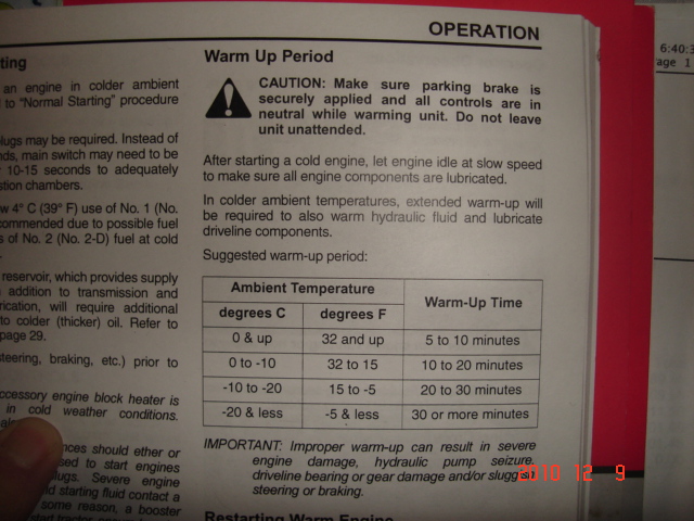

Perhaps I don't need to mention this Gio, but here goes anyway:
Keep in mind, the block heater will help the engine start & get up to temp quickly, BUT the real issue is allowing the tractor to run long enough to warm up the hydraulic fluid.
That's the bugaboo... having the hydraulic fluid warm enough to circulate easily and do its job, under pressure. I don't believe the block heater has much, if any, effect on the hydraulic fluid temp --that's in the transmission at the rear of the tractor.
That's why I use my block heater, as others do, for only about 1/2 to 1 hour, just enough to help the engine start more easily. THEN let the tractor idle long enough to warm the hydraulic fluid by pumping it 'round & 'round.....
Your owner's manual should have a chart that tells the time the tractor should idle, according to temperature, to get the hydraulic fluid warm enough to do its job (without bursting hoses and/or fittings, or worse....). Bad things can happen if the hydraulic fluid isn't warm enough when you start to work it hard!
Maybe you already knew that, and if so, I apologize for going on & on.:)

Hey, the chart is an excellent idea. Maybe someone can write one up and post it? I would like to have a print out of this hanging in the garage.

/ GC2410 MF block heater problem #36
Here it is, from my GC2310 Owner's Manual, page 29. (Sorry it came out a bit dark... but still readable.)
Keep in mind, this is for the OEM hydraulic fluid, Permatran III.
Many folks (including me soon, I hope) have swapped the "normal" hydraulic fluid for a synthetic type, which remains less viscous at lower temps and requires less warm-up time (and less fuel!).

The 2400 series says the same thing.
I may change to synthetic after the warranty expires, dunno though...........Start tractor, come inside where it's warm, drink coffee, scan TBN for new posts, then clear driveway:thumbsup:
