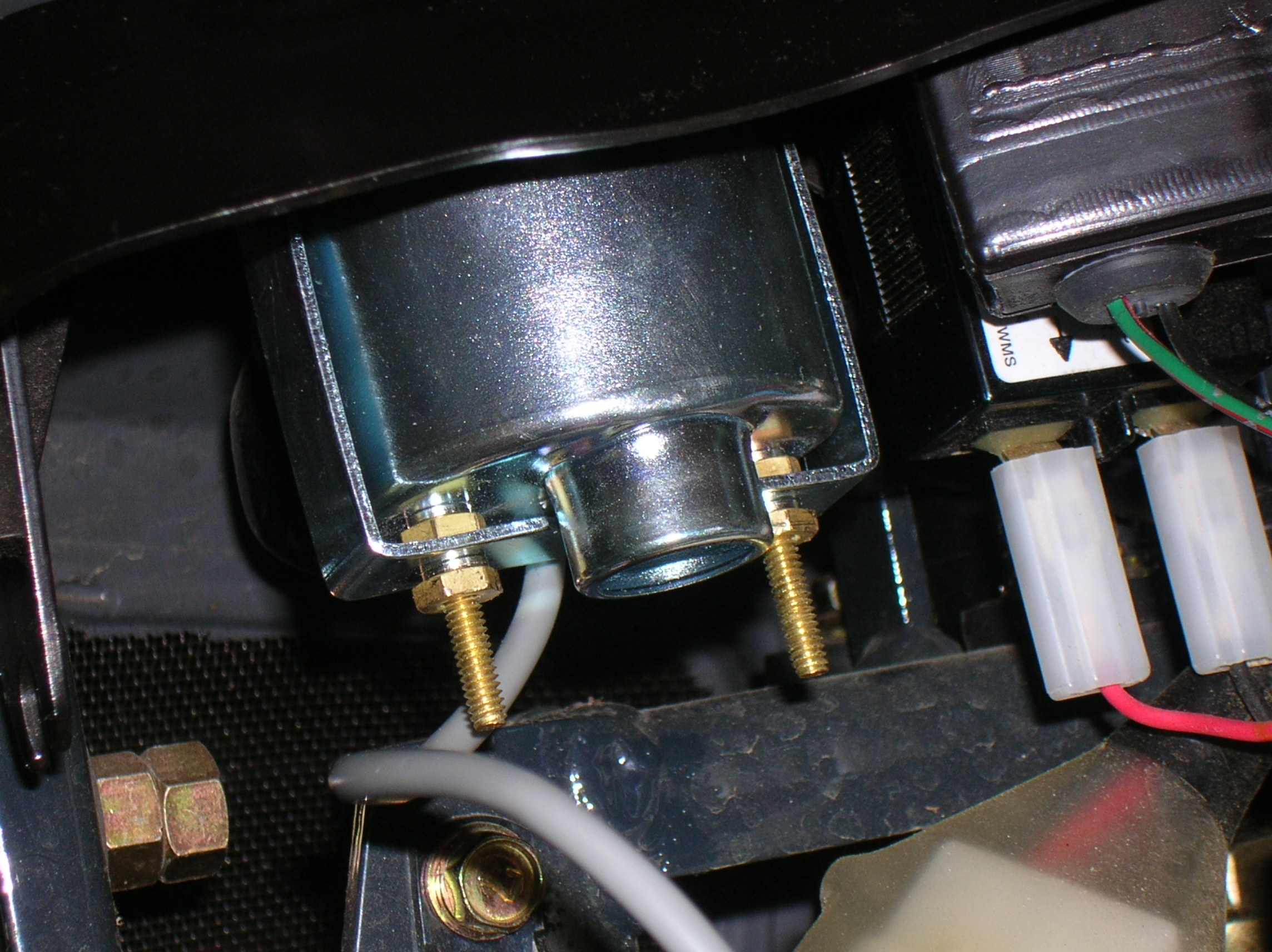

Underside of the dash, with the tachometer

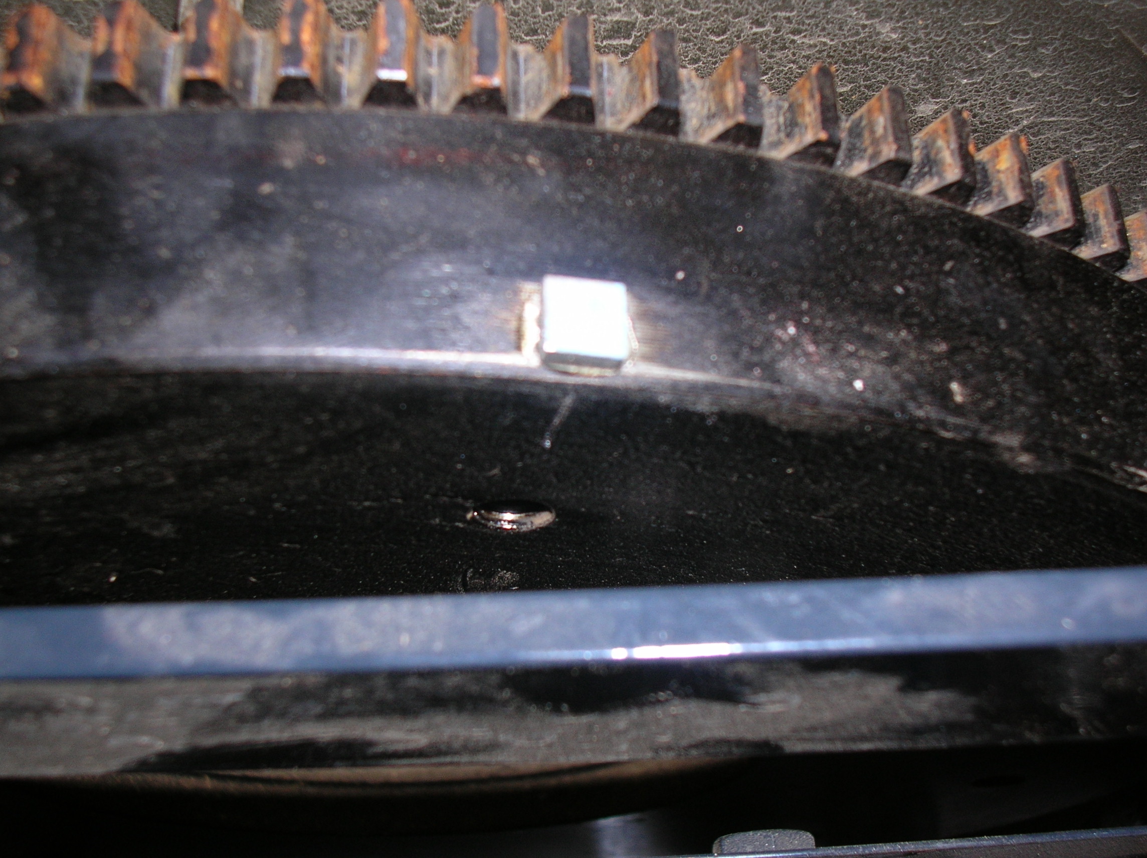

One of the magnets, mounted on the engine flywheel

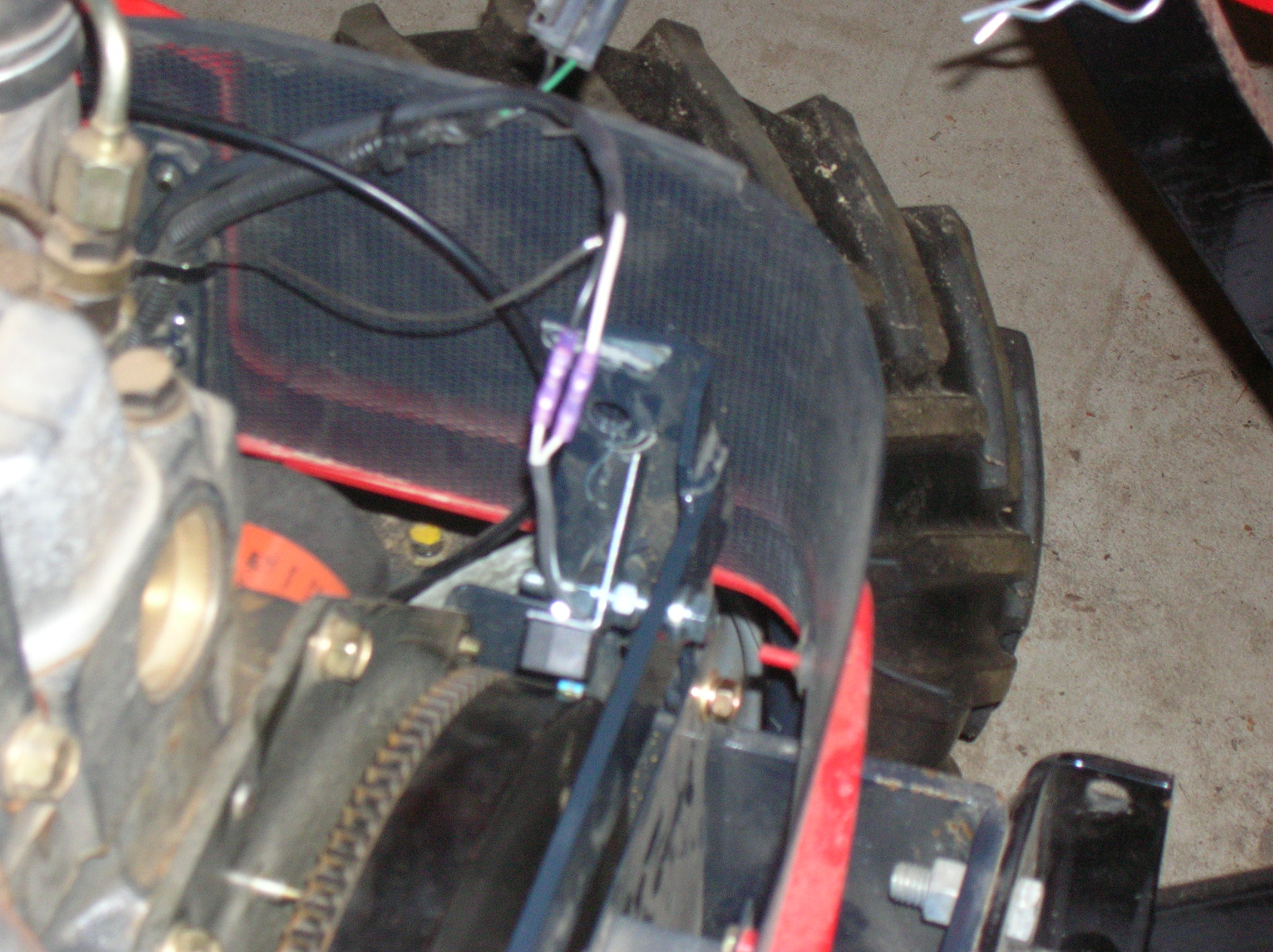

Sensor location at front of tractor

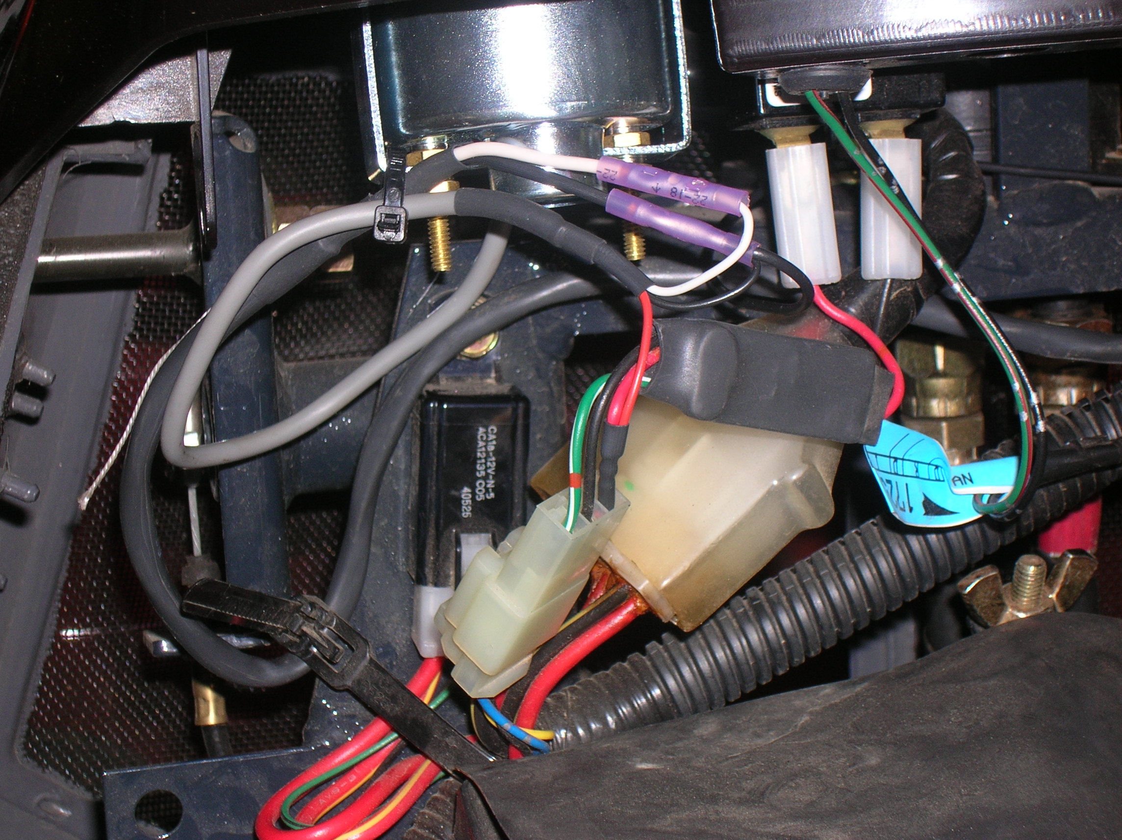

Underside of the dash, with the new wiring completed
