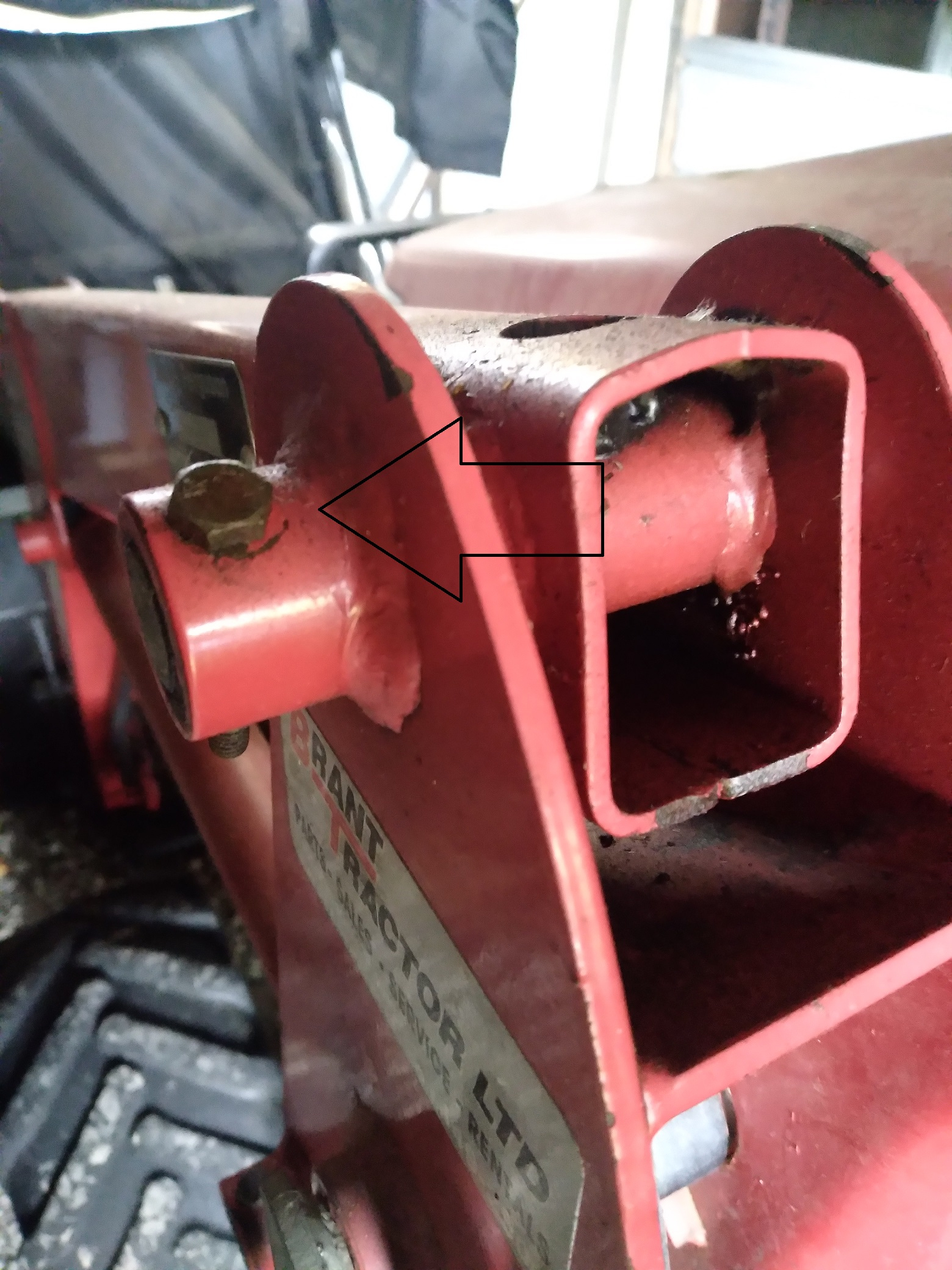

Not sure if this is relevant, but a few years ago the bolt in the loader mount sheared, and the pin started walking out. No visible damage, but no idea why it happened. May be related to frame/loader flex.

Yes, but you are over simplifying the forces that are applied to the frame when these guys are using it.
It's not ever a simple one side stays in place, while the other side is moved up or down shearing force,
Because of the rear end housing, and the crossmembers, which transfer the forces to the other rail, it's a twisting force.
The whole frame has to be able to resist it, not just the crossmembers. Flex the rails enough at their weakest point, and you will have a failure. That's exactly why the TLB frame is beefed up, and not the cross members. The weakest point is the side rails.
