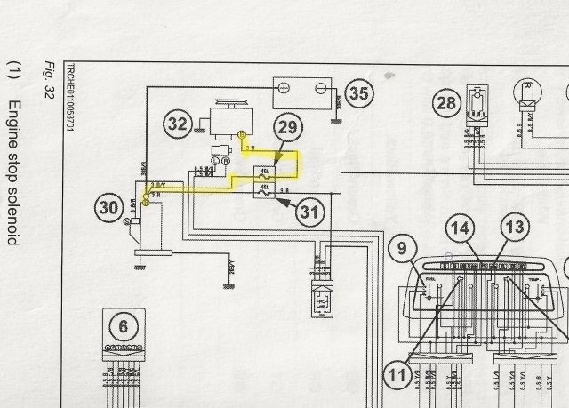

I cannot find mine and am having the same problem on a GC1705 2018 model. ANyone know where exactly it is located?? Thanks
/ GC2300 60amp fuse #5
The GC1705/10/15/20 series tractor does not have a 60 amp slow blow fuse, only fuse between alternator and 12 volt (battery terminal on starter solenoid) is a 40 amp slow blow and and runs from the "B" terminal on alternator through fuse #11 on fuse block (#29 in diagram) and to 12 Volt battery terminal on starter solenoid...... YOu should have 12volts standing all the time on "B" terminal of alternator if path is good...
/ GC2300 60amp fuse #6
Found my problem it was the 40 amp fuse and you were correct no 60 as I tore wiring apart and nothing
