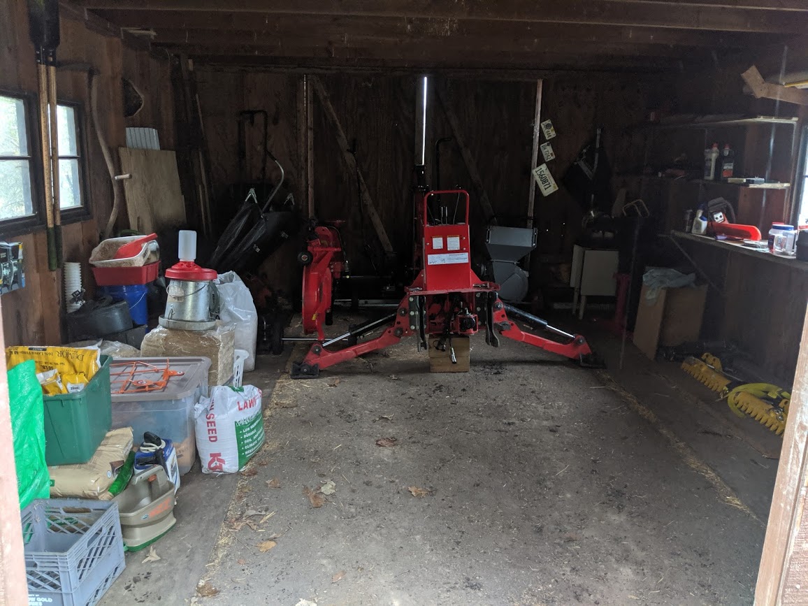

Actually, I've had this thing working as a tlb pretty much since I got it, I had enough work for it to do for loader and backhoe. Couple days ago I finally dropped off the hoe and strapped on the snow blade coz we were expecting weather here.
There she is, sitting next to the mower deck, asking what am I doing here with you?!! IMG_20191030_094121.jpg
