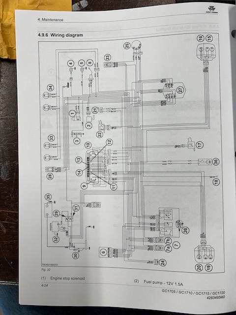

6. With my marginal schematic reading skills, it appears this circuit also has the left turn light and left running light on it. Checked bulb, it was fine. No corrosion, wiring looked good.
Circuit also appears to have seat safety switch on it. And then to the multi switch and ignition.
7. What has me scratching my head is, with the fuse blown, both fuel and temp gages now work. Left turn signal and running light don't. The only wire that this fuse sees is a solid green one.

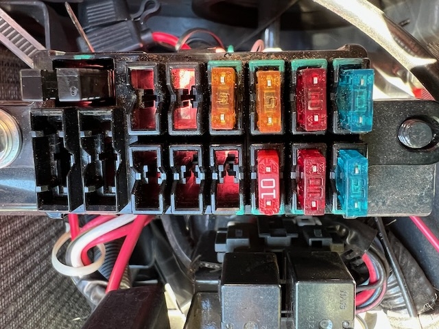

Thought I would post a picture of the bottom of the fuse block. The fuse that keeps blowing as soon as the key is turned is the one with the green wire to it. No wire on the second side. I don't understand how a fuse can work with only one wire to it. You can see there is the fuse in front of it with the single white/black wire. That fuse is fine and and shows #7 controlling aux power, which I think is a small connection that is under the seat for rear power.
I'm guessing there is a wire somewhere that is shorting out. I may have to do some disassembly to be able to trace and check each one.
Any other ideas would be appreciated.

/ GC1705 Fuel & Temp Gage Issue #16
that position 8 on block? instrument panel and engine start system?
or position 9, work lamp.
if 9 look towards worklight wire on backend of tractor and make sure not bare.

/ GC1705 Fuel & Temp Gage Issue #18
if position 8 its NOT work light. that would be position 9.
/ GC1705 Fuel & Temp Gage Issue #19
I Think red/white wire (direct from ign switch) serves all three fuse positions (two without wires)... Look to see if there is a common buss between positions.... Don't put a lot of faith in wiring diagram either, my manual has errors on how fuse position serve components and wire colors...
Diagram also says fuse #8 should be red/black wire, BUT it is actually a white/black (in picture)
Fuse #8 serves..
#2 Fuel Pump
#17 Seat Switch
#22 "Safety Switch" (sub change) [neutral switch ???]
#32 Alternator Plug (12 volt to initialize alternator.)
Also fuel and temp gauges (and lot of other stuff in inst.pnl.)
