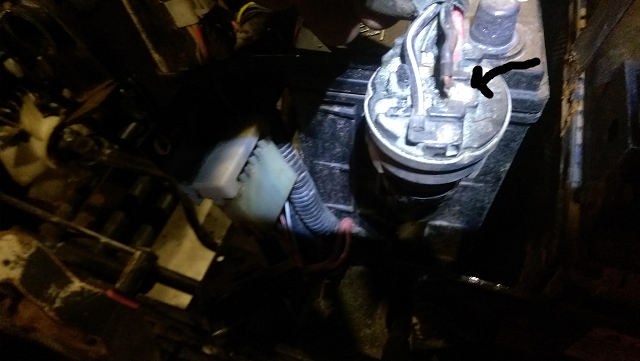

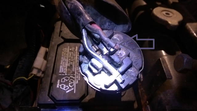

Ray66vv ironically my switch failed today , the plastic cover under the switch actually appears to have been holding moisture ,not positive but appears to be the ground wire that broke on my gc2300 and am goin to try and resolder . and will post a pic
what happened i was removing the bushings on the power steering bolts on the steering column and i grabbed the bottom of the switch and moved it so i could better access my bolts when i went to restart there were no dash lights at all and it would not crank. i started trouble shooting and found the wire loose .

I remember someone taking theirs apart.
I probably would try.
I am hoping to find out which wire breaks off, and see if I can take the strain off of it.

I don’t think it’s just corrosion.
And, I don’t think the dielectric grease will hurt anything.
