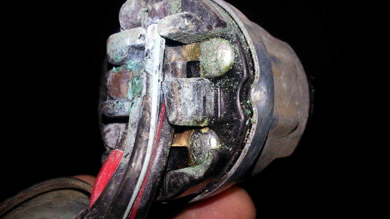

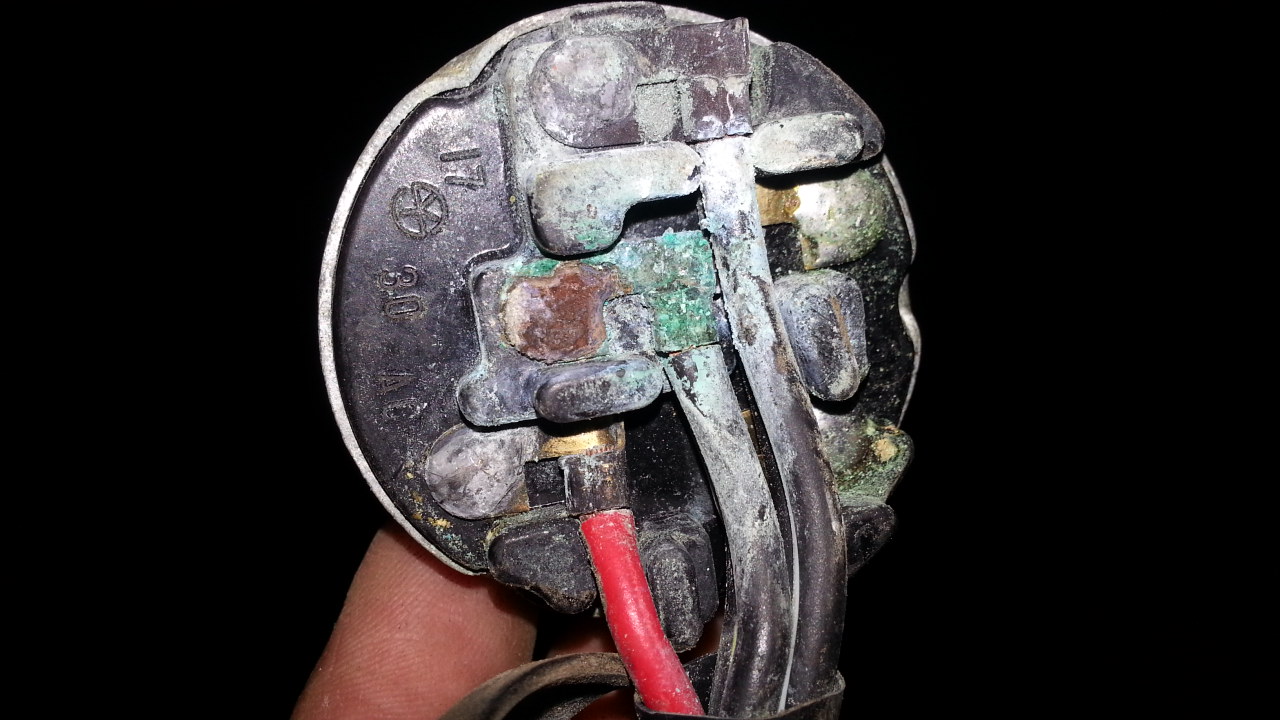

I had the same issue and thought it was the starter. Logged in here and thanks to the posters discovered it was the ignition switch. Cleaned it up and now it works fine. Thanks for sharing all this great information! Although I always keep the key in it, the retaining ring was loose so there wasn't a good seal. I'm thinking that's how the water got into the ignition. I posted a couple of pics of my ignition switch.

Thanks to you too, Artman for the photo's.
Can anyone who has had a wire break off the ignition switch tell us now that we have photos, which one it was?
   / GC 2300 wont start #67
Whaddya mean, corrosion? (What's that green stuff?)
   / GC 2300 wont start #68
Looks more like patina. :thumbsup:
   / GC 2300 wont start #69
Patina.. yeah
Seriously, thanks for the pics, artman. Good shots of what to look for. (So far I've been lucky, I guess.)
Ray, did somebody say they found a way to take those switches apart, or do they just have to be replaced?
irvingj
   / GC 2300 wont start #70
I remember someone taking theirs apart.
I probably would try.
I am hoping to find out which wire breaks off, and see if I can take the strain off of it.
