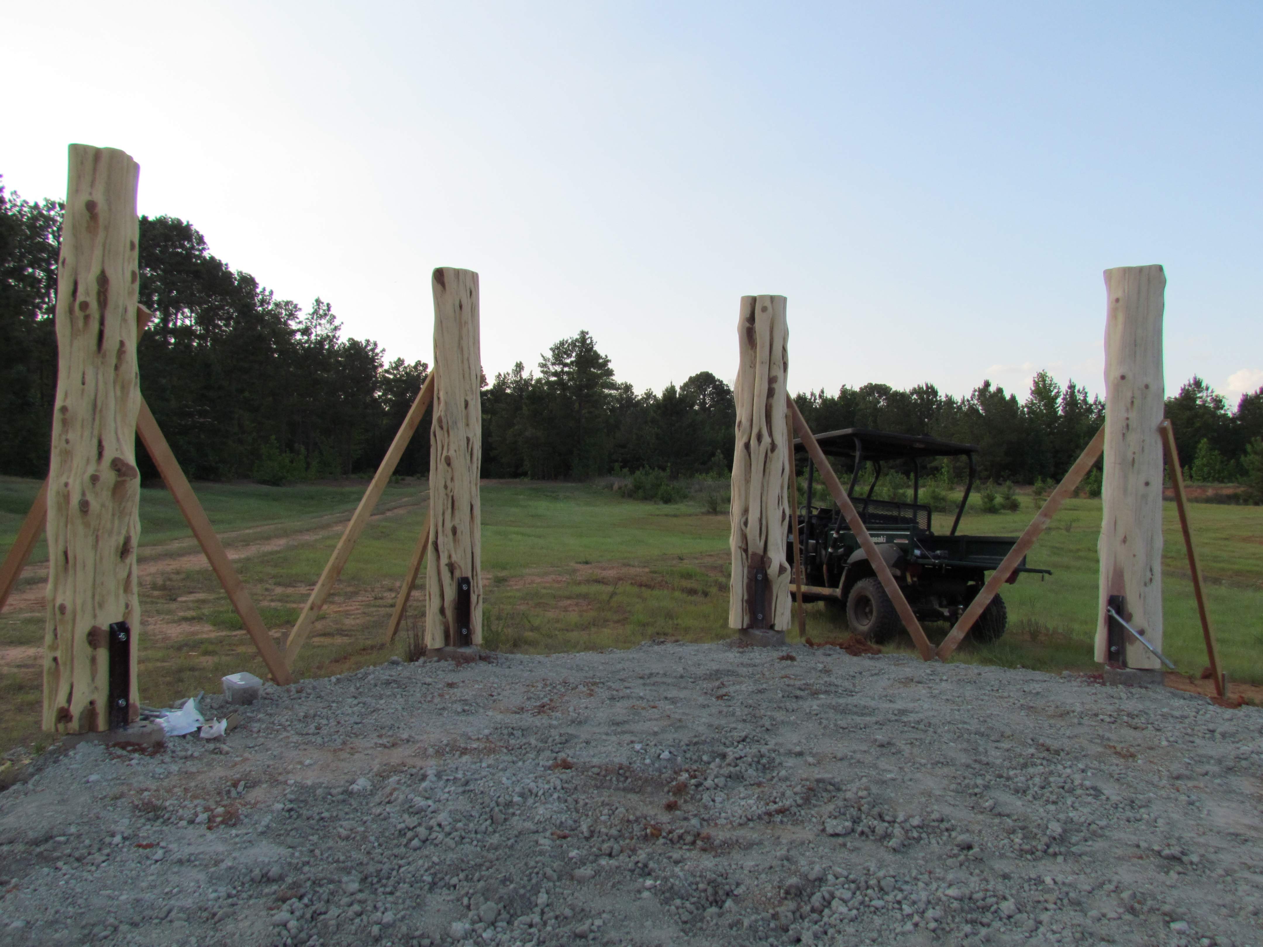

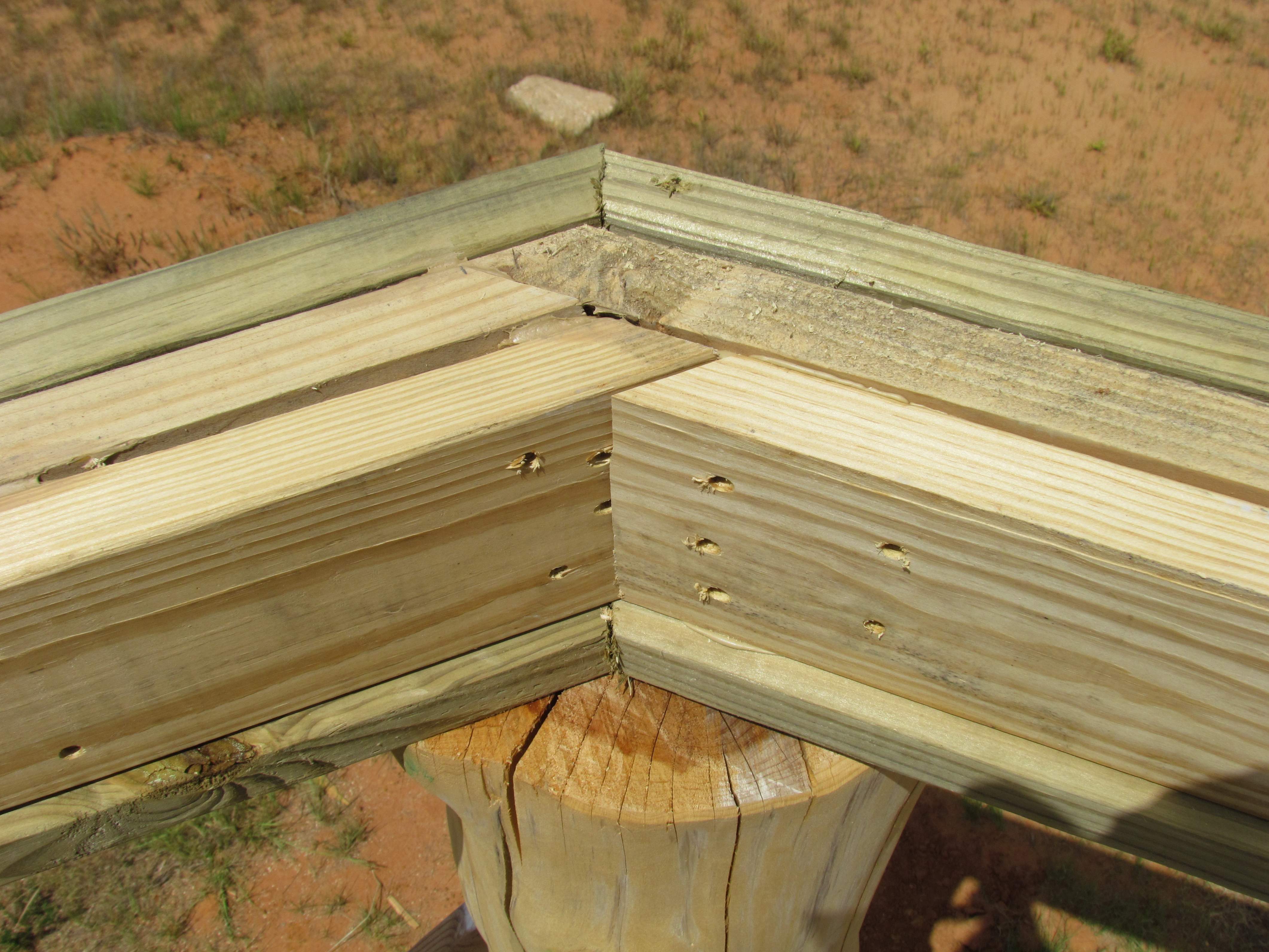

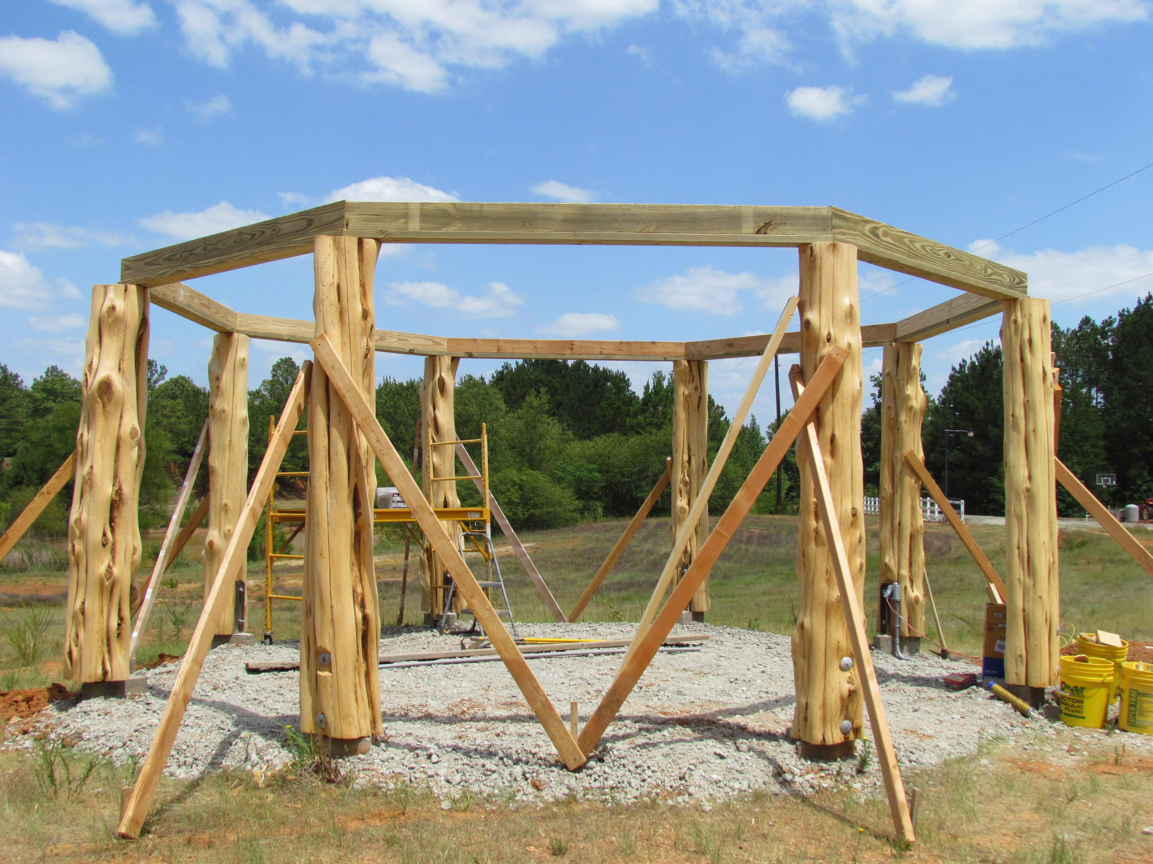

I leveled off the posts and built the headers on top of them. I used PT 2x6's for the bottom and outside boards and regular boards for the center and middle boards. I decided to go with tripple 2x6's with liquid nails and 3 inch deck screws to hold them together because I wanted it to have some beef to it. A pair of 2x8's would have done the job cheaper and faster, but it wasn't the look that I wanted. I also overlaped my center and interior boards to give it just a bit more strength. I've never actually seen this done before, but it seems like a good idea.
Oscar joined me for awhile, but then it got too hot for him, and he decided to take a nap!! :thumbsup::D
Eddie

/ Gazebo Number One #66
Looks great Eddie! I love the look of those logs/posts.
Are you going to use smaller logs/posts for the ceiling support/runners, or conventional framing?
Frank

The rest of it will be built from conventional lumber. I have a few things that I'm going to do with the roof to make it unique, and I'm also adding black iron to it for strength and to make it look nicer. I want wood, iron and rock. My favorite elements in building!!!!
Oscar is my pet pig. I found him behind my place when he was just a few weeks old and still too young to eat on his own. I had to bottle feed him for a week or so before he would eat cream of corn and drink out of a bowl.
Eddie

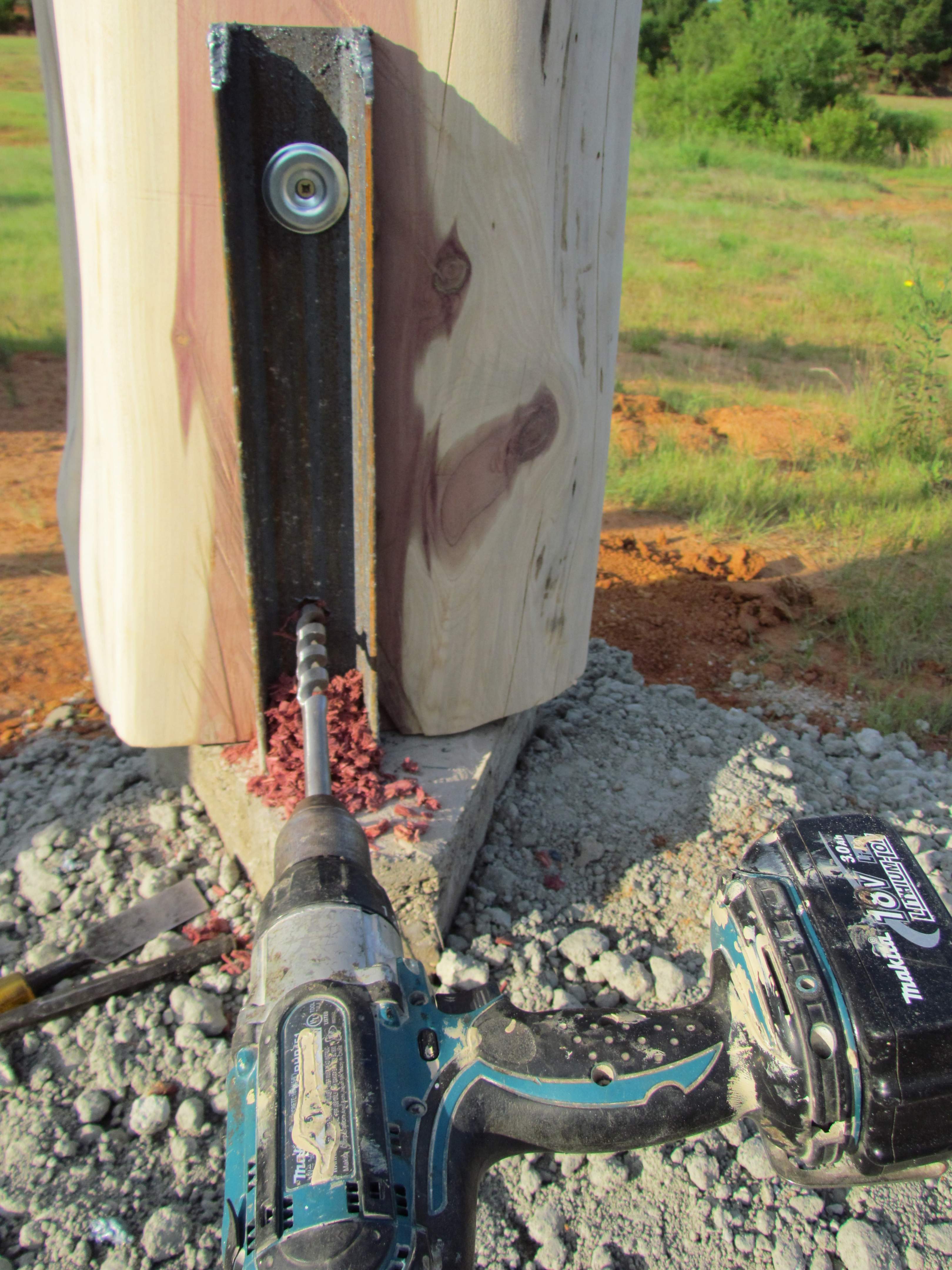

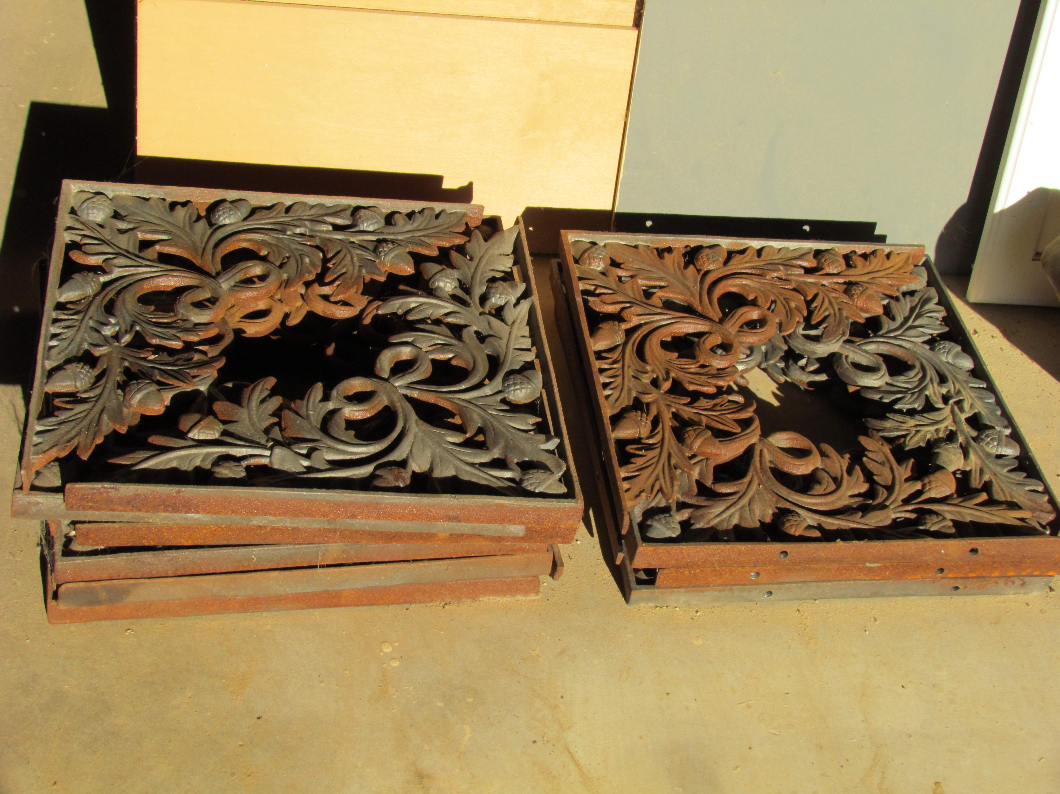

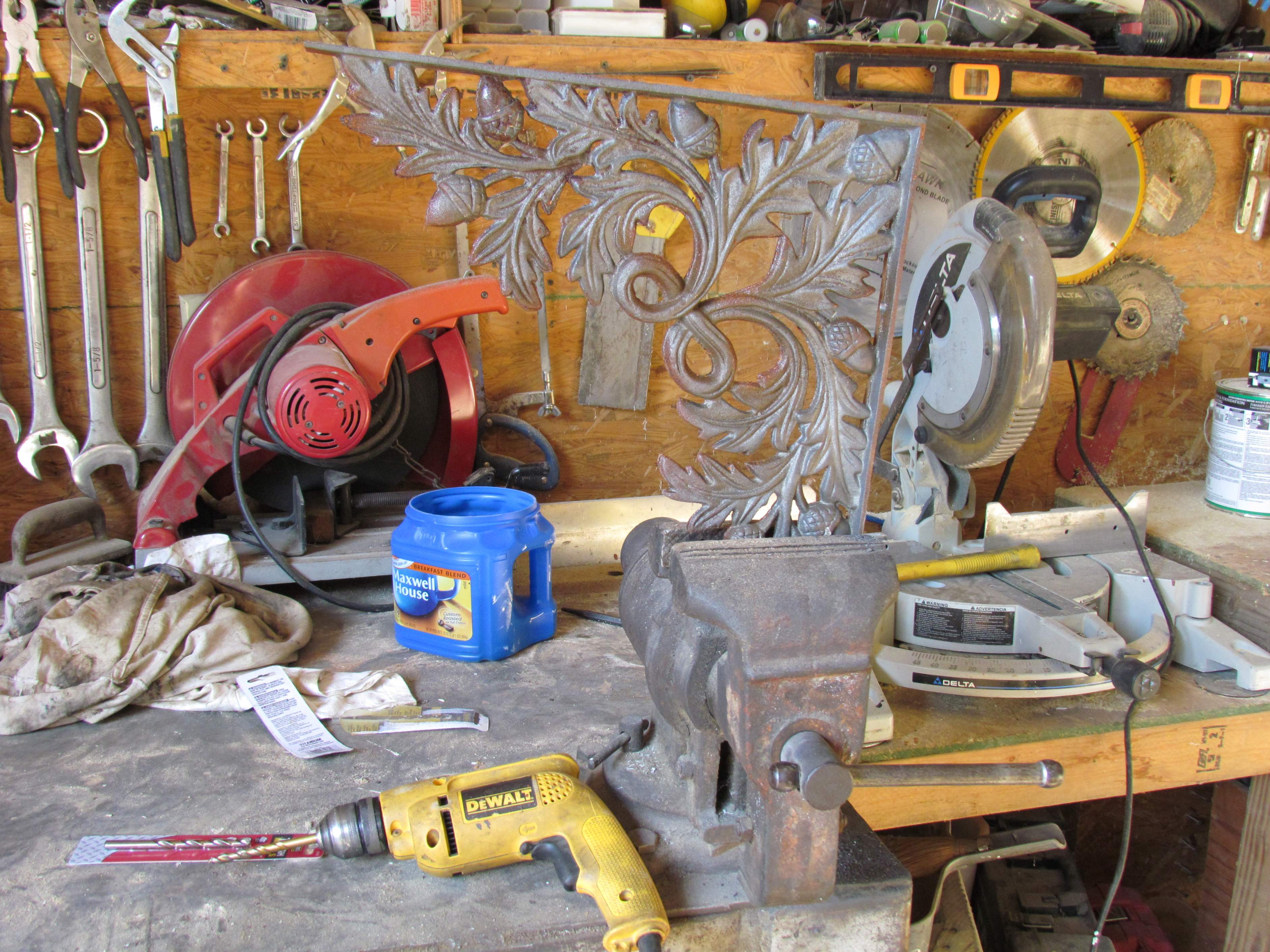

I was up late last night working on my metal brackets. I bought them from King Architectural Metals Wrought iron & aluminum metal balusters, spindles, stairs fence & gate hardware, hinges& handles, finials, steel pipe & fittings, automatic gate openers-operators, Access Control a few years ago. This really has been something that I've been planing on building for quite awhile!!!!
Each bracket needs to have four 5/16 holes drilled in them. Then I will sand blast and paint them. If the paint doesn't last, I will get them powder coated, but I have these same brackets on my hot tub gazebo, and there isn't any sign of rust or wear on them after about five years.
When I'm working on something, Oscar likes to come check out what I'm doing, and then sort of hang out in the area. Last night, he set up watch just outside my shop door. About the only thing that I've trained him in is to NOT come into my shop!!!
Eddie

What?:confused: No pneumatic drill?:eek: Bet you go through a bunch of those small elelctric drills.;)

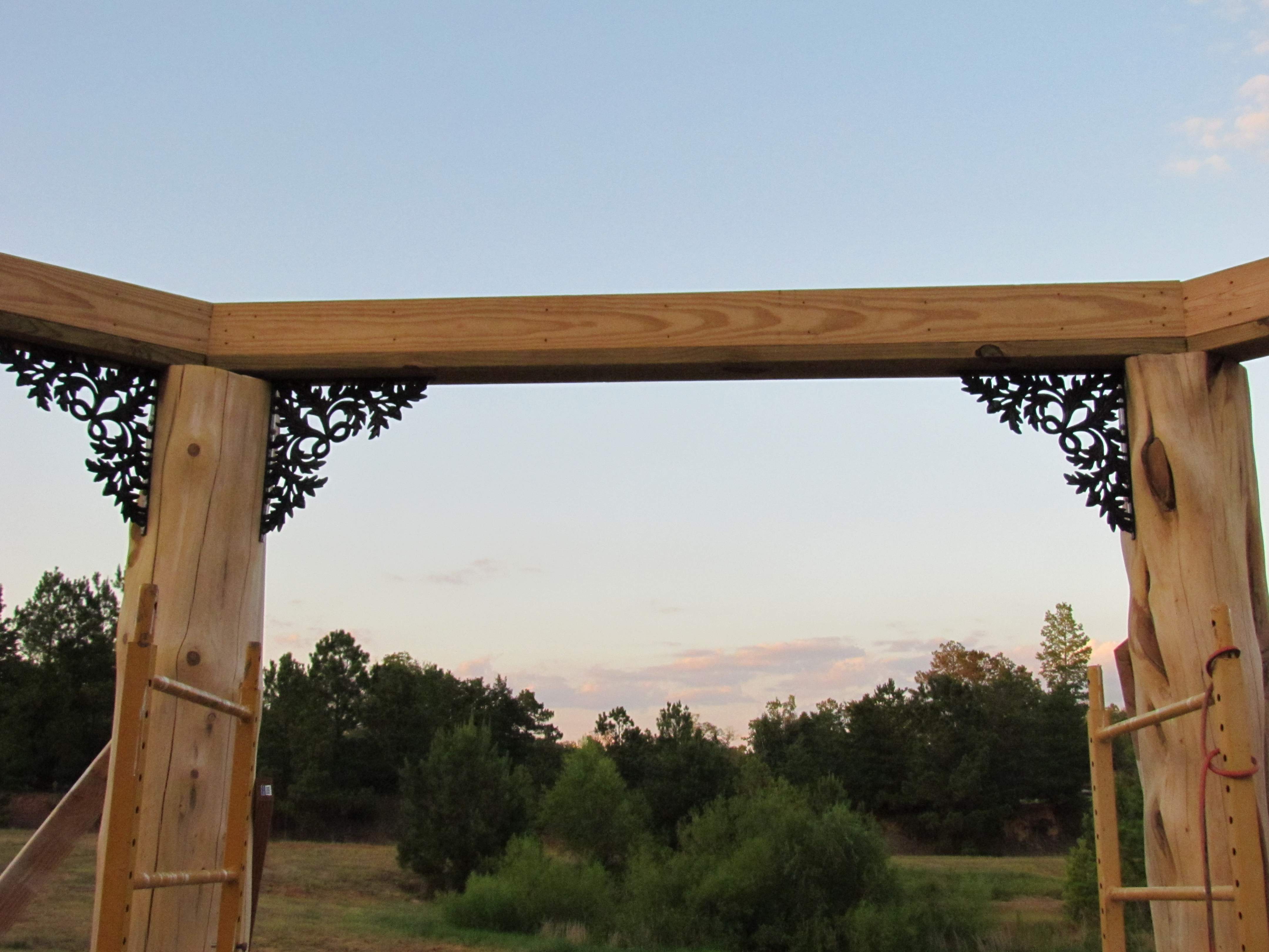

Thank you. I'm not getting as much done as I had hoped I would, but it's not really a suprise either. Work has a way of taking up a lot of my time, as do other projects.
I don't really have a plan, or anything in writing. It's just a picture thats in my head that I'm going off of. I've done some quick sketches on graph paper to see if I can change a few things, but none of those look like what I see in my head.
I have more pics and comments on facebook, if you want to look there.
Right now I've been sandblasting the brackets that I'm using to brace the tops of the posts. Before I could install them, I had to trim and sand the posts to get a 90 degree angle to fit the brackets into place. Then I drilled four holes into the brackets, sand blasted them, primed them and painted them. It's a slow process that is painful because of the heat. 18 days in a row of 100 plus temps!!!
Eddie
