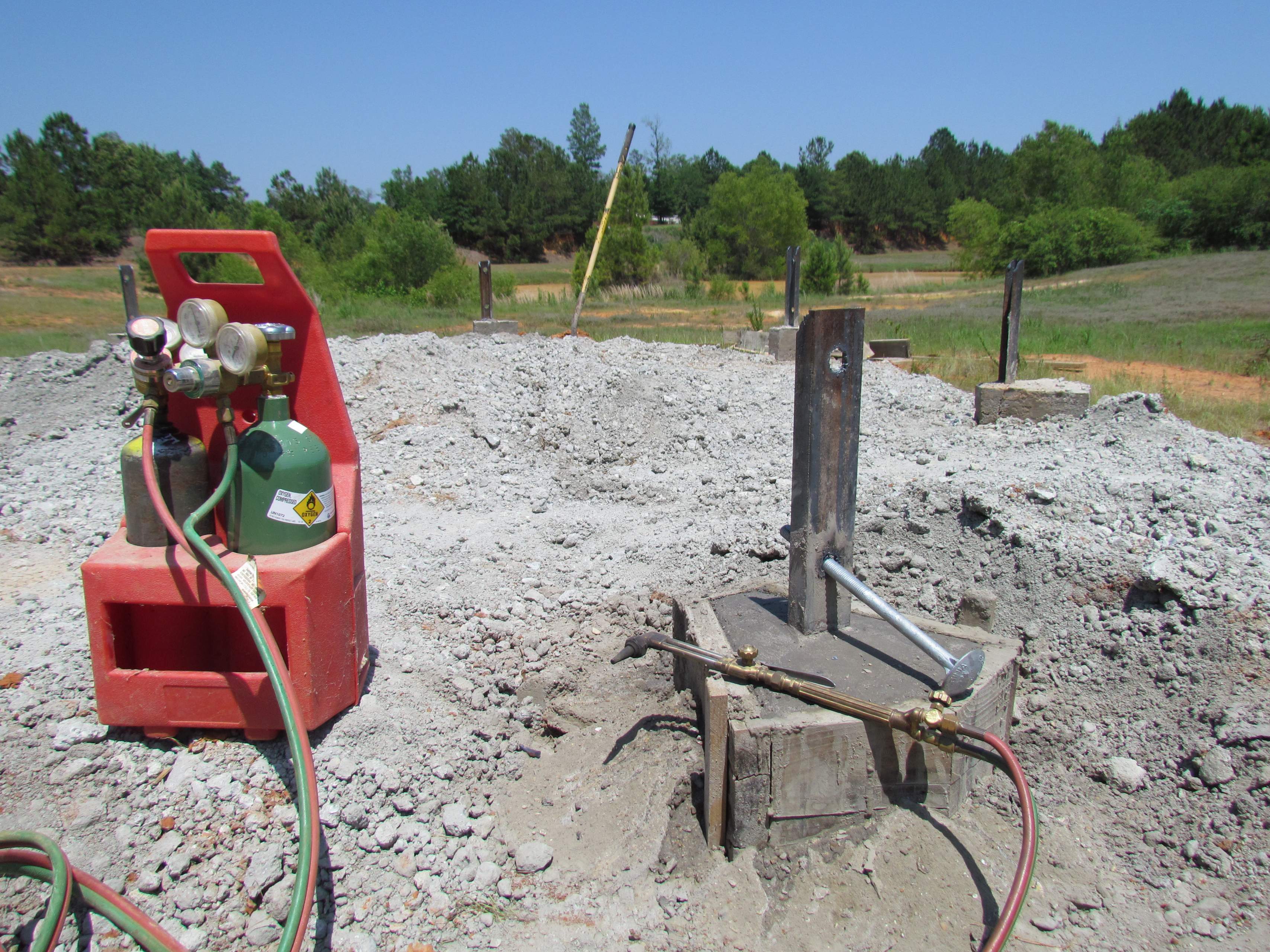

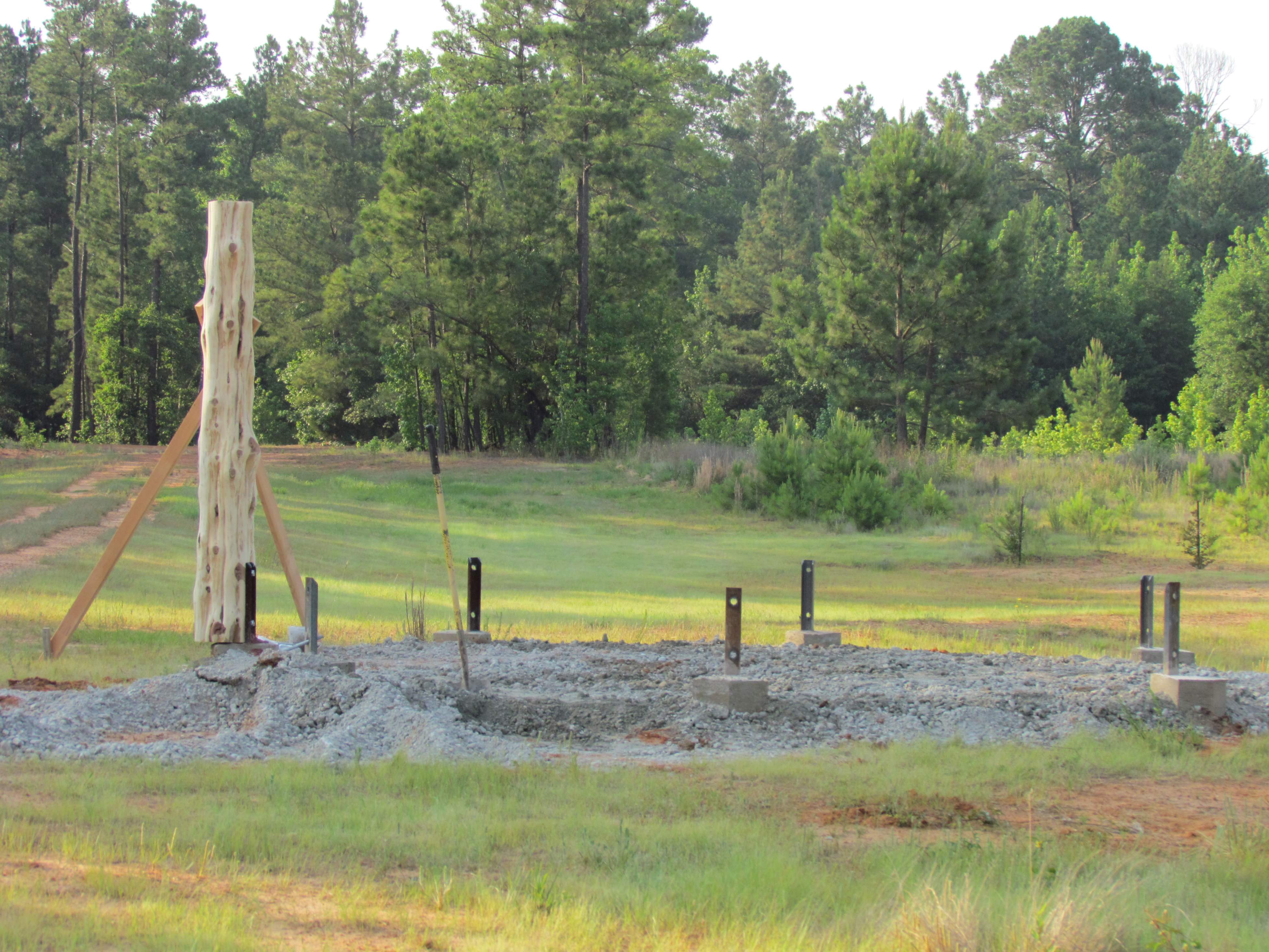

OK, now comes the real mystery. The Gazebos are octagonal, but the post footings are pentagonal.
When I come to visit, I will look at this for a long time and then my head will explode.
What is the reason? And I know you have one...
The footings are shaped to form an octogon on the outside edge. I brought the form back so it would be behind the C Channel, then ended it to create the five sides. If you draw a line from the outside tip of each footing, you get the Octogon shape of the gazebo.

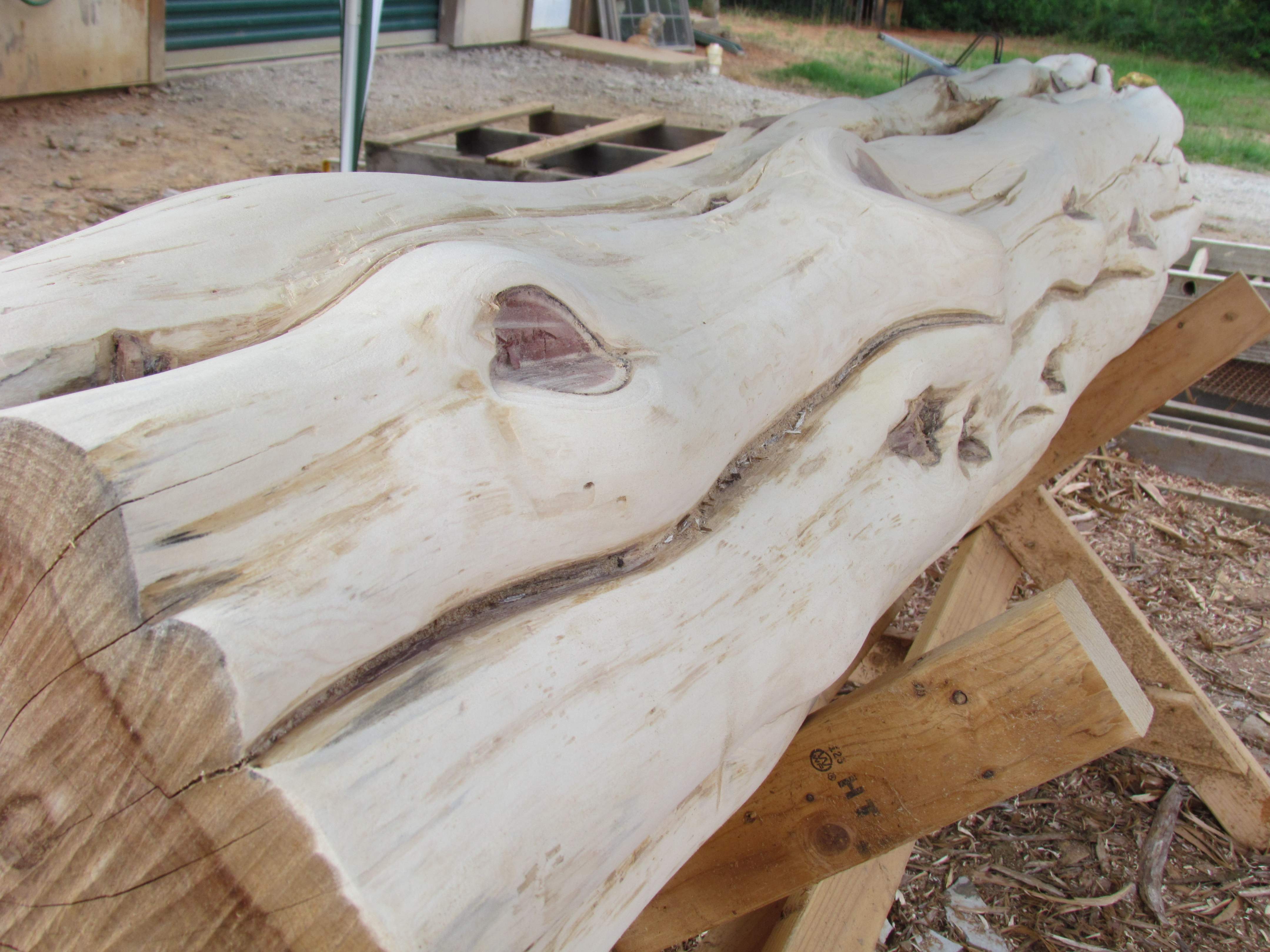

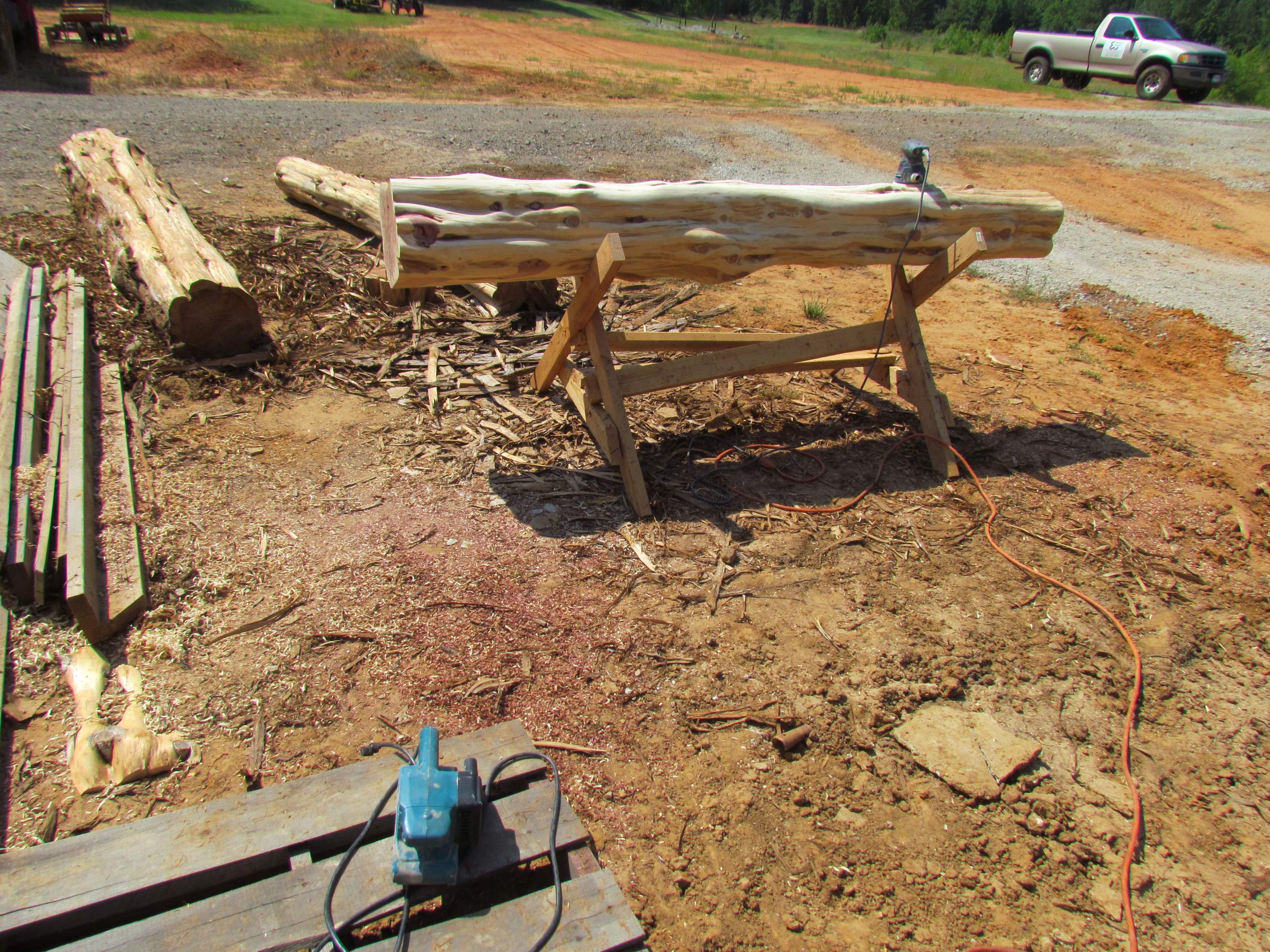

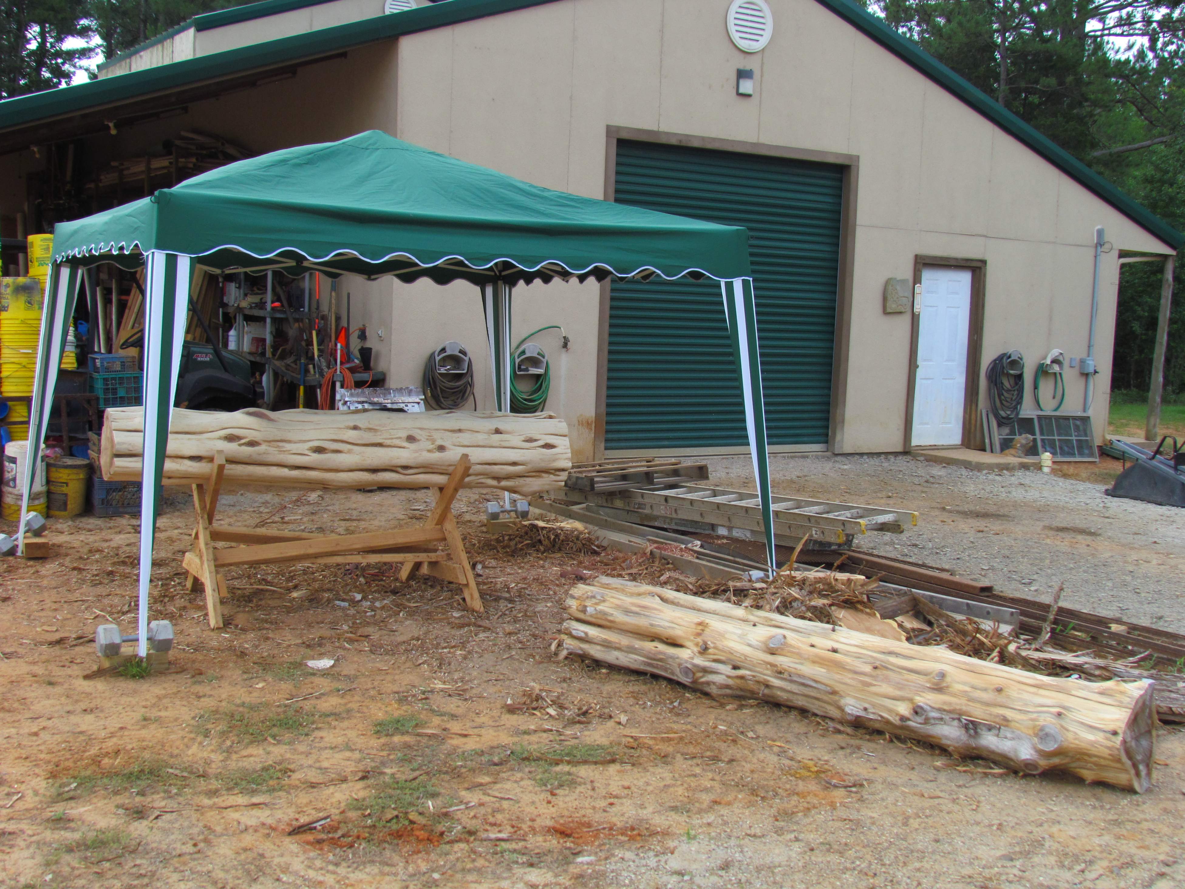

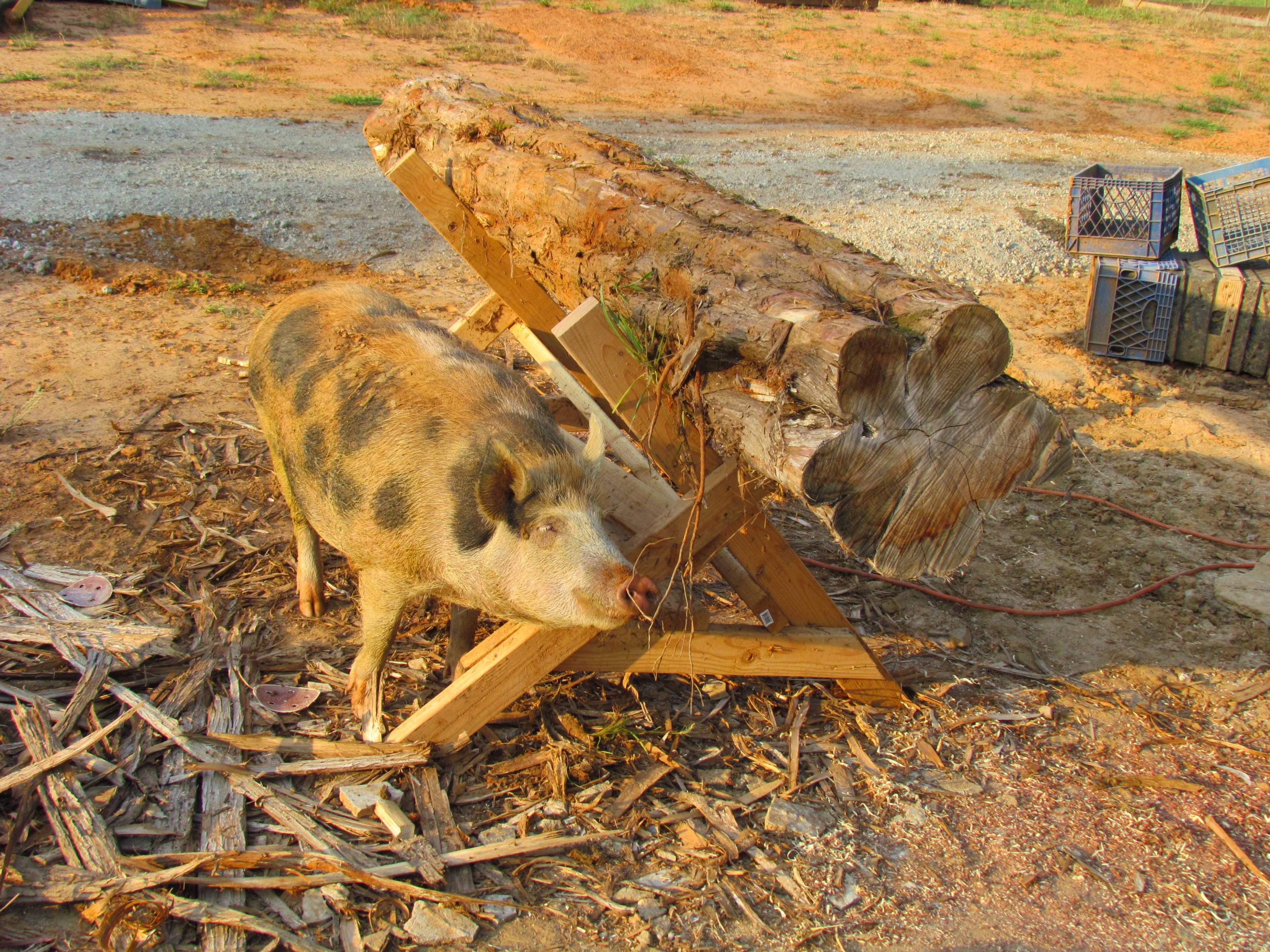

I built a stand to hold the logs, and started peeling bark. My Dad tried using the pressure washer, which did an OK job at getting the looser bark off, but it wasn't very good overall. A chisel works the best, but its slow going and kind of obsessive. Once you start, it's hard to stop!!!
Oscar likes to check out anything new, so he's always underfoot for a little bit, then he loses interest and goes off to play with the cat, or roll in the mud.
After the bark is removed, I cut it to 8 ft long and cut one side on the bottom so it's square. I need it to line up with the C channel, so it has to be flat for about 18 to 20 inches.

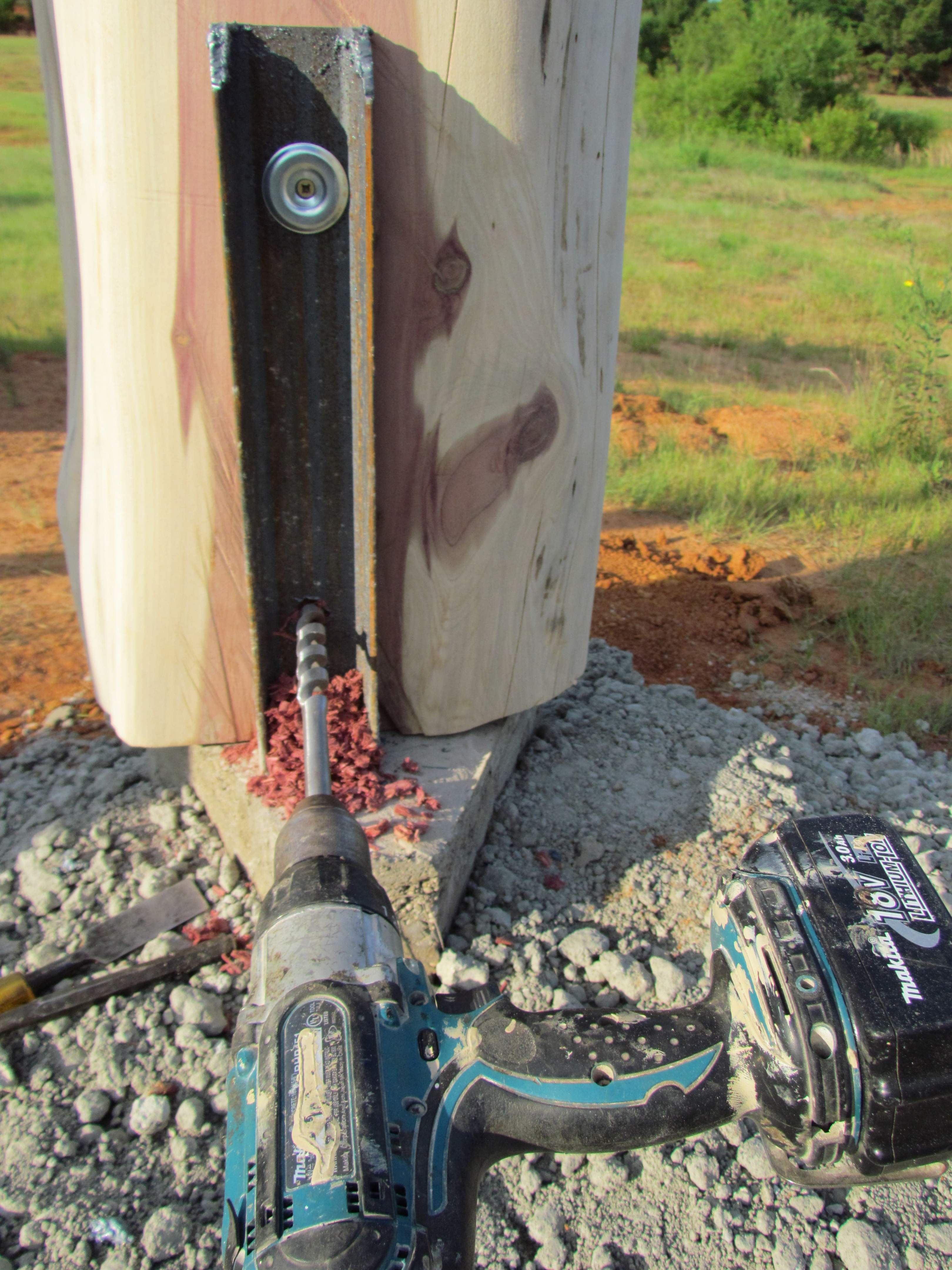

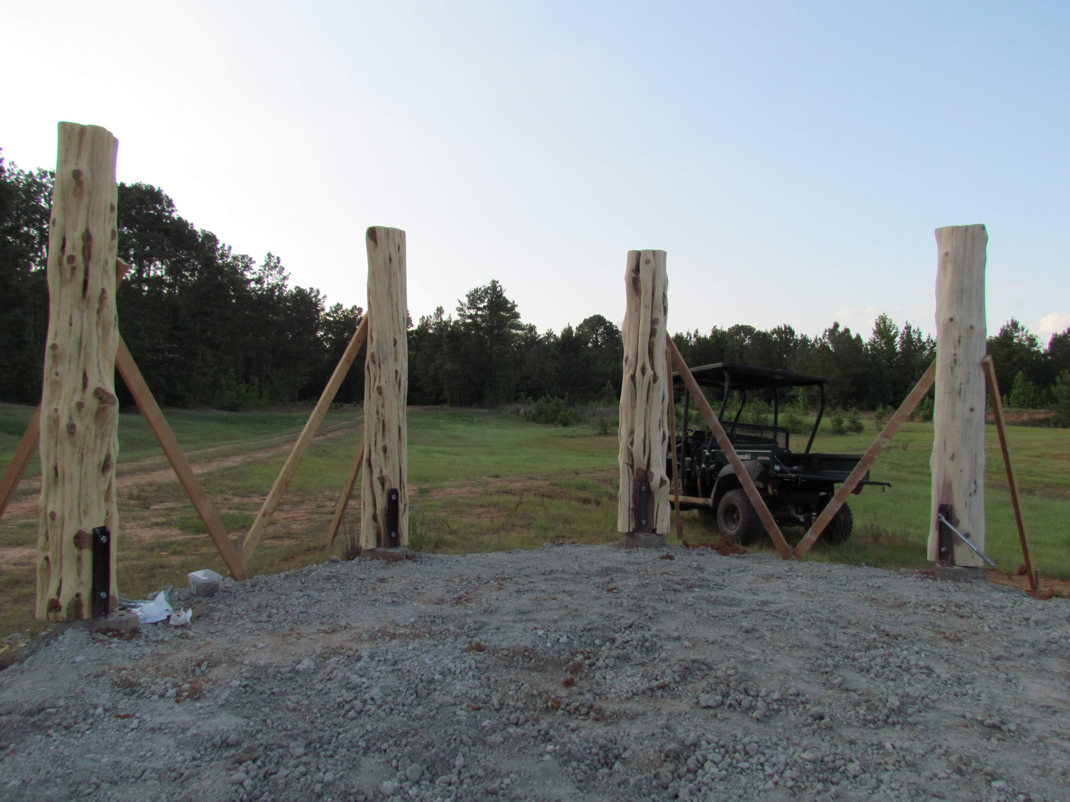

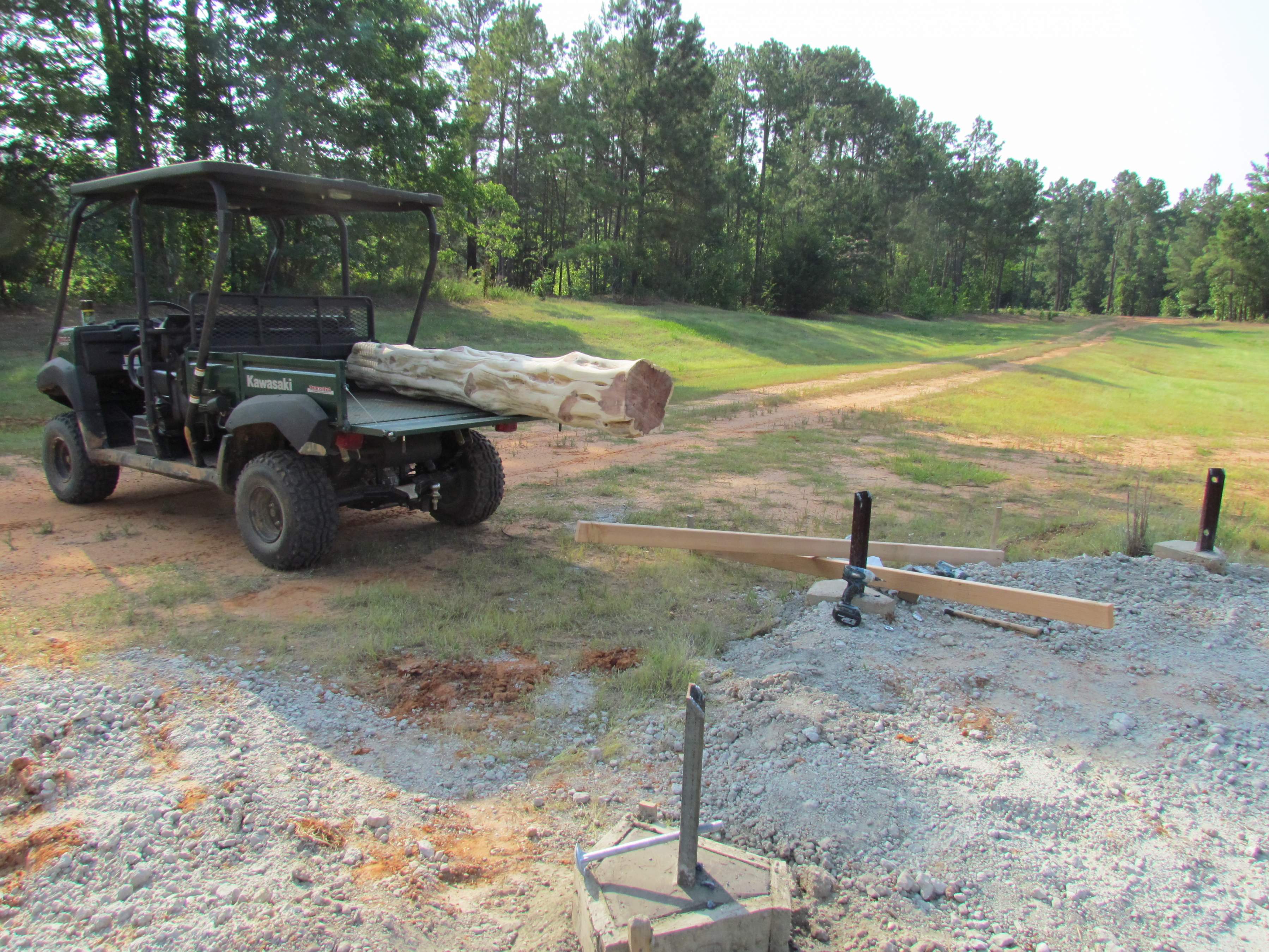

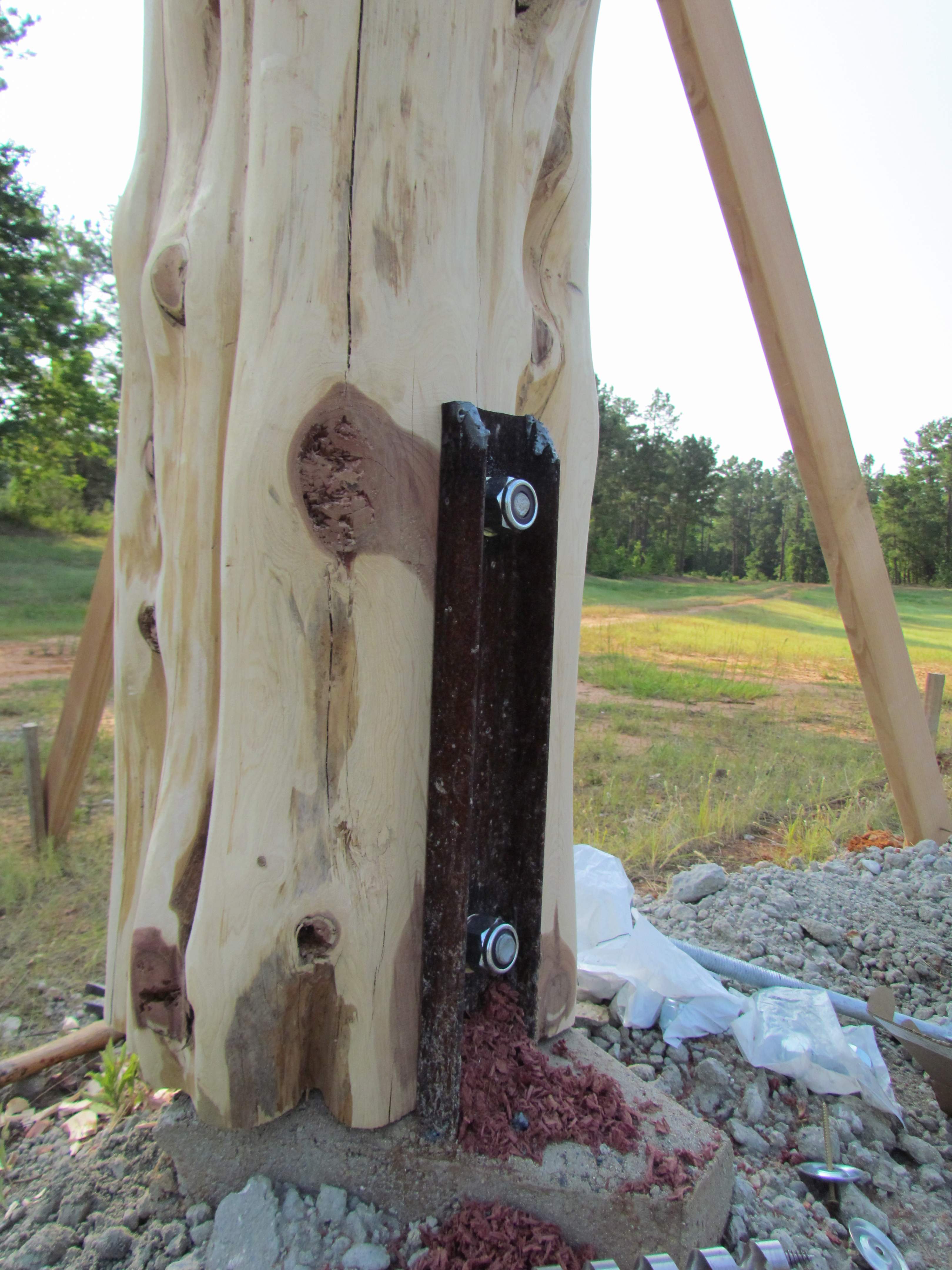

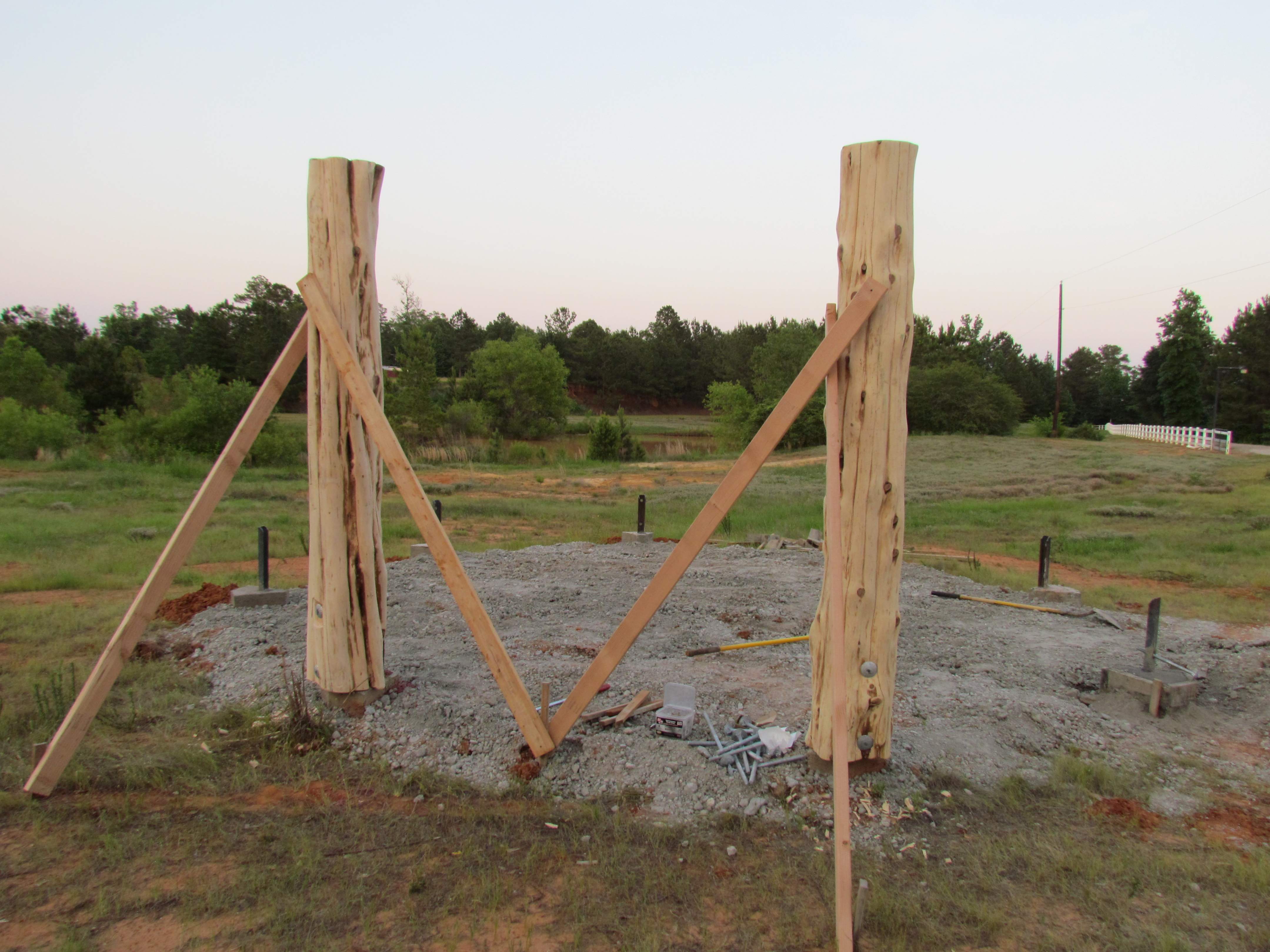

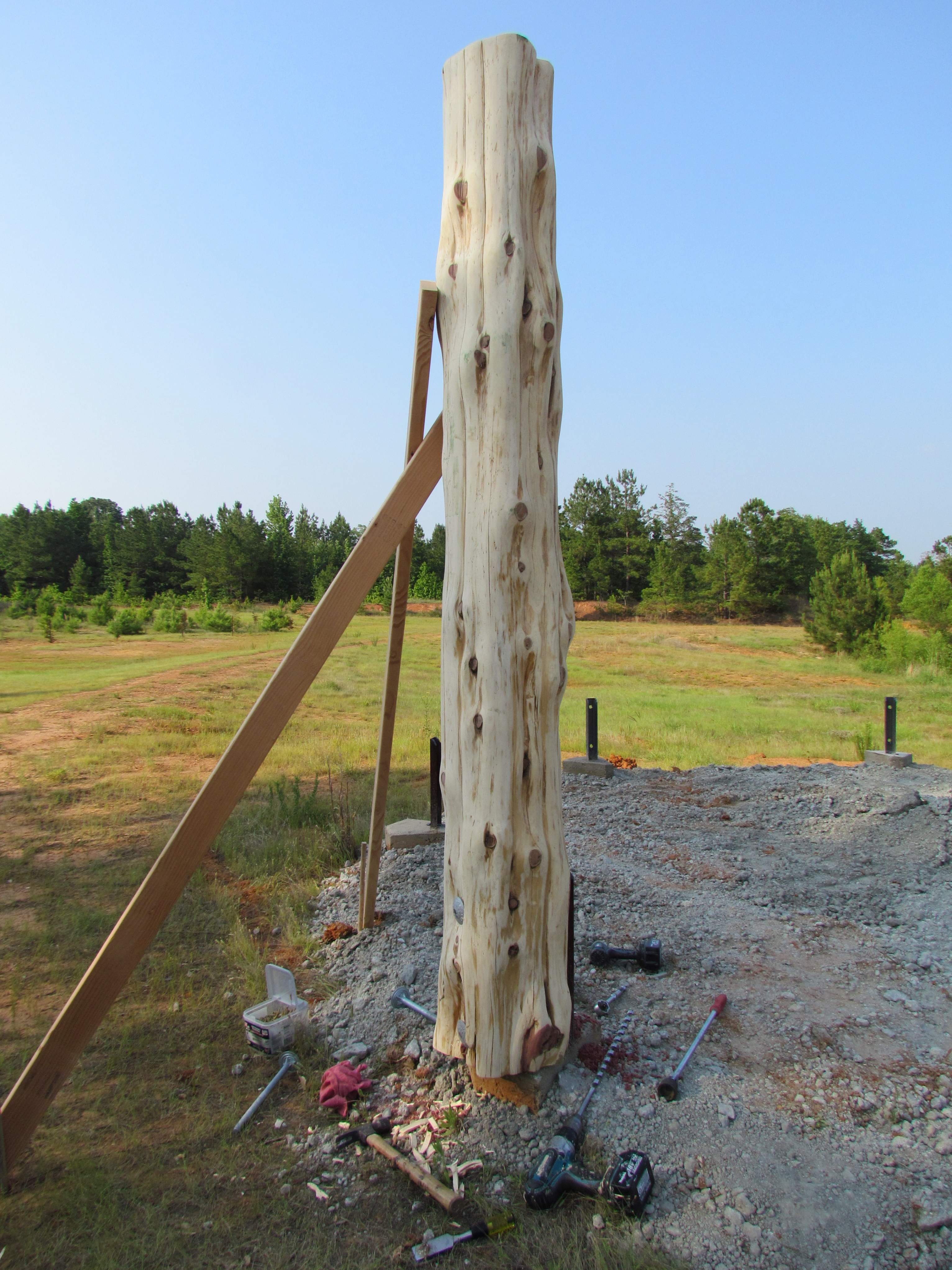

Before I could install the post, I needed to drill the holes into the C Channel for the 3/4 inch bolts. I used my special drill, which made it fast and easy.

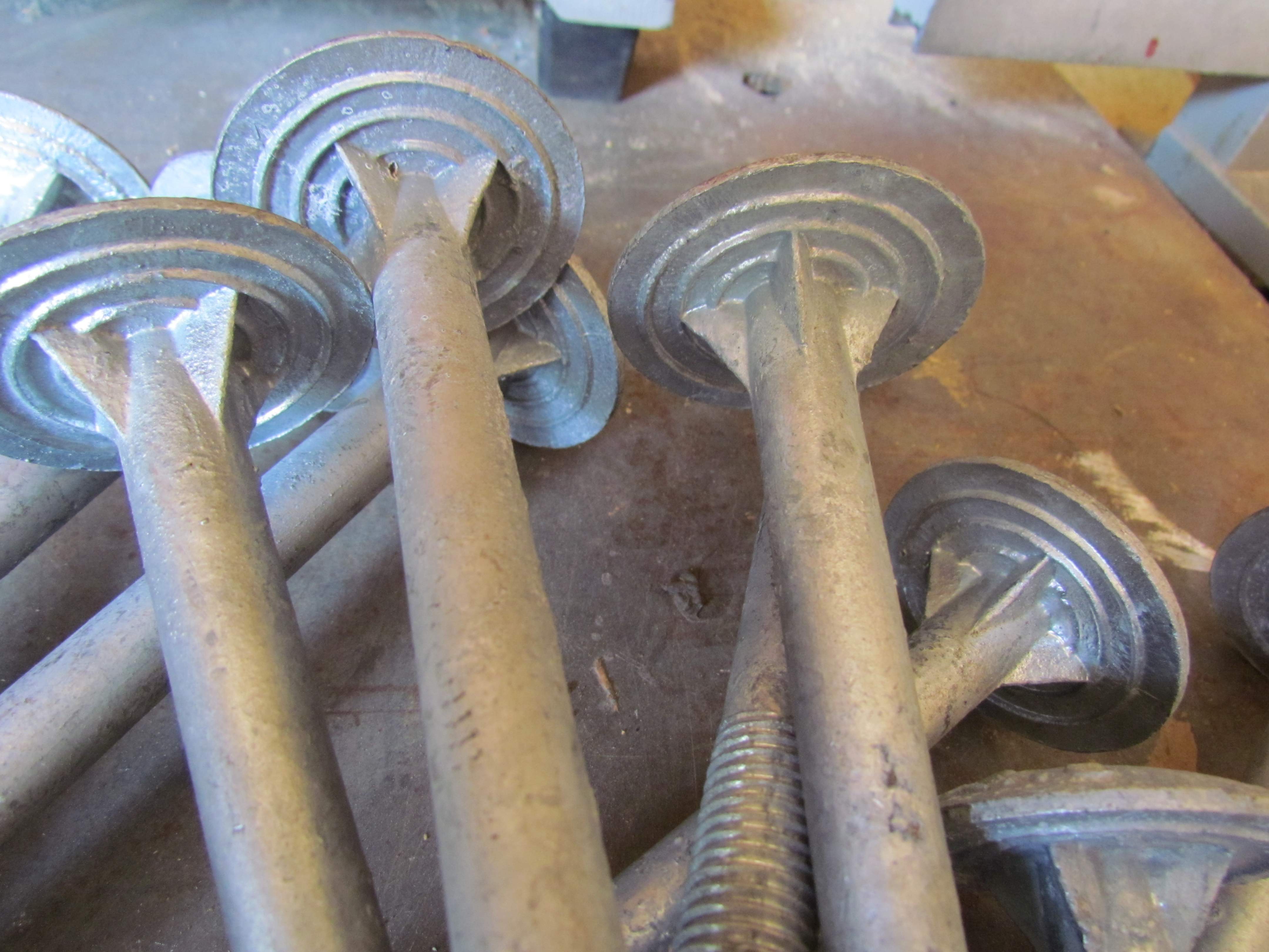

The bolts are designed for logs and have a special head on them that is easily twice as big compared to a carraige bolt. These are 3/4 in by 12 in long.
I used the Mule to carry the log to the gazebo site. Then I just tilted it up!!! I had the braces already screwd to the stakes, so it was real easy to attach them once the post was where I wanted it.
With the post locked into position, I drilled the 3/4 in holes through the logs from the hole in the C Channel. To get the head to be flush, I had to chisel around the hole to create a flat area for the head of the bolts.
I bought nuts with nylon inserts in them, which went on fairly easily with a 1 1/4 inch socket. I then put my breaker bar on it and really put some pressure on it to get it as tight as I could.
One log done, seven more to go!!!

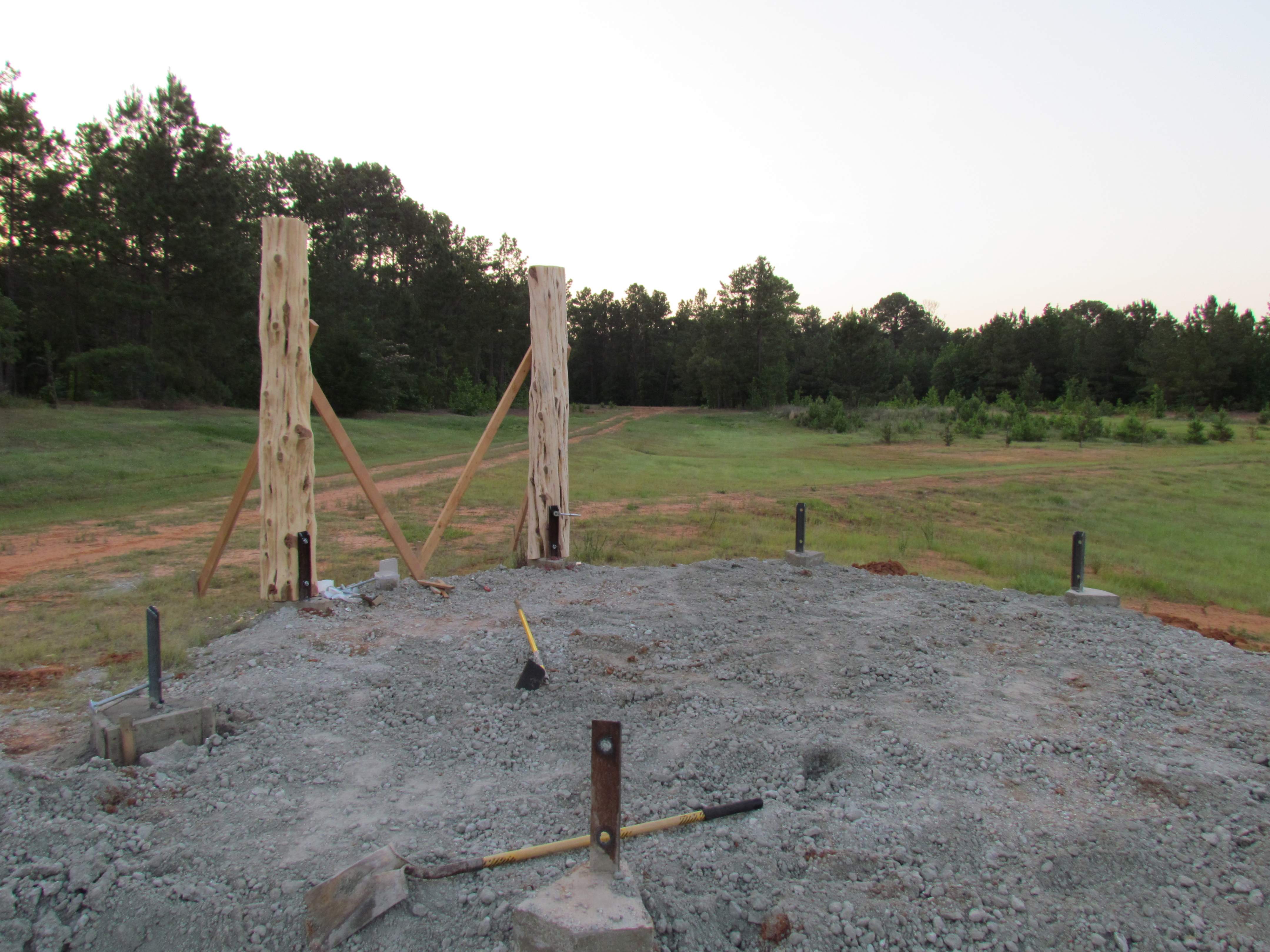

He has a friend now.

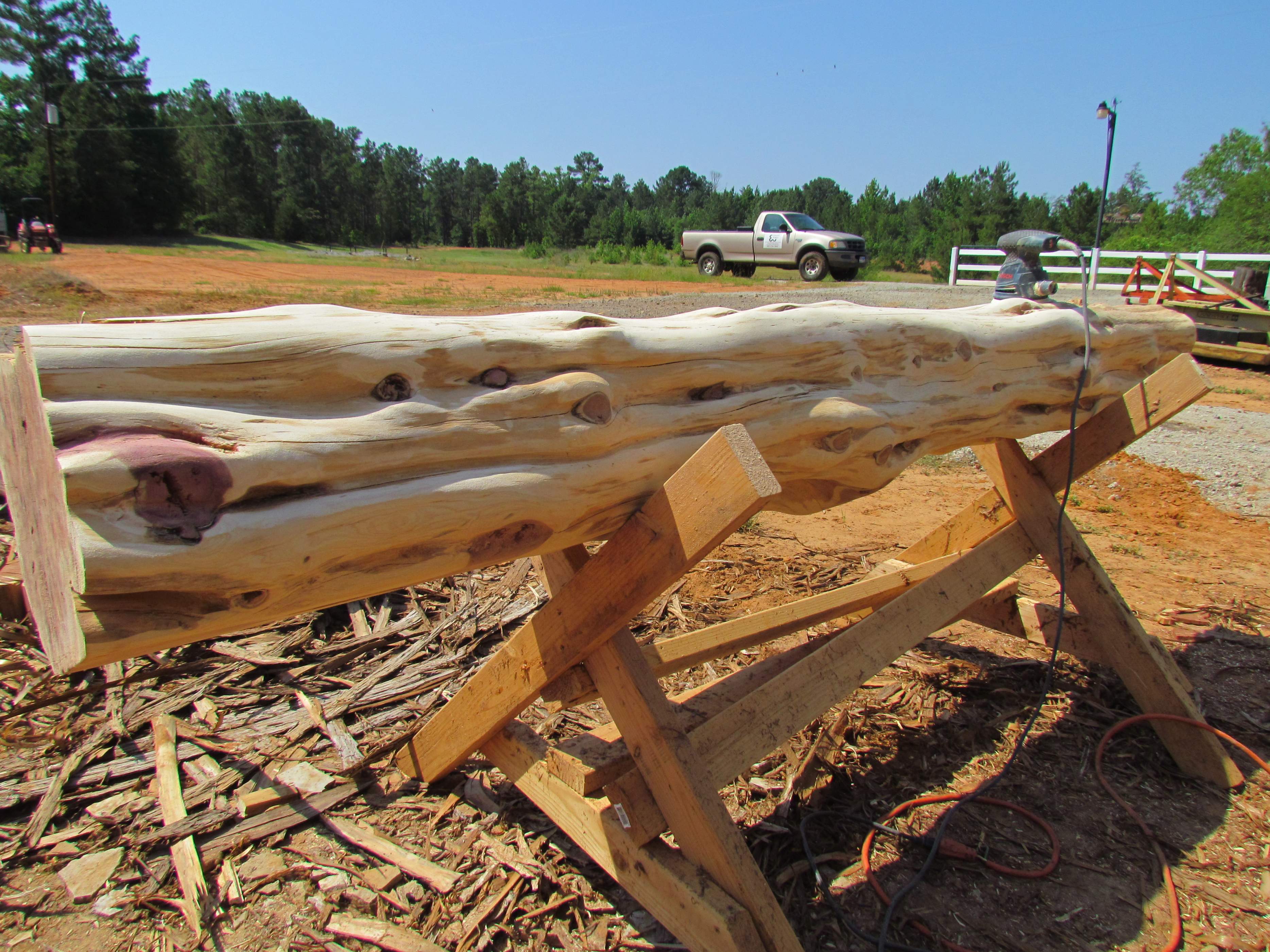

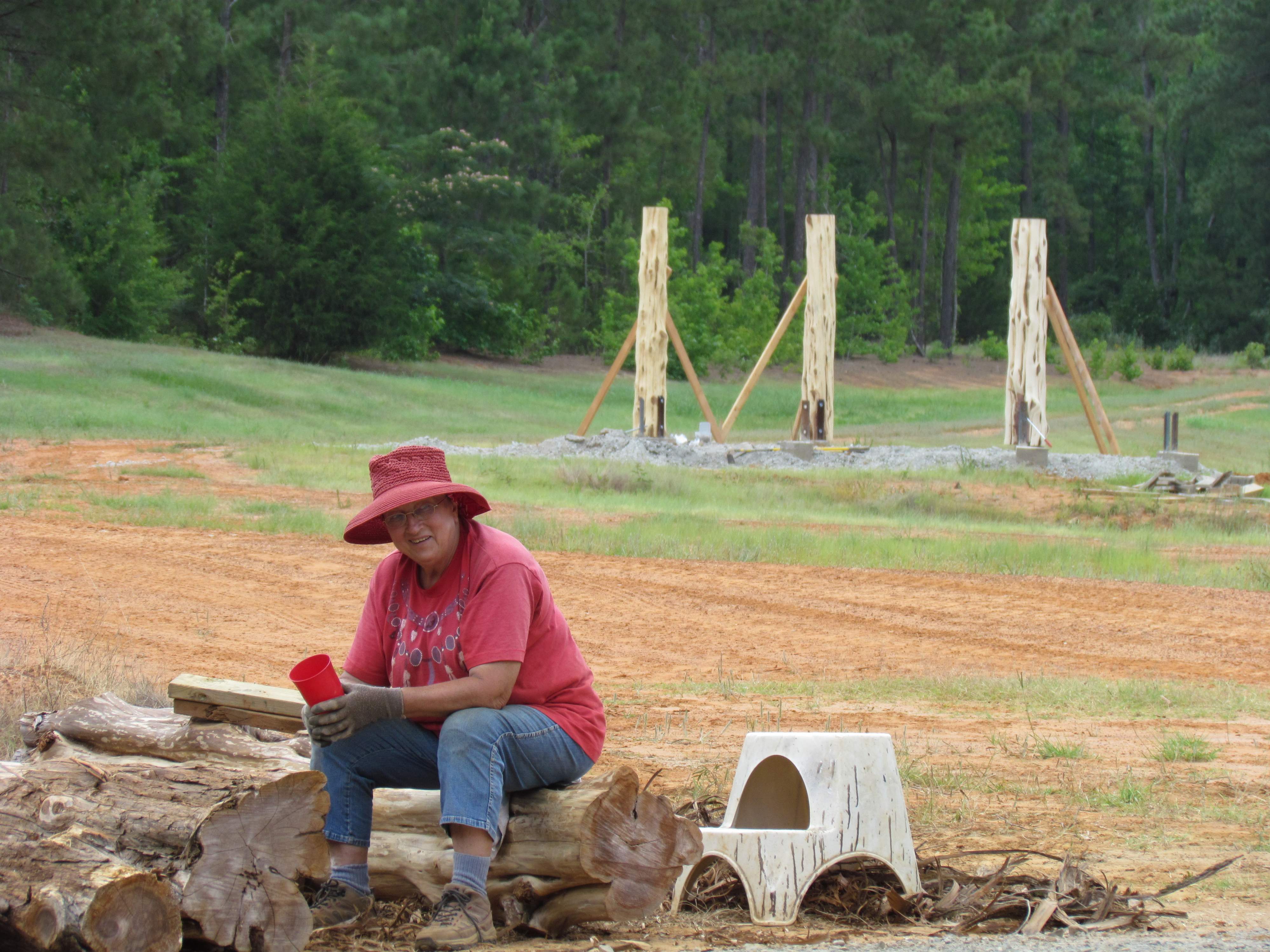

The process of cleaning off the bark, then sanding and shaping the logs is taking quite a bit longer then I expected. Each Cedar is unique, and I want each one to be perfect, so I'm going over them with the best sander, then the orbital sander. They are coming out very nice, bit its very time consuming.
Eddie

The draw knives would only work on part of the logs. The problem, and best thing about the cedar logs is that there isn't a smooth or flat surface on them. The more they twist and turn, the better I like them. So far, a sharp 1 1/2 inch chisel seems to work the best at getting the bark off the way I like it.

I'm up to four logs in place now. It's painfully slow going, but at least it's going. My Mom is helping me with scraping the bark off, which is a HUGE HELP, but the sanding is slow and tedius. The logs themselves pop into position easy enough. Drilling and bolting them is very simple.
Just four more to go, and a full schedule of work. I'm hoping to have them all in by the end of the weekend, but I'm not promising anything!!!! :D
