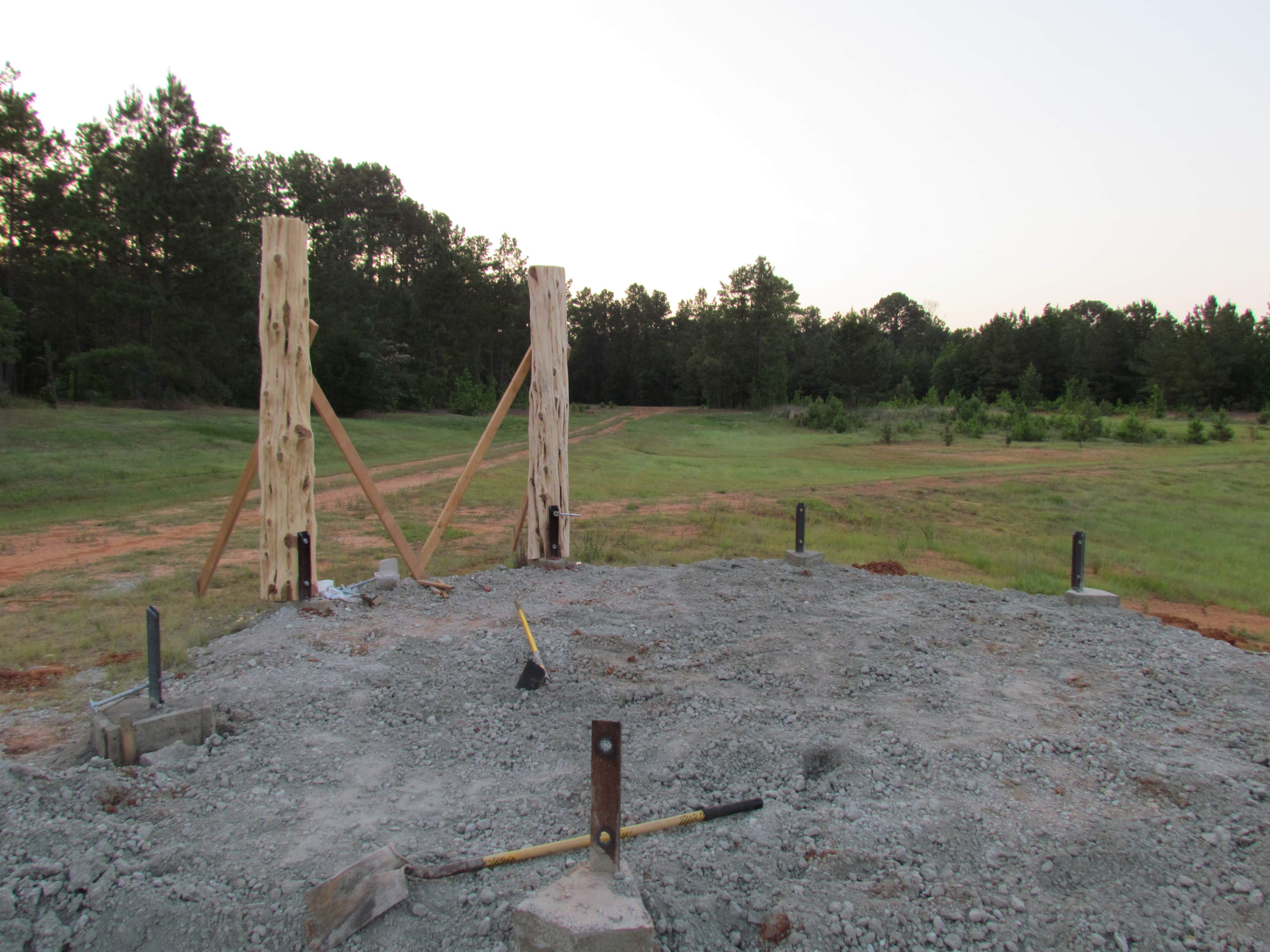

Dennis,

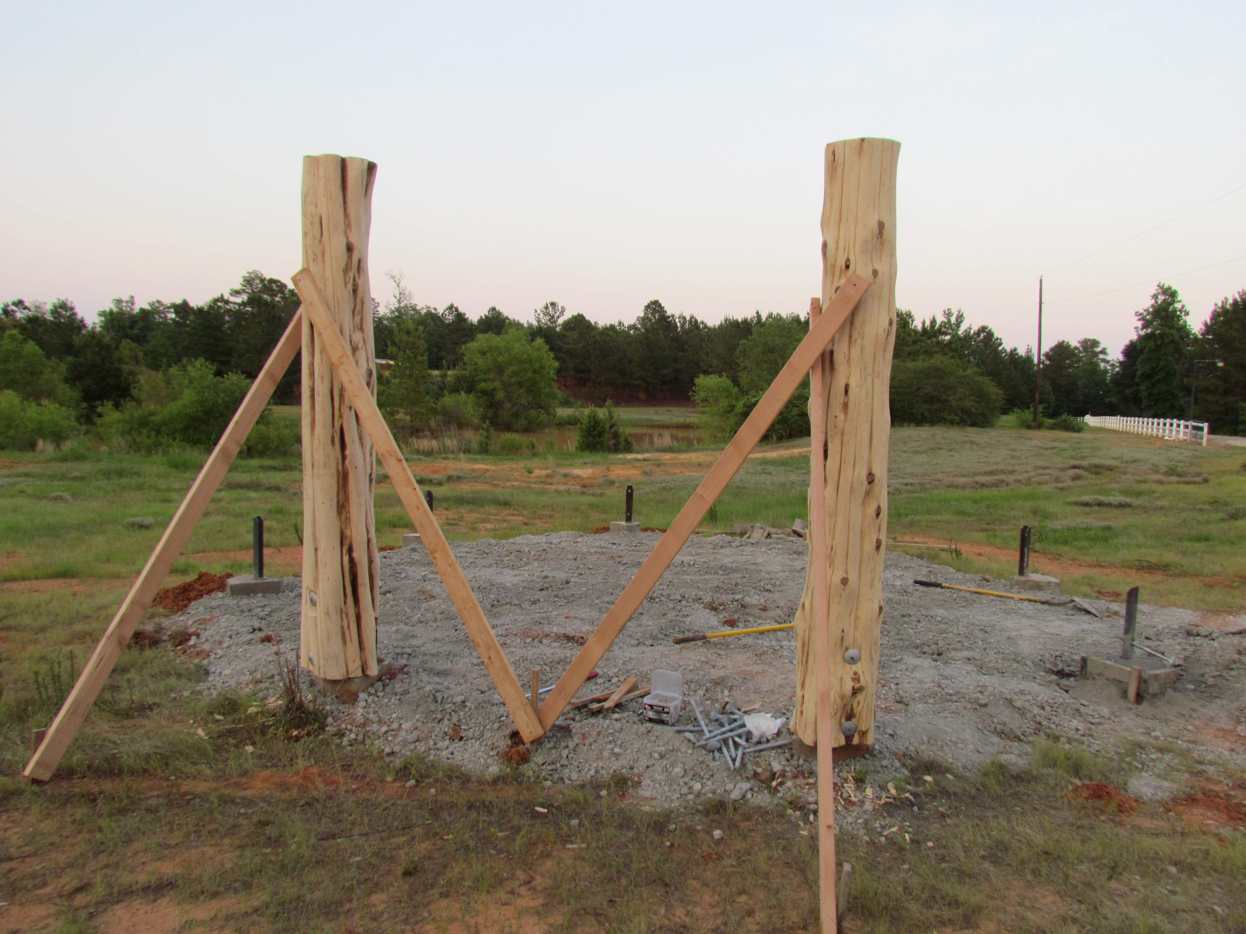

The location is just past where my house is. Or when coming in the future entance road, it will be where the road turns at the end of the front pasture, and just before where the store is going to be. One of the purposes for the gazebo will be for express check ins when the Park opens.
Eddie
/ Gazebo Number One #42
Eddie,
It is looking awesome so far, even with just 4 logs in place.

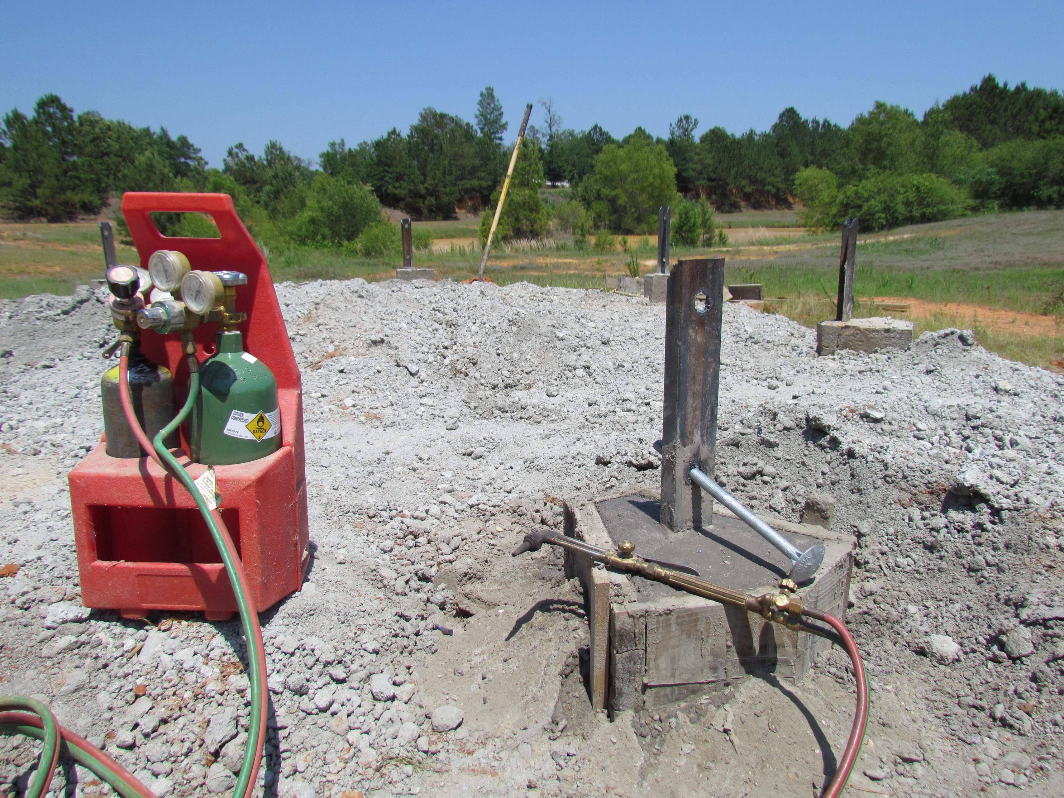

The log home builders cut a notch in the bottom of the logs with a chainsaw and slide the logs over a piece of steel, then drill a hole through the side of the logs and the steel so they can bolt them down. My concern with just sliding the posts over the pipe is that they will move on you. A strong wind will lift a porch off of a building, and fold an eave off the side of a house. Will you have a big parachute that wont make it though a severe wind?
I thought about using sono tubes, but got the idea to build the wood frames because of my plan to use brick pavers. I thought that it would look nicer to have the straight lines. Having done it this way, I now think that a sono tube would have been better and will use them on my next gazebo.
I'm really liking my C Channel approach. Each one is five feet long with five sacks of concrete in each hole. They are solid and easy to work with. I even like the look of the bolts, but then that's probably just me.

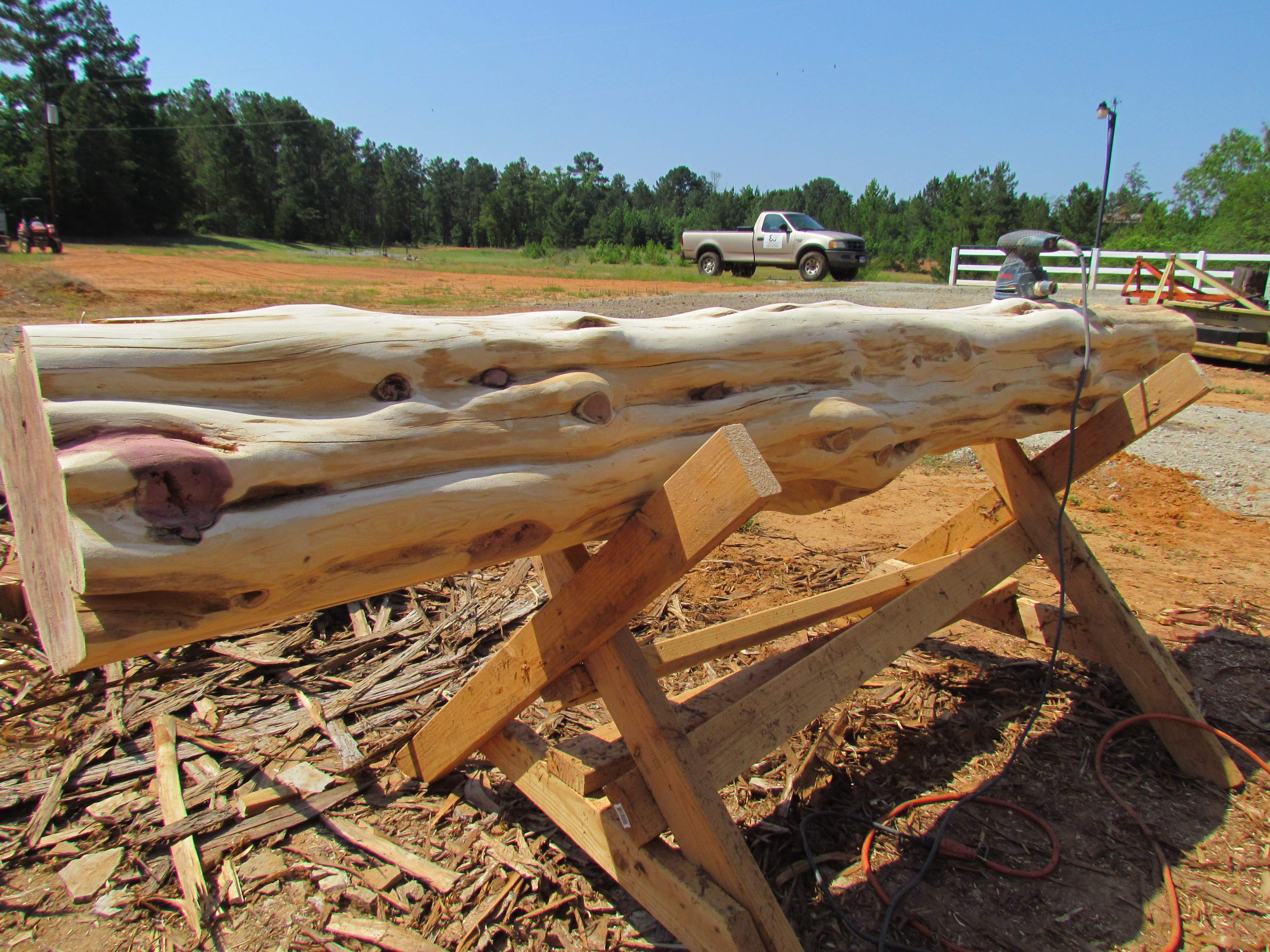

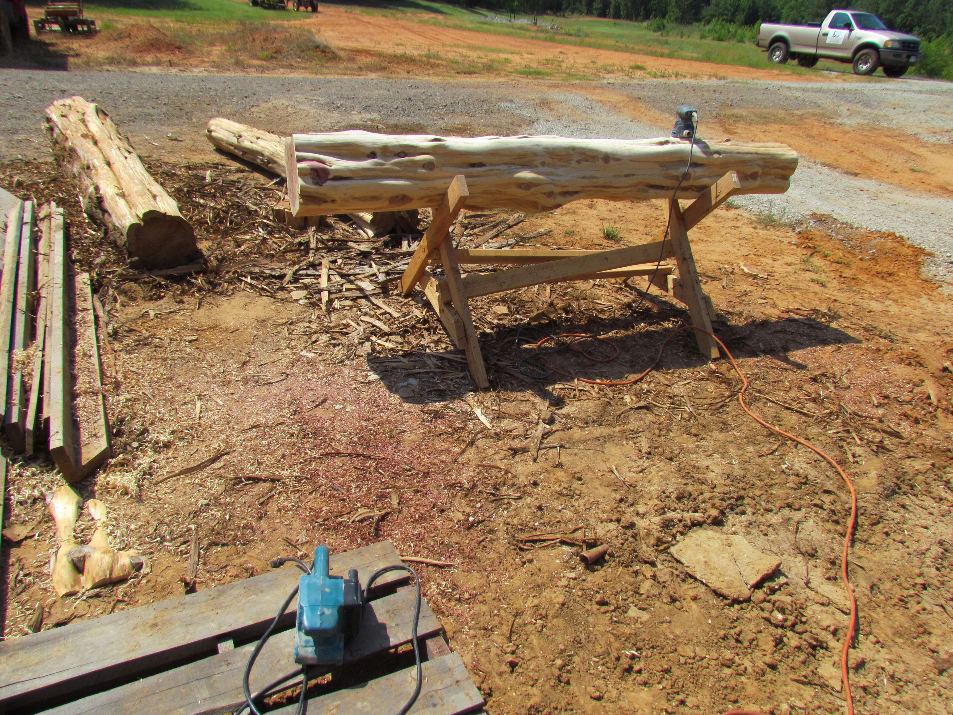

/ Gazebo Number One #49
Energy? what is that? LOL
I'm so wore out from sanding those logs out in the heat that I can't even sit in front of the TV and do nothing when I'm done. 97 degrees and hour after hour of sanding just plain wears me out!!!!!
Four more logs to go, and I'm looking for excuses to do just about anything else.
Eddie

I ended up working Sat morning finishing off a job for a client, and was able to get long number 5 in place. Sunday was spent at another clients house and then buying feed for Oscar and all his wild friends. Today I'm hoping to get log number 6 done. It takes a full day to peel the bark, cut it to fit with the chainsaw, sand it smooth and install it.
I made the mistake of not going to Home Depot to get the good Norton sandpaper last week, and bought some really bad stuff called Gator from Lowes. Never again. I'll drive twice as far to get the good stuff because those Gator belts just fall apart in about 15 minutes and the discs go smooth just as fast. The blue Norton sandpaper lasts hours and hours!!!!!!

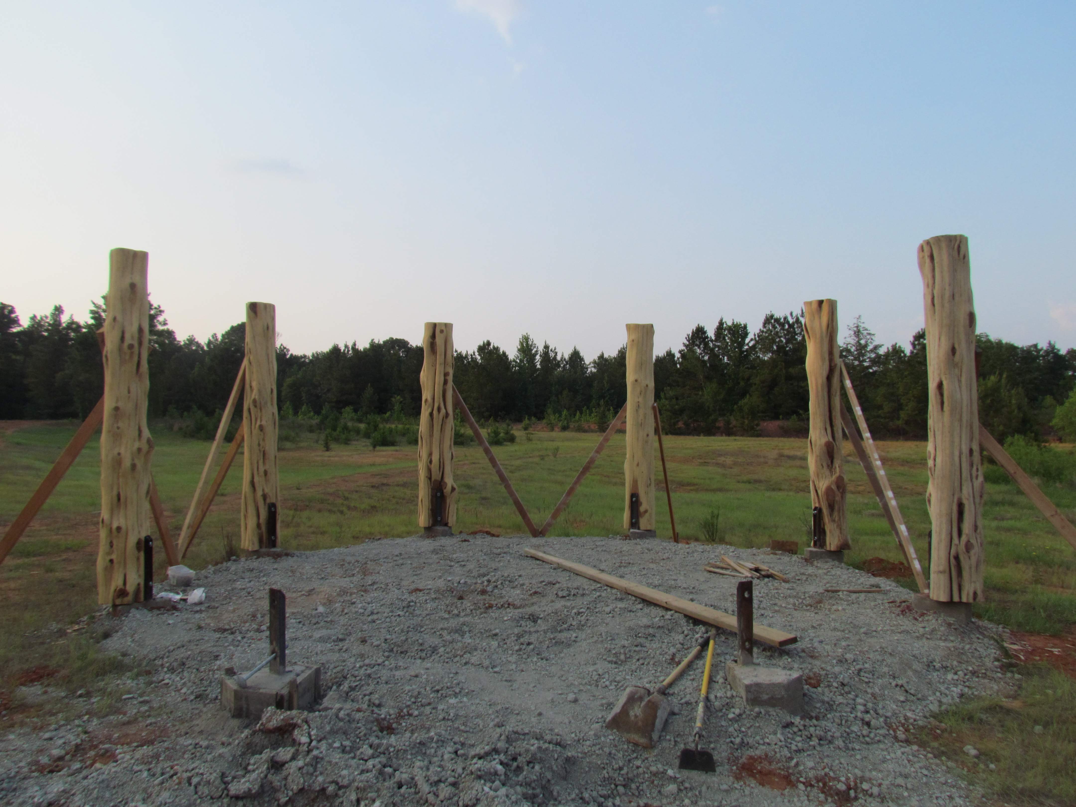

Two more posts up mean that I only have two more to go!!!!! :D

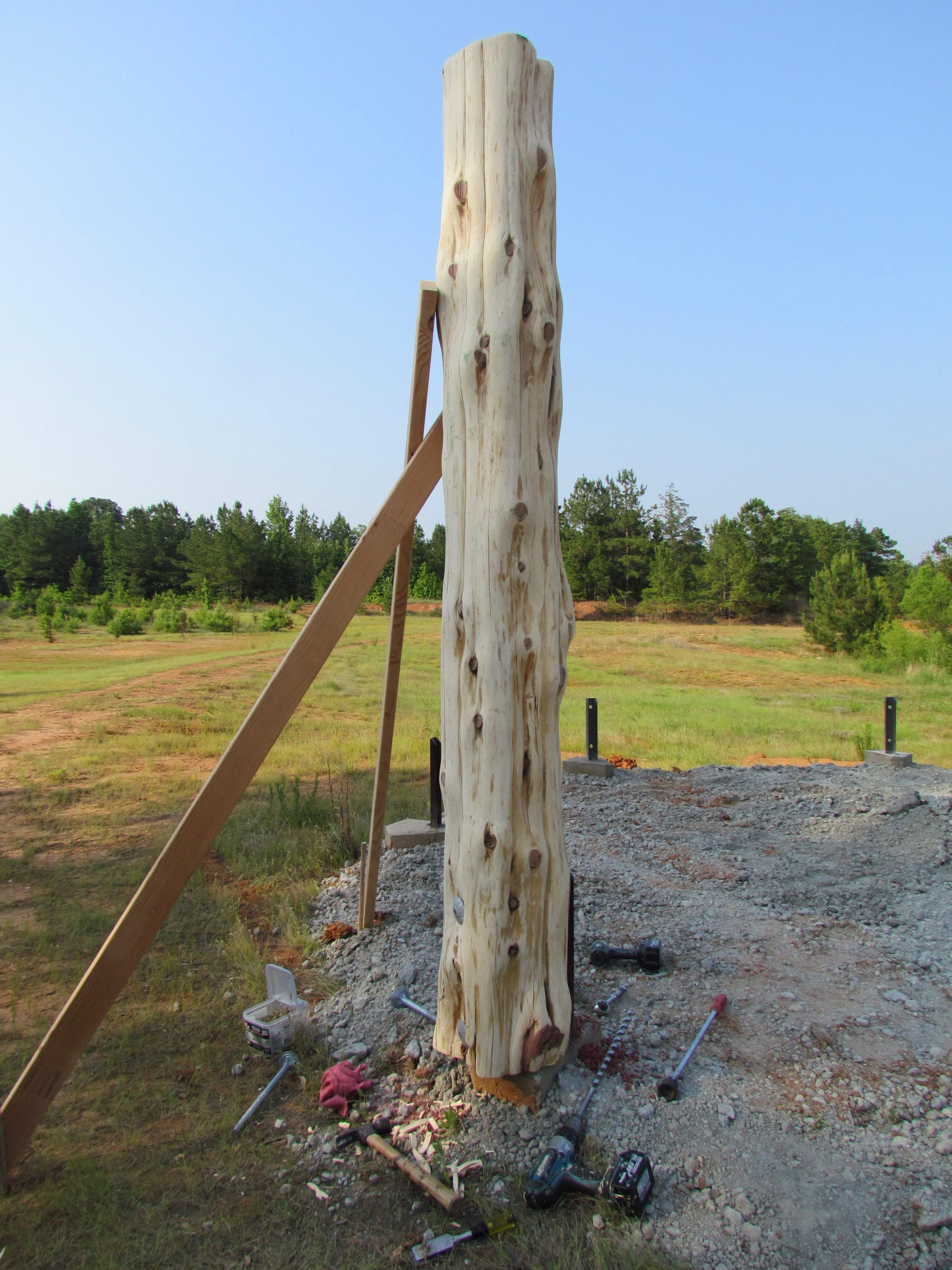

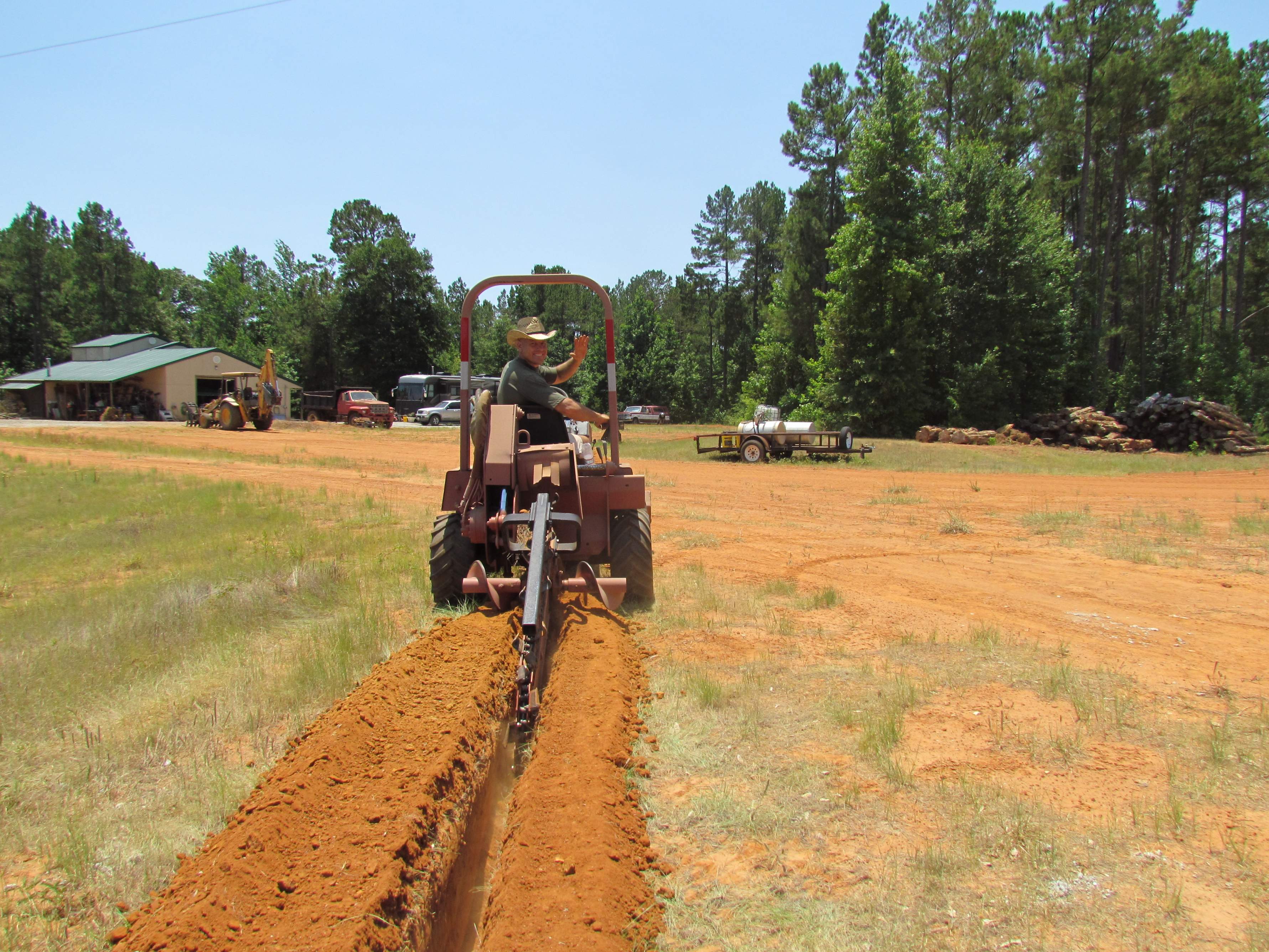

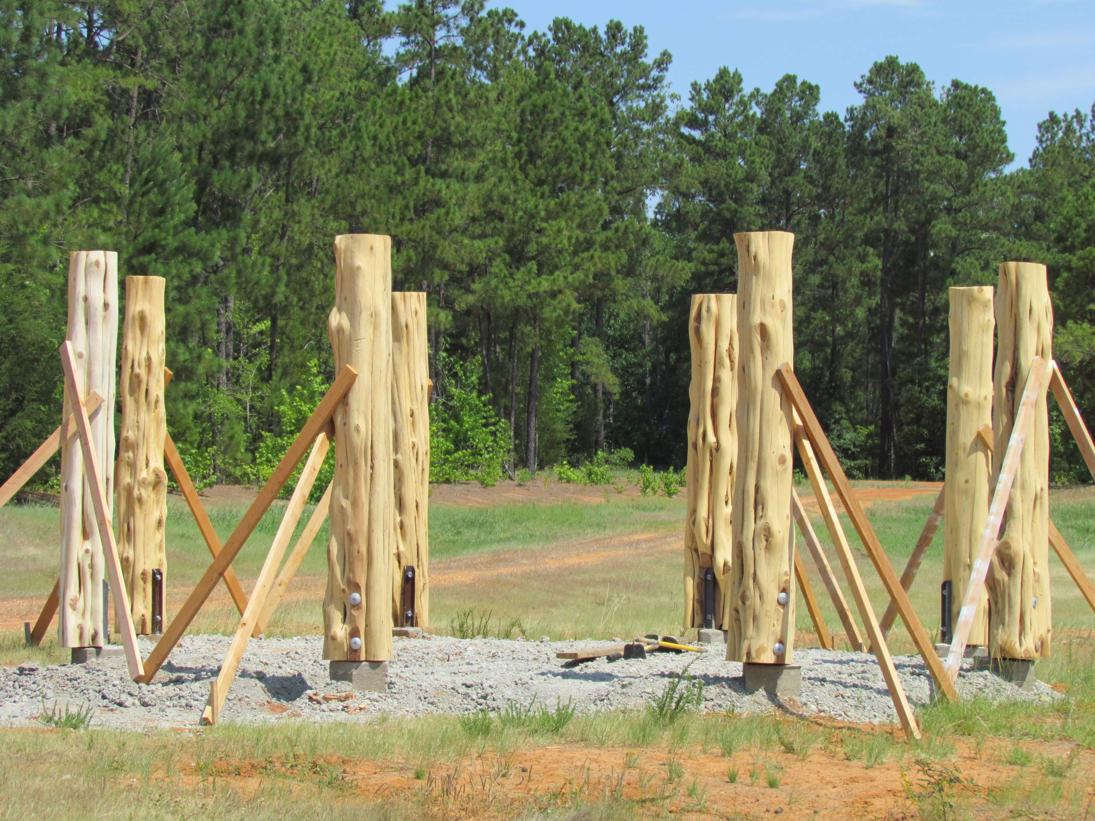

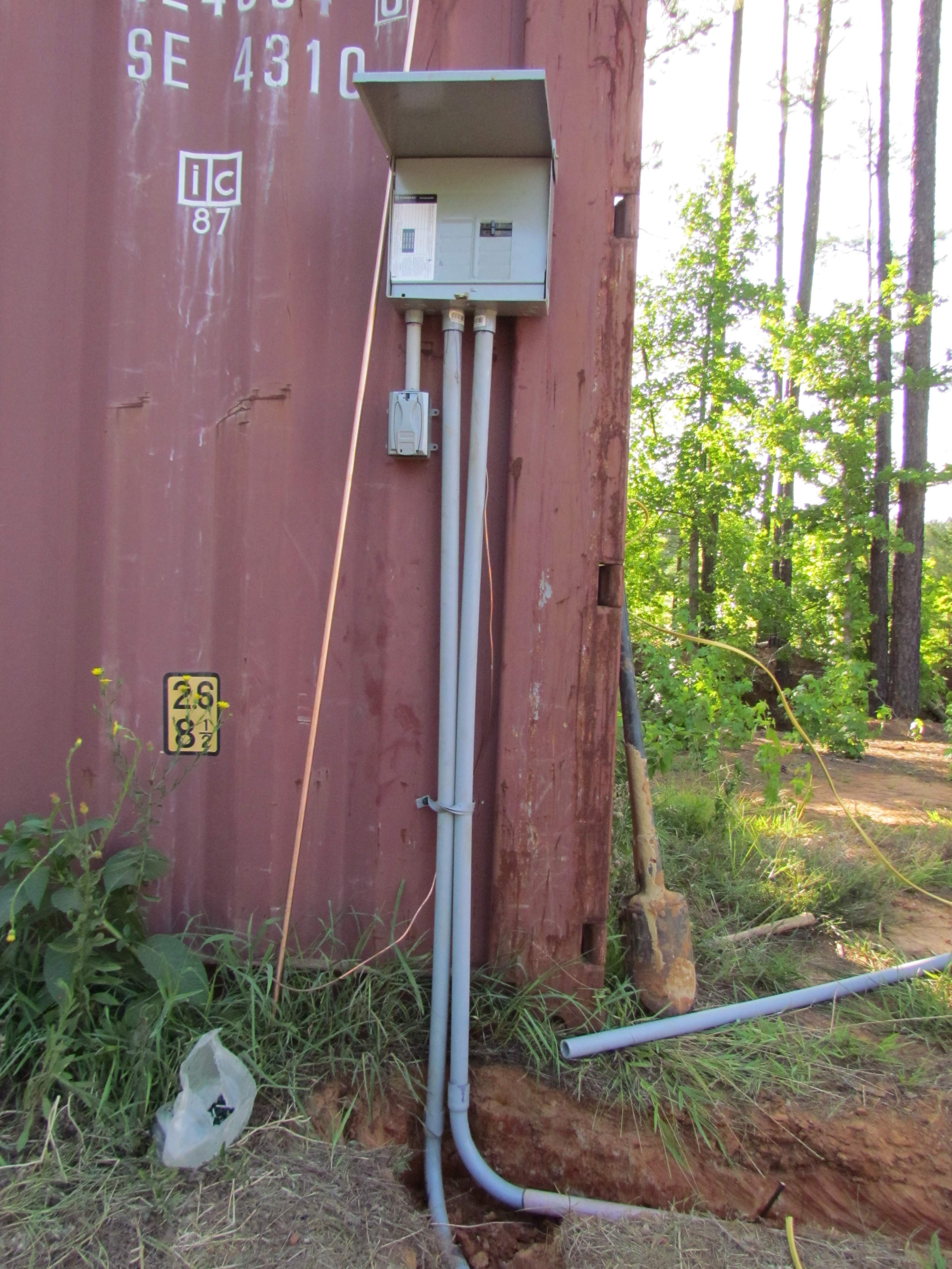

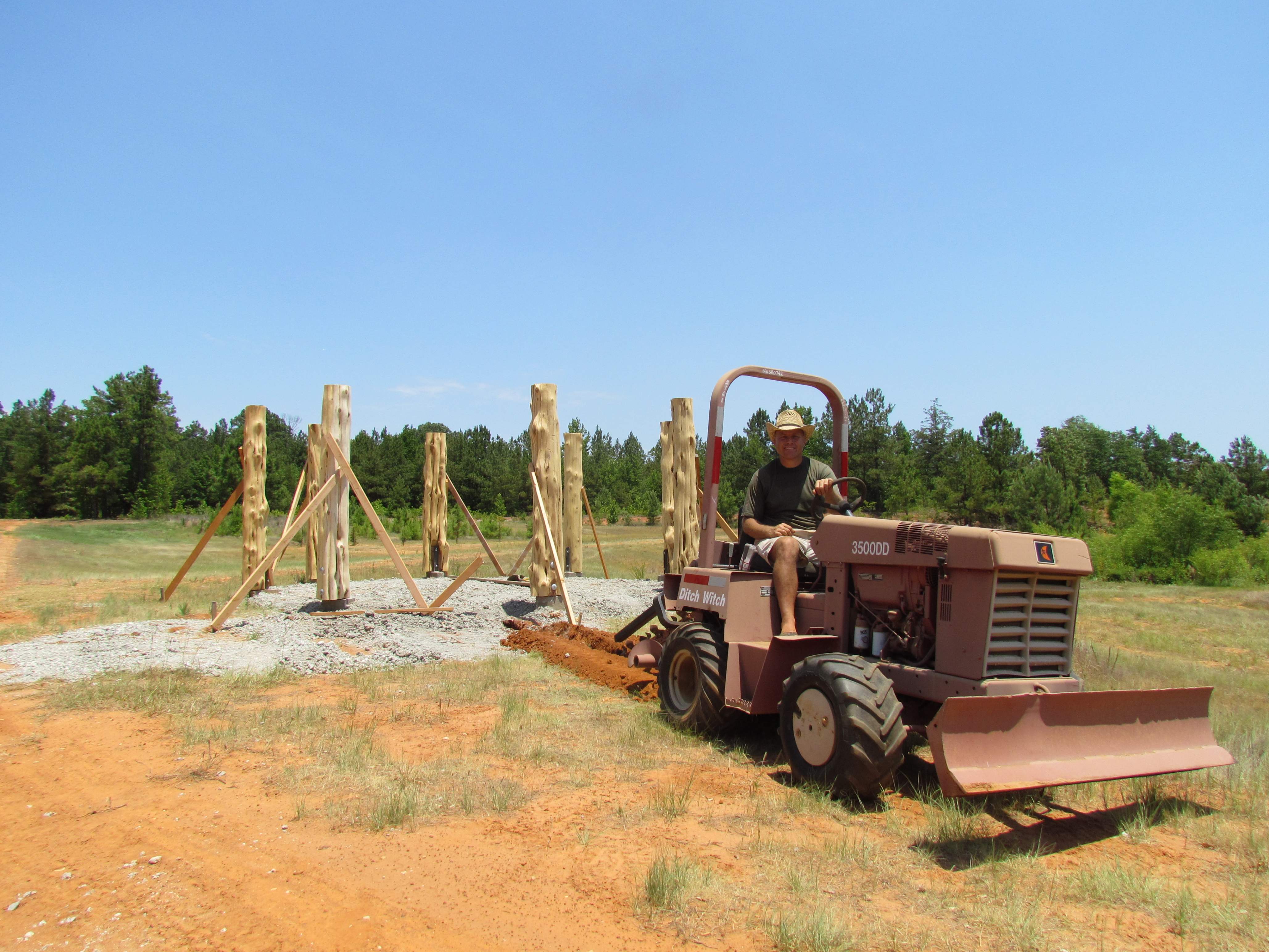

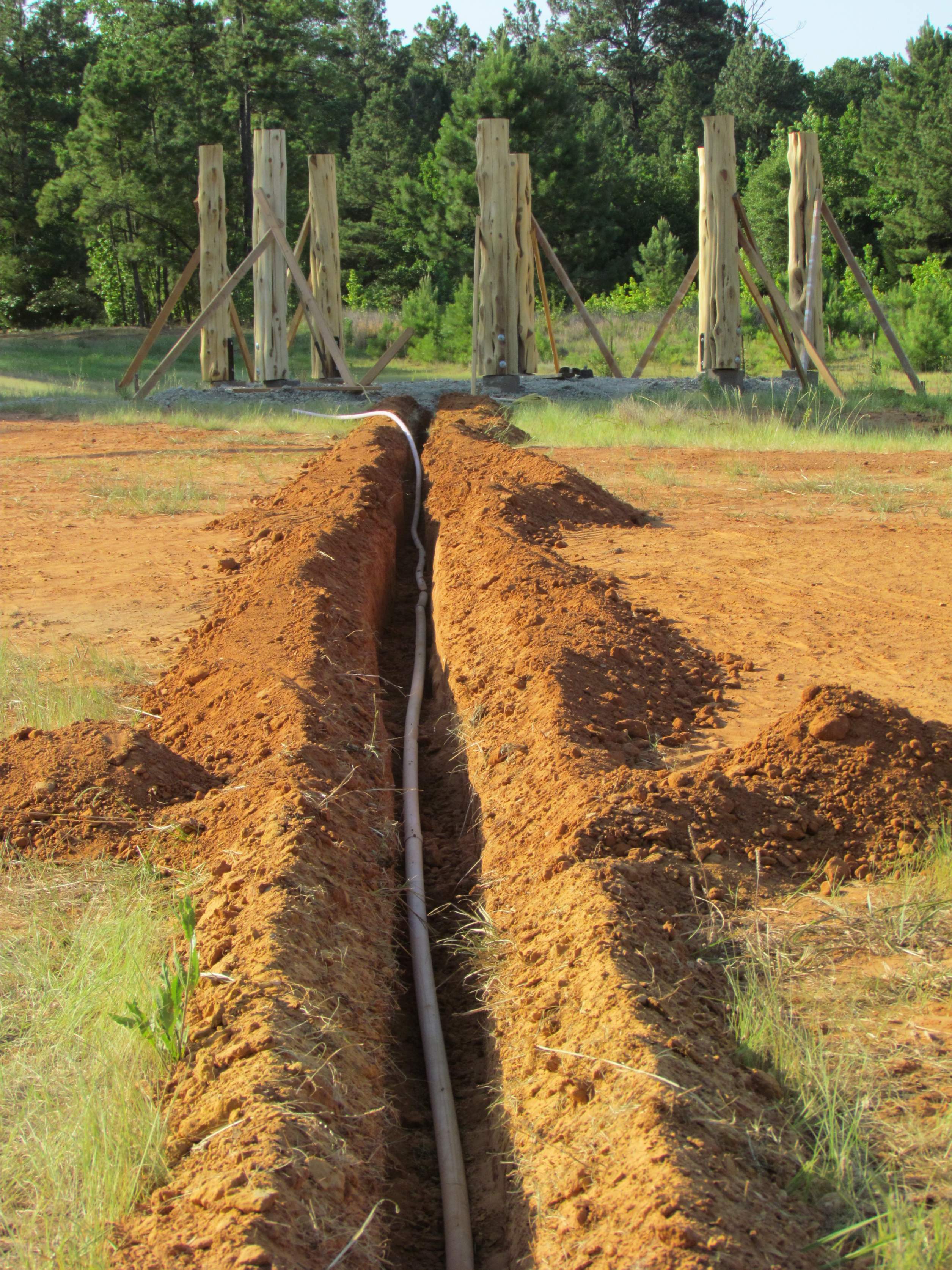

It's taken me longer to finish these logs then I thought it would, but then I'm easily distracted. All 8 logs are up and locked into place.
So for fun, and because it was 105 degrees, I ran power out to it. Back over the winter, I installed an RV Pedistal for my parents RV. I ran 100 amps from my second panel in my shop, out to a 50 amp breaker in their pedistal and sort of quit there. Today I trenched 100 feet to my sea container where I put in a sub panel. Then from there I trenched 230 feet to my gazebo. It has a dedicated 20 amp line for the lights and two outlets.
Eddie

Alright POWER!!! Looks like one of the moles in my yard, that's about the size trail they use:D
Eddie, as soon as you get temp lighting in, you can work nights too:thumbsup:!!! You're having way to much fun, but sure looks good so far.

Eddie,
Is that trencher a rental or do you have a toy I don't know about?:confused:
Good looking gazebo posts.:thumbsup: I can imagine it will be an Awesome sight when finished.:)
