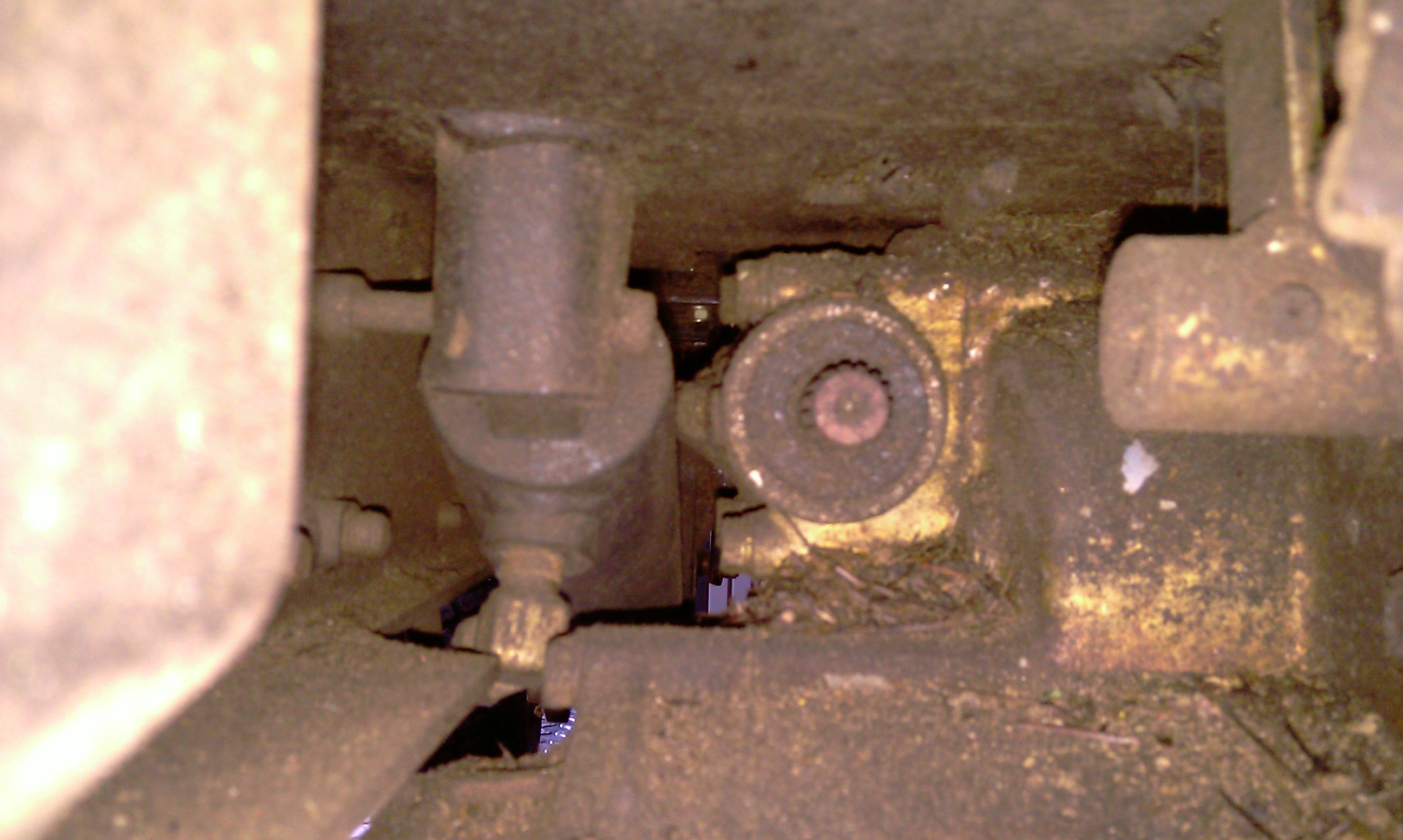

All the YM122, 126, 142, 146 and the GT14's came with hydraulic pumps mounted to the engine and a tank right behind the plastic dash in the engine compartment. The hydraulic piston was underneath the seat. It raised and lowered the mower deck and it also raised and lowered the 3 point hitch, if so equipped.
The only other YM14 I've seen pictures of didn't have hydraulics either. Must have been a European thing.
In this really bad picture, you can see where the lift piston is in relation to the rear PTO drive gear.

mine has a spring loaded "assist" to help lift the deck where the hydraulic cylinder is on your machine. i will post some pics of the huge lever it has to lift the deck. could you post some pics of the pump and soforth as i am interested to see how it all is mounted and located.
