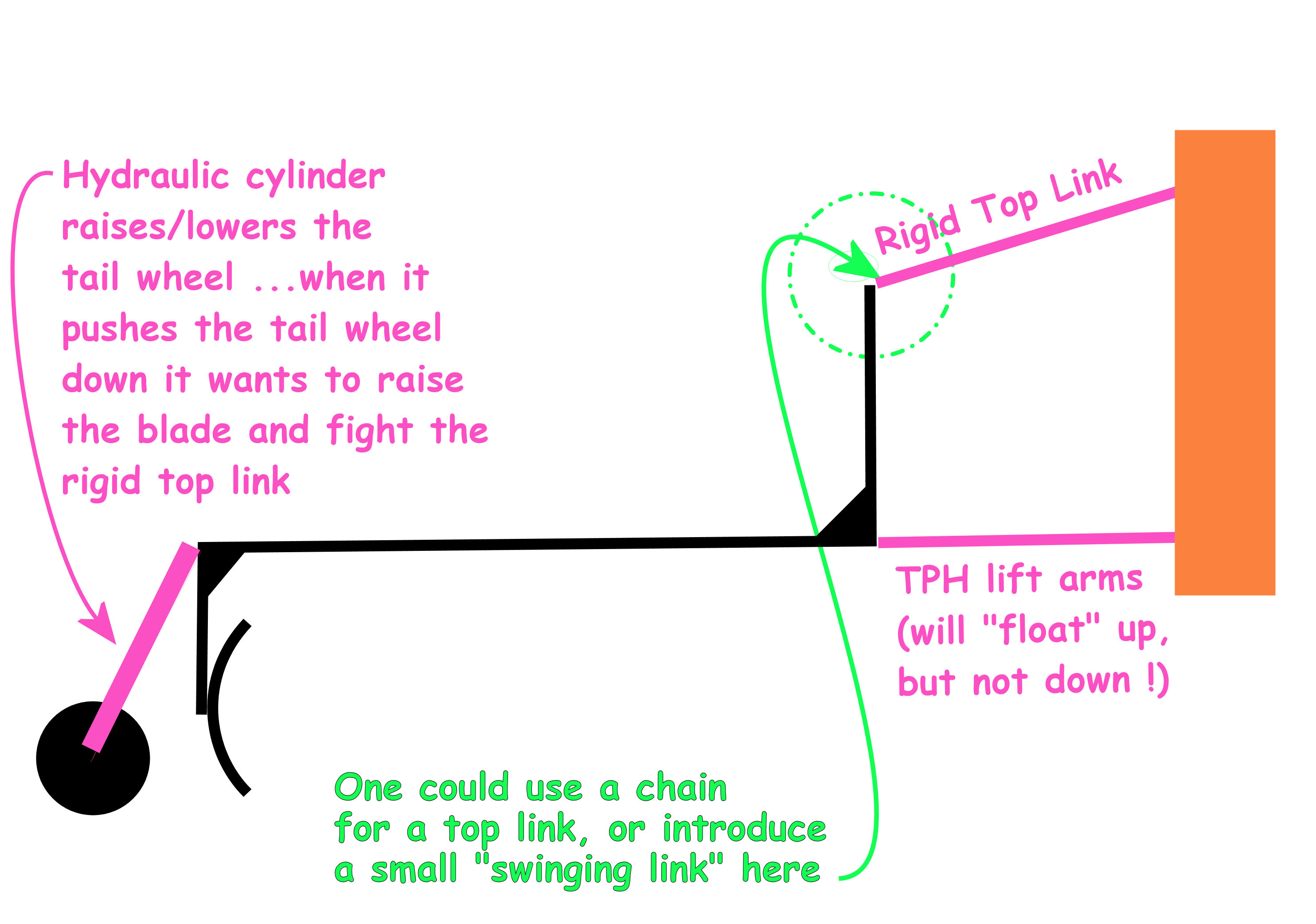

I have a hydraulic tail wheel on a LandPride RBT35, 8'-er, and I like it. It's a heavy setup and I replaced the wheel with a solid/filled marathon tire, which holds up fine. The blade can offset 30" and has hydraulic tilt along with the tilt from my T&T so it's great for ditching, crowning, etc. which, as far as I can see, can only be done with a tail wheel, not a pair of gauge wheels. I does add considerably to the overall length, which is good for grading, as described previously, but can get in the way...if I were designing it, it would fold upwards to the vertical (releasing the hyd cyl) if I needed to get close to something with the blade ...I can, of course, detach it entirely.
As for the toplink giving a blade "infinite" adjustment, I assume that what was meant was very fine-grained adjustment but note that changing the toplink length changes the "angle of attack" of the blade, which can be undesirable.
this diagram might be useful to some constructors...hope it is self explanatory as to why I use a "swinging toplink"

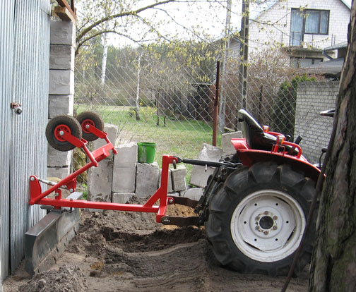

I made a RB with gauge wheels and I really like it. I used a top link for my adjustment as I do not have hydraulics either. I found that I would play with the adjustment until I was getting the cut that I wanted, then I would be able to just drop it and go--It would cut the high spots and fill the low. I will post a pic of what i did, but you can check out he link for build progress.
I am in the process now of building a new blade and plan on doing something similar for it. The wheels make getting a level pad/road just so much easier and quicker that it does not make sense to do anything else in my opinion. Plus the wheels add weight and that is a good thing.

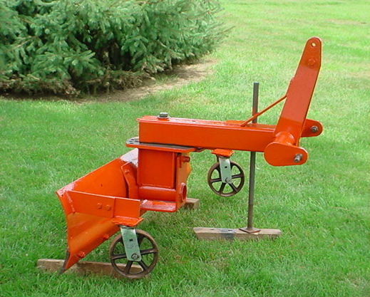

My Woods 6 footer has a little play (slop) in it therefore I like the idea of wheels out on the end of the blade. Follows the contour of the road surface better.
Wheel type: I use eight inch metal caster wheels and have never had a problem.
Wheel Adjustment: I welded a plate to the blade with two hardened bolts welded horizontally about three inches apart. The bracket that I welded to the top of the caster has two slots that match the bolt spacing on the blade. That gives me three inches of adjustment. Also I can tip them a bit too.
I have used this system for six years and have had good luck with it. I can also swivel the blade 180 degrees with the wheels active.
