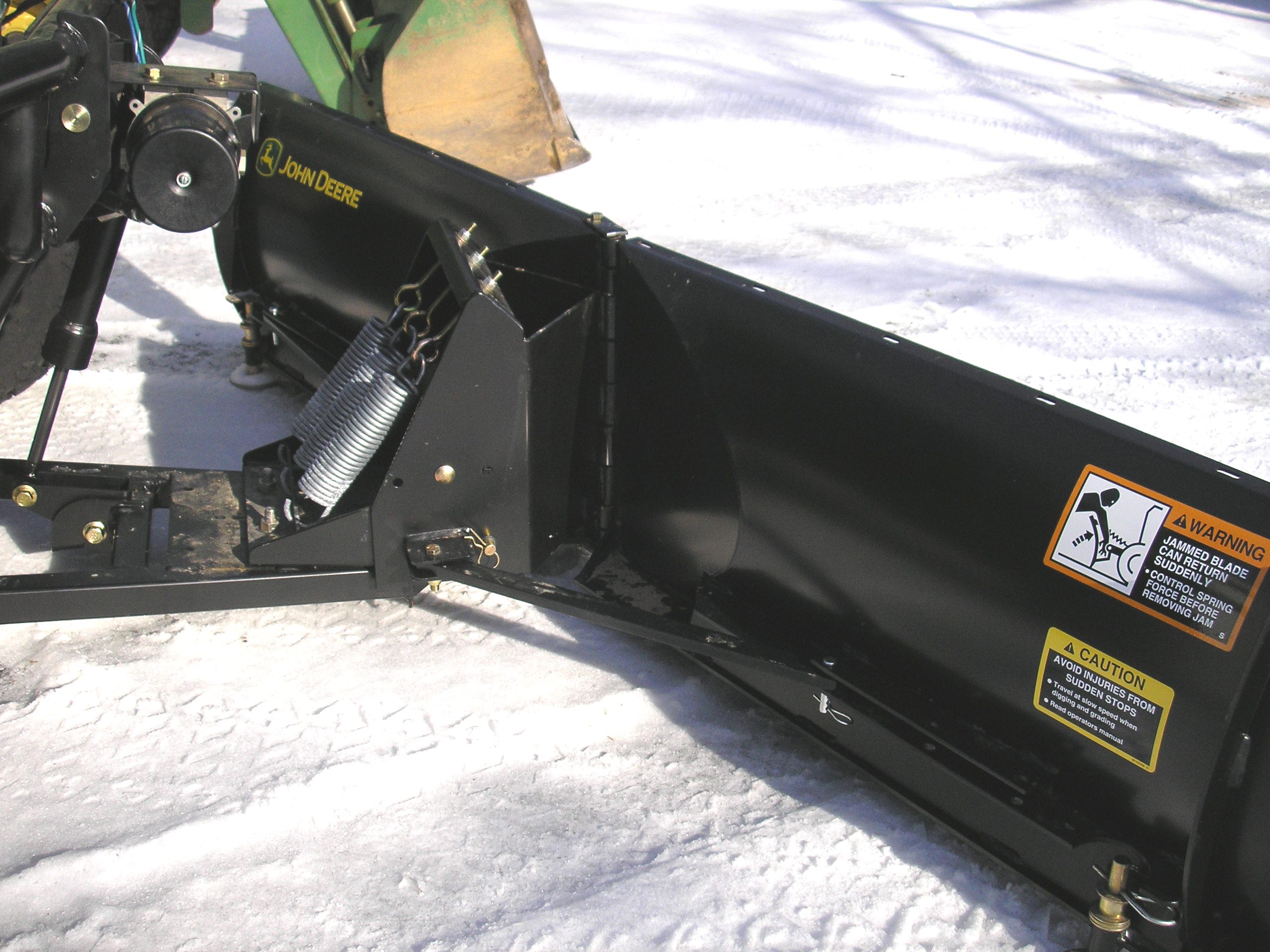

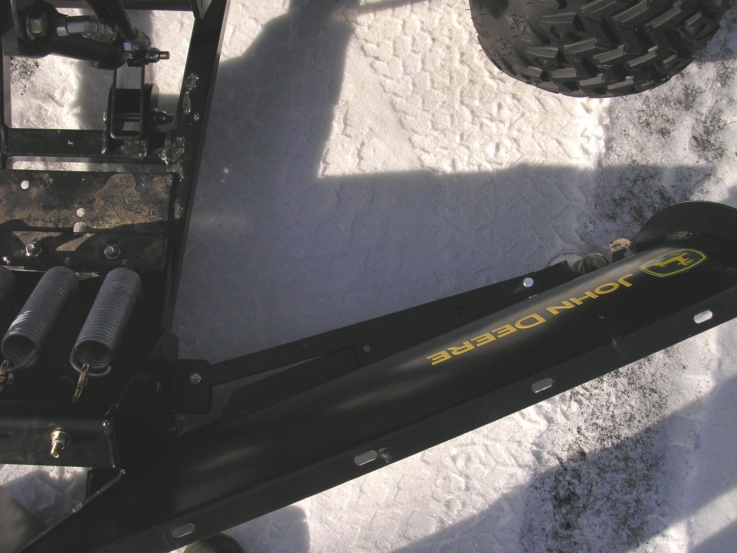

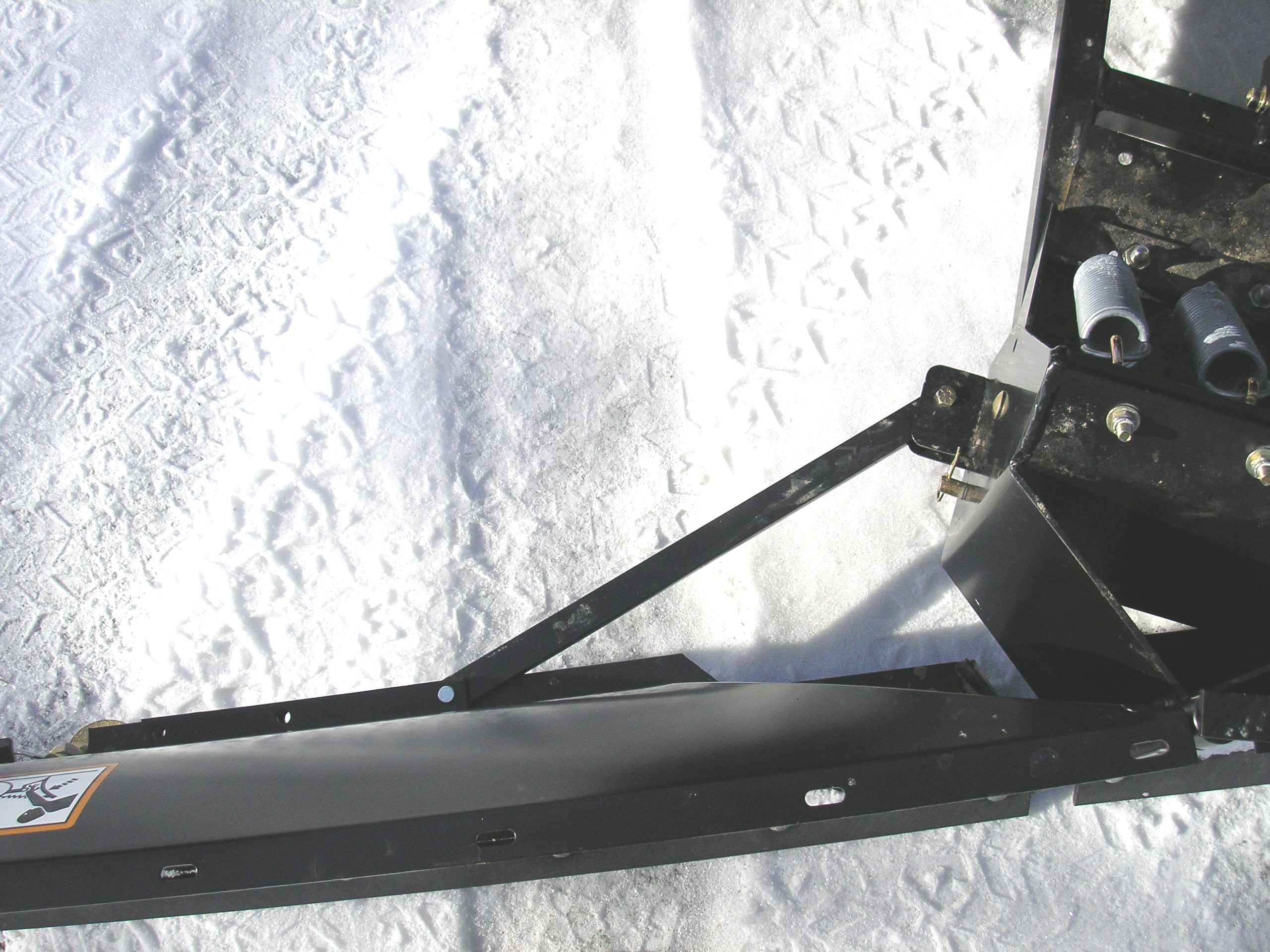

could you tell me how the angling is done and post a pictur of how it mounts to the gator
/ Gator plow #4
Here's some pics of the angling. The first is a side view that shows a general arrangement of the plow, including the trip mechanism. Manual angling is done by pulling a hitch pin and moving the link to one of three holes on each blade half. The second and third pictures show the geometry in the fore and aft positions. I took these pics a week or two ago to help my memory aas I model it in CAD to design the brackets for hydraulic cylinders for angling.
Sorry I don't have pictures of the mounting, but I will take some if you explain your specific concerns. The plow frame itself is mounted with (I think 5/8") hitch pins to lugs on the Gator frame just below the passengers. It pivots about these when raised/lowered. The hydraulic unit rests on the bottom bar of the front bumper/grill guard and is secured with two small hitch pins through the grill guard side plate. You can see one of those pins in the first picture. It is power up/power down with down pressure.
