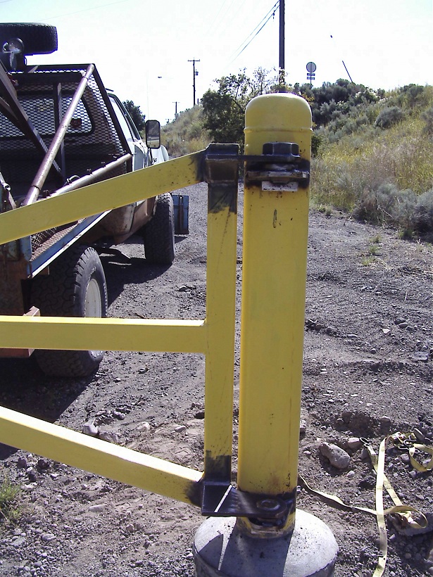

I've found those to be great for non-motorized gates. They allow for misalignment which can happen. They life forever if the gate is used often and they are cheap to make. You just have to use a little imagination when it comes to design.

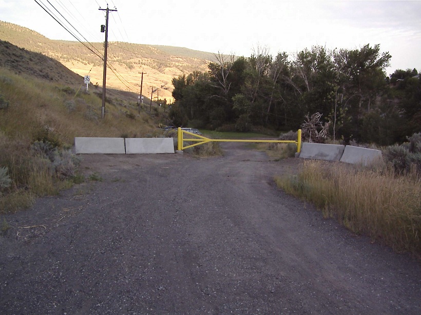

Not a nice pretty gate like some folks have built. Will have to work on that some day.
Sort of a "No Hinges" gate. Black pipe is 1/8"+ thick and just under 6" ID. Gate back pipe is standard water pipe with about 1/8" clearance. Black pipe & RR tie are 2' into the ground and concreted. It's almost 5 years old and every year or 2 it gets a little oil. Latch side is pretty simple and just flips up. Could be built a lot heavier and / or make 2 or 3 of them. Gate is 11.5' wide, but could be any length.
Some fool ran into the back side of the gate a few months back. Bent the cross pipe almost 1' out of straight. It loosened the latch post up a little, but all else held tight.

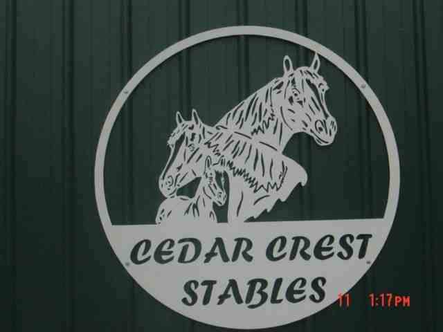

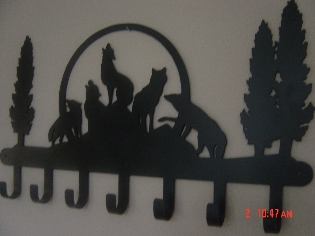

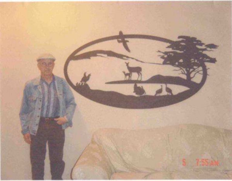

I love that gate grsthegreeat built! I need to dust off my cnc table and see if it still works. Been years since I even turned it on. :eek:
