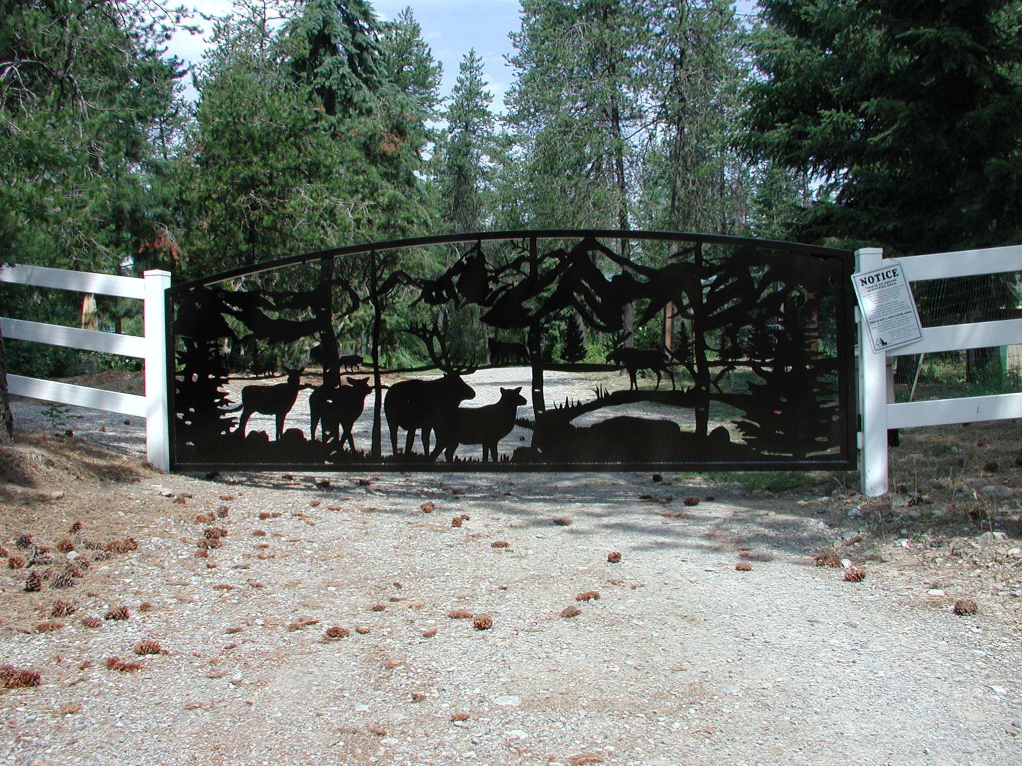

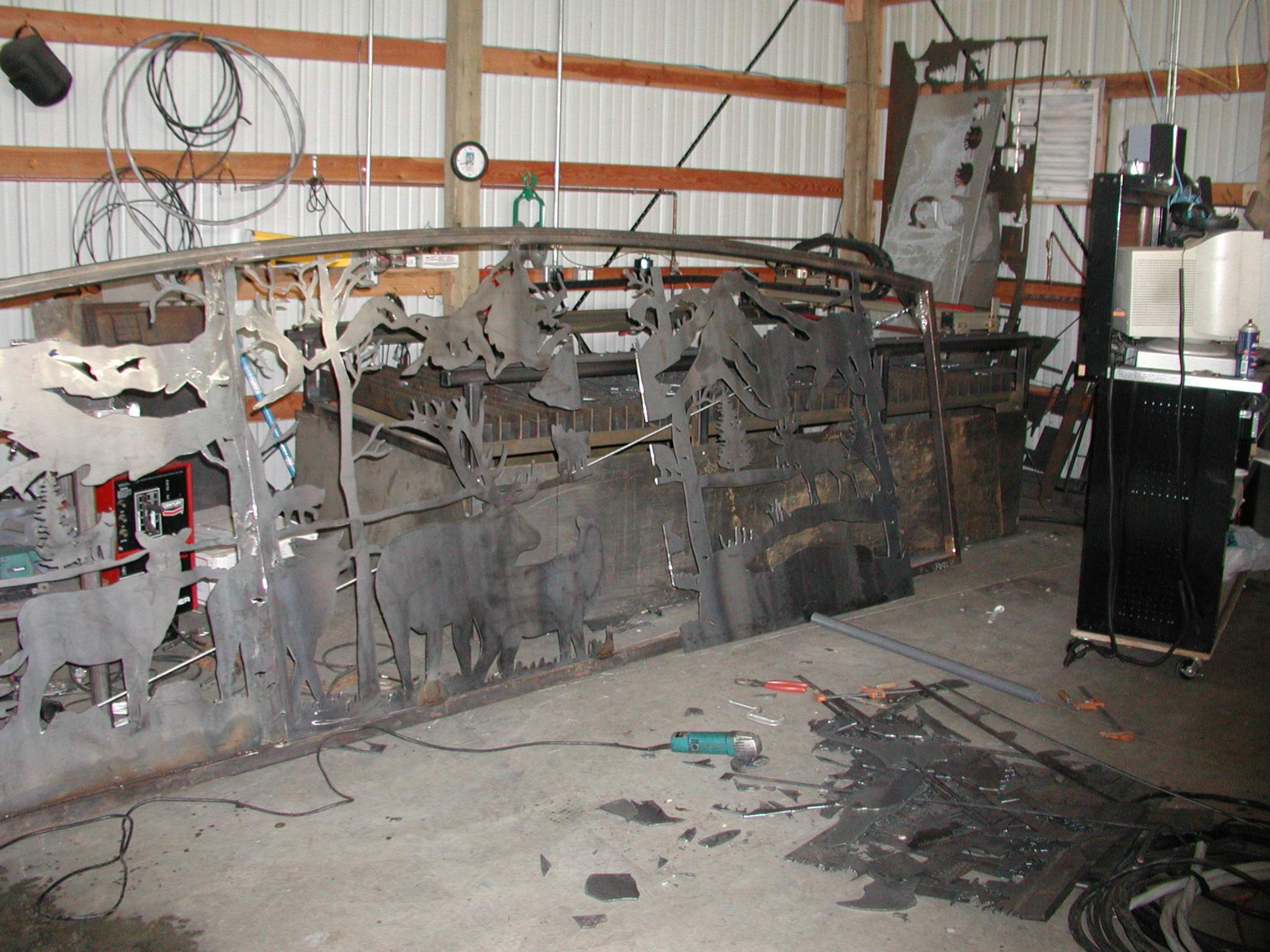

I am about to set out and build a pipe and cable fence around my house, in order to keep my bison inside or the rest of the world outside depend on which side of the fence you are on. but I am wanting to build 3 16 ft and 2 5ft gates out of 1.5 3/16 wall square tubing and would appreciate any tips and pointers. For hinges I was going to use 1 in solid rod and 1 inch sch 40. the gate post will either be 3.5 od .300 wall or 2 3/8 .190 wall. would one make a better gate post them another?
Here is a question for wroughtnharv if he is around
I have been reading several of your post and have looked at probably a 1000 of your pics, from this site and many others, and on your website. One thing that I have noticed are your gates can you tell me why you stagger the supports in the middle of the gates? is there a science to where you place them and how many there needs to be on each row?

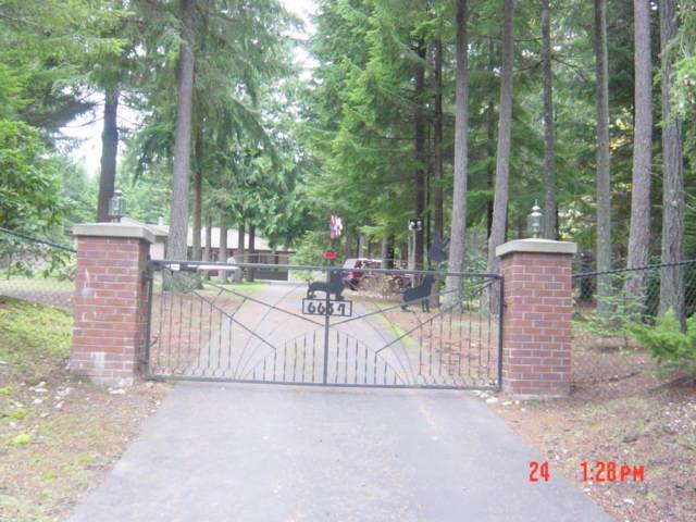

My local welding supply sells weldable, and greaseable hinges. If I ever build another gate I'll be sure to use them.

Oh your idea is fine, I was just suggesting to use a grease fitting is all.;)
I built the gate in the picture about 27 years ago, it was built with just sandwiched plate, (went cheap) no real good way to grease it.:eek:

Ok your gate looks very nice, hopefully someday I will be able to do things like that.

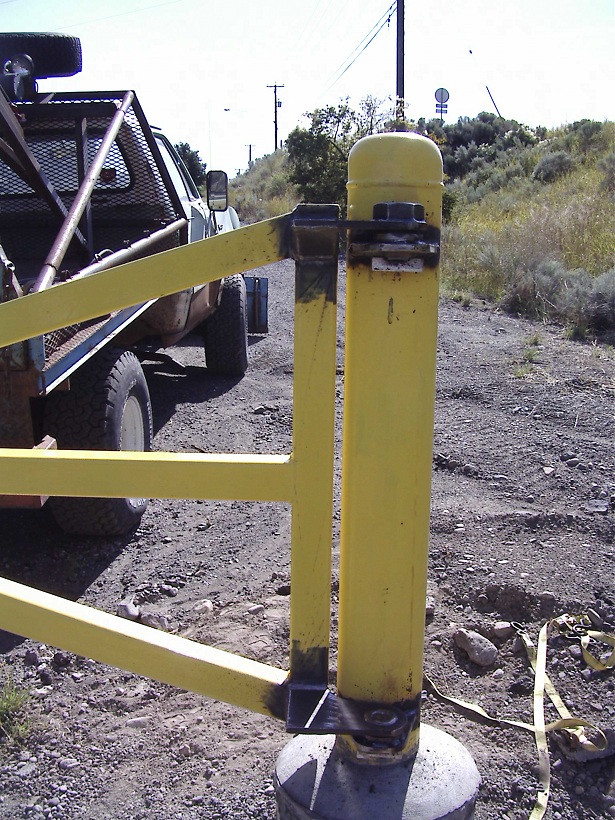

I haven't installed barrel hinges in years. Almost all of them I see installed are installed wrong and the ones that are installed right fail way too soon.
I just did a repair on one gate of 12 at a gated community. I'm sure in no time at all I will get a request to replace all of the existing barrel hinges.

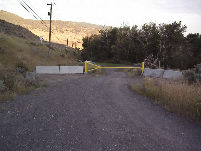

Here's what I used. All Steel Bodied Sealed Roller Bearing Hinge. 2000 lb. Weight Capacity,

those look like nice hinges. Do you see many of the weldable hinges like in this picture fail??? seems like there just a drilled out chunk of steel. what fails on them?
Even with a lot of grease you have poor grade steel wearing against poor grade steel. They get water in them and then they freeze up with rust. I see a lot of them break the pins at the joint. That says to me poor tempering or too much slop which creates shock which causes metal fatigue and failure.
You see them all the time where the bottom male is welded to the post pin up, that's right. But then the top is welded male to the post pin down. That's wrong.
They do that so that the gate can't be lifted off the hinges. There are many ways to stop that besides welding a hinge upside down. A stop can be welded to the post above the bottom hinge or better yet, weld the male hinge to the gate instead of the post, pin up.
