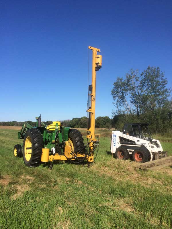

Just rent one when you need it.
Home depot has a nice MTA with a honda engine for about $100/day or $400 per week. You can pound a lot of posts in that time.
Check around - you can rent one that attaches to the front of the tractor or skid steer for about $150/day.
It works great and you don't have to foot the upfront cost or maintain it.
Don't buy a cheap one. The expensive ones are expensive for a reason - they're much better.
/ Gas Powered Post Drivers #49
Is this humor :D Try that at my place and you'll have bent tposts. Too many rocks.

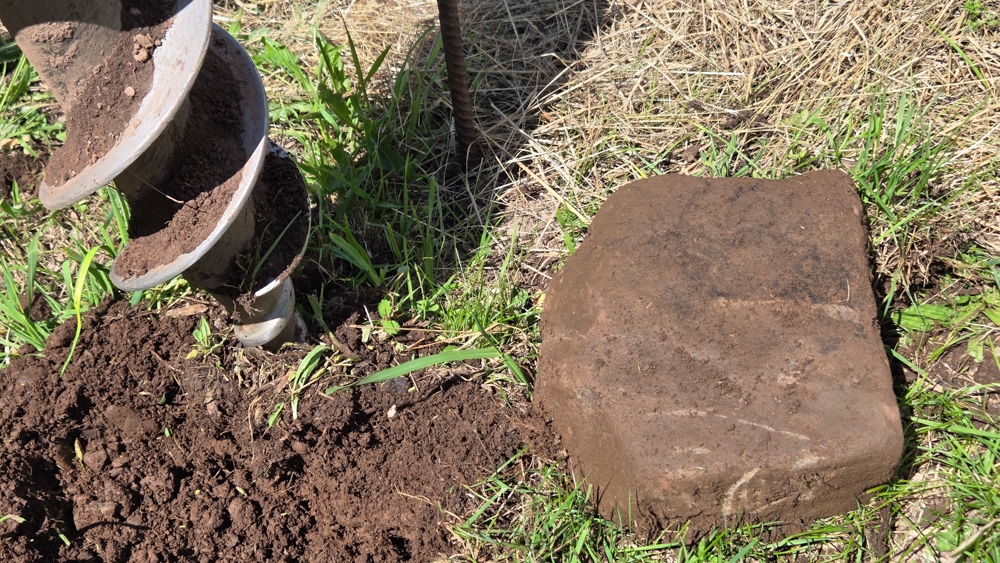

Same here! I have to laugh then videos show someone digging a deep post hole with one of those hand diggers.
I borrowed a 3 point hitch digger to mount on my Massey expecting (hoping) to make easy work of installing 8' PT posts for a garden fence. Hey, at least I got through the sod before it gave up! :rolleyes:
On the plus side at least I got pallets full of nice rocks to use for other purposes.
/ Gas Powered Post Drivers #50
Those 3-pt post hole auger diggers are about worthless if you have any rocks at all. At least with a FEL mounted auger, you can angle around and find the edges or seams between rocks. You definitely need reverse though.
