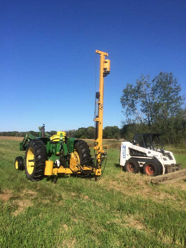

I like how you have it all set up. Did you compare it to the Man Saver? My thinking is that if I was to spend $2,000 or more, I could get the Man Saver, an air compressor and a generator to run it for less and have an air compressor and generator for other things. I actually already have several air compressors and a small generator, but for welding up my corner braces, I need a bigger generator for my arc welder. I'm also wondering about using my tractor for something like this. Do you do a lot of mowing with your tractor and do you have to remove your mower when you pound posts? I hate removing my mower and was hoping to install my posts from the back of my pickup truck or Kawasaki Mule. Then the tractor isn't even used.
I like the ideas on how to improve my set up. For the galvanized line posts we used the lift of the 3 point hitch and a rope to raise and swing the pounder into place. The lift and swing needs a better solution but after 1440 posts it worked but I can say that it was tiring. For the black locust end posts(10ft) we used a heavy duty trailer pounder but the trick was getting my JD 5325 to lift the posts into place as those posts were super heavy. Took us a little more than a week to do 72 end posts.
/ Gas Powered Post Drivers #22
Hi Eddie - Yes I did compare with units like the Man Saver. There are 2 things about it that made me go a different route. First our posts start at 8ft and I couldn't figure out a way to hang onto something way over my head. The second is that I decided to go with a pounder that does rapid explosive short hits as opposed to long strokes and less frequent blows. That way it's hard to bend the post top and you can more easily keep the posts plumb and in line with the other posts. It also seems to vibrate rocks out of the way better. In fact my hydraulic pounder is based on Atlas Copco's jack hammers. We did use a large long stroke post pounder to drive in the black locust end posts....seen here .... EnoViti: Days of Pounding End Post .
I can see the benefits to the hydraulic pounder over the man saver in your description. I guess I'm just stuck on spending the extra money for something so fancy.

Hmmm........until today I've never even heard of a powered post driver of any kind. What MNBobcat has pictured has the same drawbacks as a PTO powered auger. Will only go where the tractor will go. In my situation that would eliminate, at least, one third of my fence line. Then you have all the fiddle/farting around - getting the tractor and pounder in the correct place. By the time you get everything positioned - I will have three T-133 already installed and be over the hill and out of sight.
