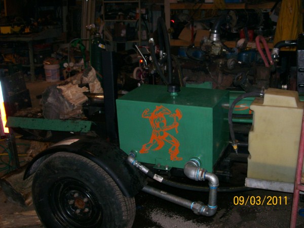

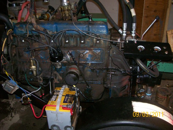

LD1- Because I CAN, because I don't have enough paying work right now, and I am bored? Because the pump and engine combo, 10 hp/16 gpm pump was way to slow, just under 1.5 min cycle time or there abouts. Because I wanted to hang a Ford blue oval on the front of my splitter for the longest time?
I got the cyl from the salvage yard up the road in trade for 1 ton of scrap sheet steel. I run pickup trucks in the local demolition derby, so I have 4, 300 I-6 Ford motors in running condition just sitting and looking for a use. My outdoor wood boiler has a 36" deep firebox. The beam that I had looked really stupid under the 4" cyl that was on it when I bought it for $700 from a retired Ironworker who made things with all of the scraps of steel he brought home. With the 4" cylinder that was on it, I couldn't just split 16" logs in the middle, I had to work around the outside. I have a 19"x19" door on my boiler, and just need to split the wood down enough to handle it easily. To get the power and speed I hope to have when done, I would have needed to buy a new 28 gpm 2 stage pump and a new 16 hp engine, at which point, I would have over $2000 invested, and still need new lines and a larger filter, etc. At this point, I only have $1,300 put into it, and don't see anything else needing to be bought other than to fill the gas tank. I am still waiting on my Hi flow return line filter, but I did have it running long enough to time the motor today. more pictures in a few days.
valve-$275
pump/coupling-$420
Cyl-$240 in scrap steel trade, and had it mounted before this revision, anyways
Lines/fittings-350
1 more 5 gal bucket of universal ATF-48.00
motor-free from a demolition derby truck
frame-original from splitter
almost new tires-free from another demolition derby vehicle
Hopefully sell the old engine, pump, lines and valve for about $500, to regain some of the cost involved.
$1,333.00 plus other small hardware store runs that I dont remember.

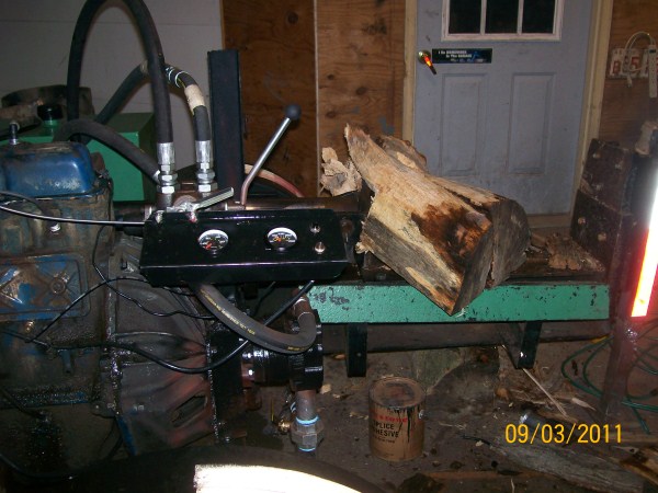

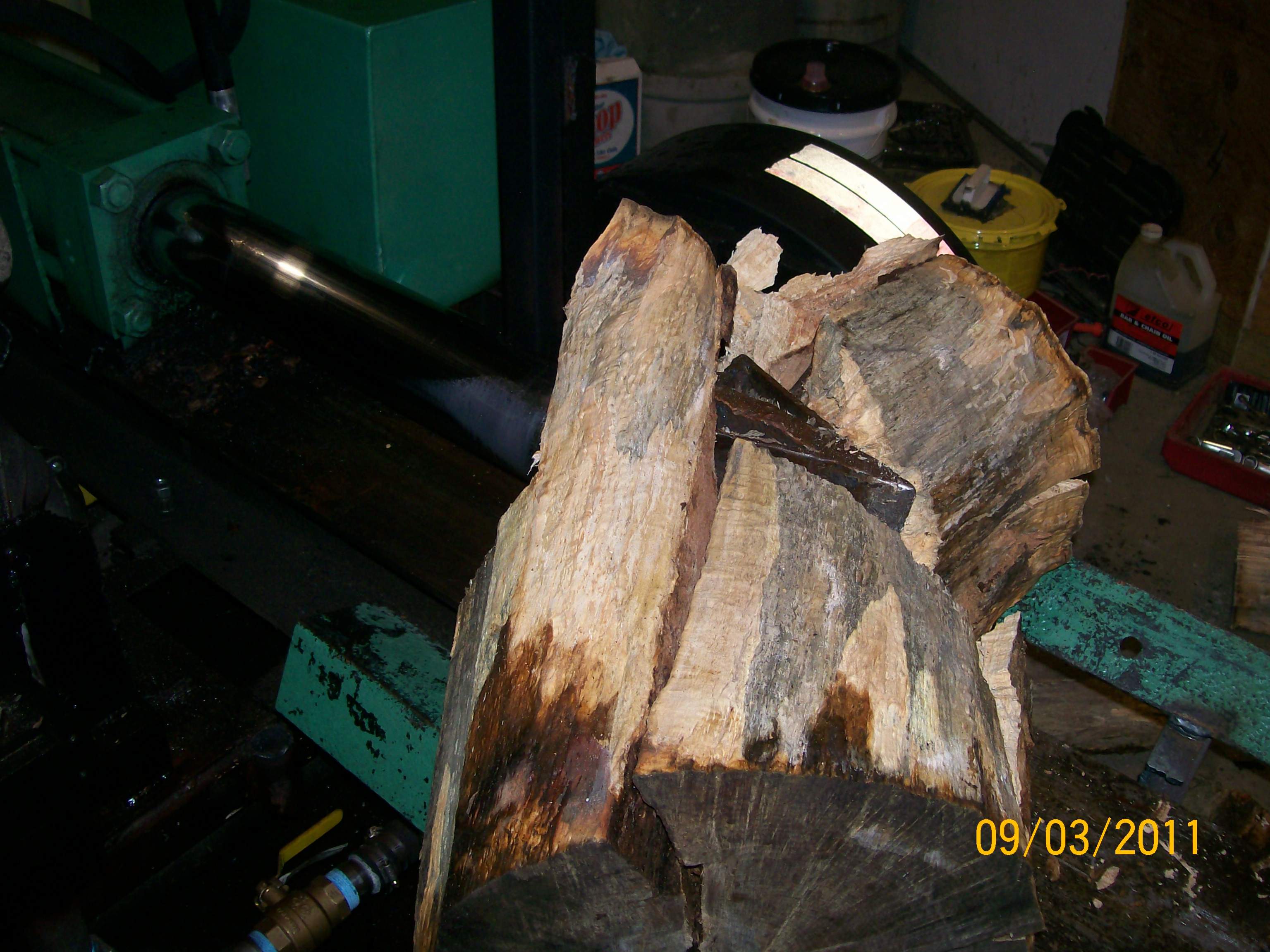

Ok... I finished it for the most part, Still don't have my filter, I called, and they said tuesday. I still had to play with it a little. As you can see from the pictures, I split a 16" sugar maple down the center nicely. The best part, though, is the fact that I sheared one of those halves in half cross grain. 1/2 throttle, and it didn't even grunt. Even better, I haven't turned the releif on the valve up any, it is still set at the factory 2000 psi, I have another 1000 psi to go if I want.
So, it appears that I got everything that I was after in my splitter project, speed-5 seconds to full extension, and 3 seconds return at 3/4 throttle, no load. Makes for 8 second cycle time. And plenty of power to spare. And as for that "knotty crotch" I have been ribbed for saying, I found one in my pile, an apple tree stump that was cut this summer.

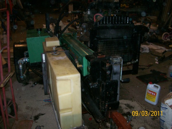

Crazyal, unfortunately, it is only 21 gallons. That is the reason I installed such a large oil cooler from a concrete truck directly in front of the radiator and engine fan. If that doesn't seem to be enough, I will install another cooler, this one has a port to connect another to it. I don't want to change the resivoir, because a larger one will not fit without totally reworking the frame, and sourcing a wider axle.

I weighed it at the truck scale today, It weighs in at 3080 full of gas and hyd fluid. When I am totally done with it, It will therefore weigh something like 3400 lbs.
