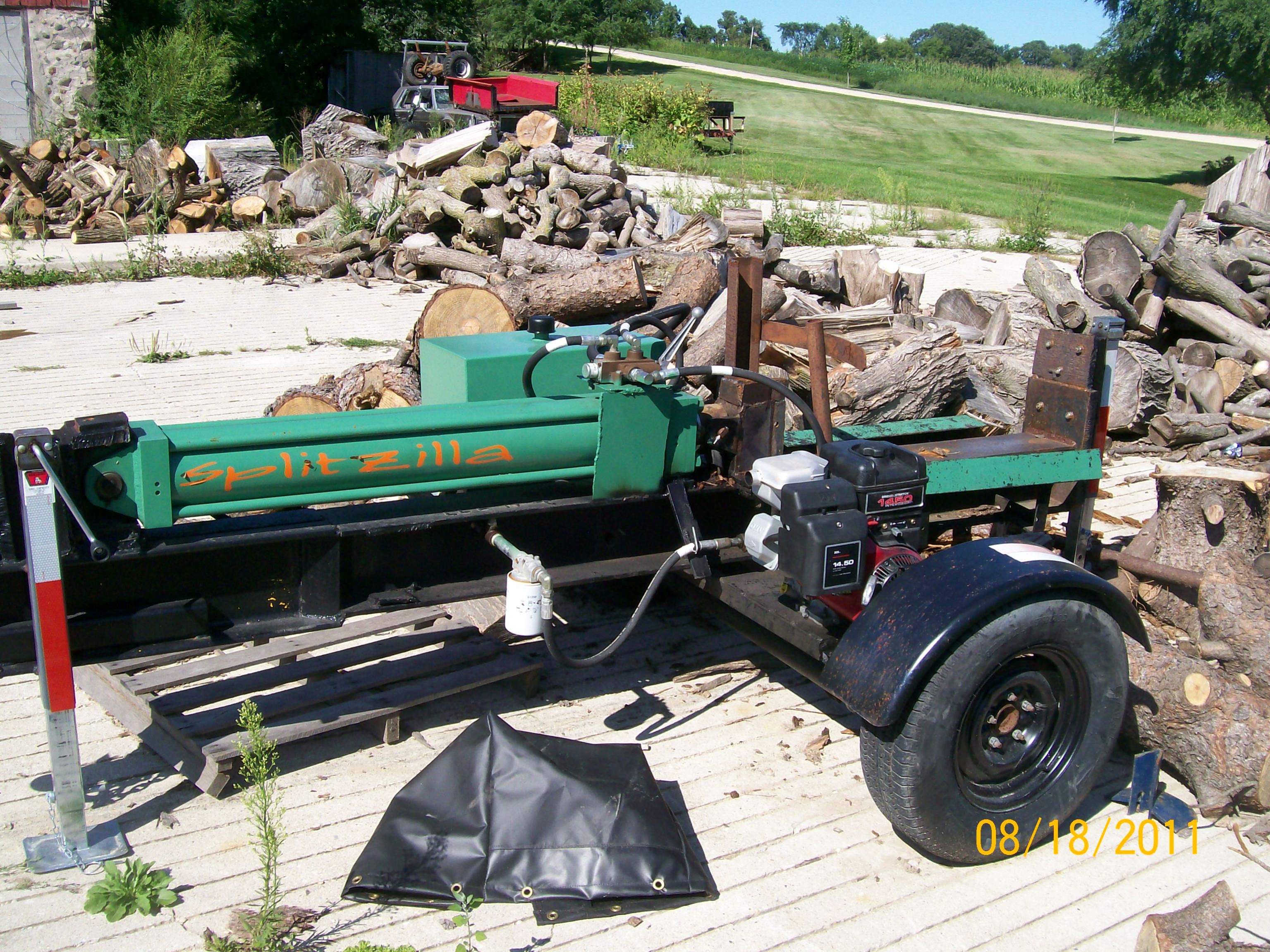

I have an opportunity to aquire a hydraulic pump from the front of a garbage truck. Does anyone know what pressure these flow? I have a splitter with a
7" x 48" cylendar on it. It currently runs with a 11 hp briggs engine and a 16 gpm pump. I want to install that massive pump attached to a Ford 300-I 6 / 165 hp engine from a 1981 F-100. Volume should not be a problem, as I found most new Garbage trucks spec a 40+ gpm pump, but cannot find at what psi and rpm this happens at. May sound rediculous, until you realise that I have over a 2 minute cycle time with the small 16 GPM pump. I heat the shop and the house, with an outdoor stove, and my aunts house, and the maple syrup operation and between all of them, I make and use about 25 full cords per year. Thank you.
/ garbage truck pump on logsplitter
#2
Where can I source a 40 gpm flow rate valve with 2,500 psi + capacity, or can I just use the valve from the truck and block off output ports as needed? Splitter: 10" I beam, Dodge Grand Caravan axle, 7x48 ram C load trailer tires, 1-3/4 thick end plate backed by a peice of railroad track, 2- 7,000lb trailer jacks, and a small 11 hp Briggs, because the 16 hp twin cyl briggs I was given was stolen out of my shed. Only problem is the cycle time. Haven't found anything that can stop it yet, Including green elm knots. Don't have any bur oak to try, but would like to find a knotty crotch from one, just to see what happens...

Splitzilla is definitely an understatement! Surpluscenter.com should have everything you need. I don't have any ideas on the pump you're looking at, the largest I've seen was a 30gpm pump powered by a carbureted Toyota 22r 4 cyl from about 1985. The splitter configuration was basically 2 splitters side by side built into one trailer, each with its own 3" dia 24" stroke cylinder ram. It was valved so that when one side was splitting (extending) the other side was retracting. It would work a pair of twenty year old bucks to death, but was set up to be run by one person like that.
That's about the extent of my wood splitter knowledge. ;)

The garbage truck pump idea is out. I disconnected the shaft at the engine today, and it free spins way too easy, no resistance at all, and would have had to be mounted on the front of the engine. I went to Northern, but they are out of stock until september on a Haldex Hi pressure cast iron gear pump in a CCW rotation. #10586-1201 The only reason I don't just go and get a 28 gpm 2 stage is because I would then have to source another 16+ hp small engine, and pay almost 400 for the pump itself. Besides, who doesn't like a challenge and having the baddest splitter in the neighborhood. Going to see my local truck body fitter tomorrow. Came up with a good way to get a shaft on the back of the engine. I sourced a flywheel, clutch assembly, and manual transmission from the back of my shed for an older ford truck with this engine. I torched off the imput shaft as close to the bearing in the front of the trans as possible. installed pilot bearing in crankshaft. Put peice of shaft with splines thru clutch disk, and welded a washer on the pilot end just at the beginning of the splines to keep it from pulling out. Installed clutch on motor- have a dead center 1" shaft out the back of the Ford. I will grind a keyway into it, and install an L110 1" half on it, and the match on the pump. I would have pictures, but have no AA batteries. Tommorrow.

Ok, So I went with 1-1/4 suction as that is the size of the pump inlet. I went with 3/4 line for the rest, because that is the size of the outlet. THANK YOU ALL for your help. pictures and updates are and will be posted in the made it myself forum under homemade logsplitter.
