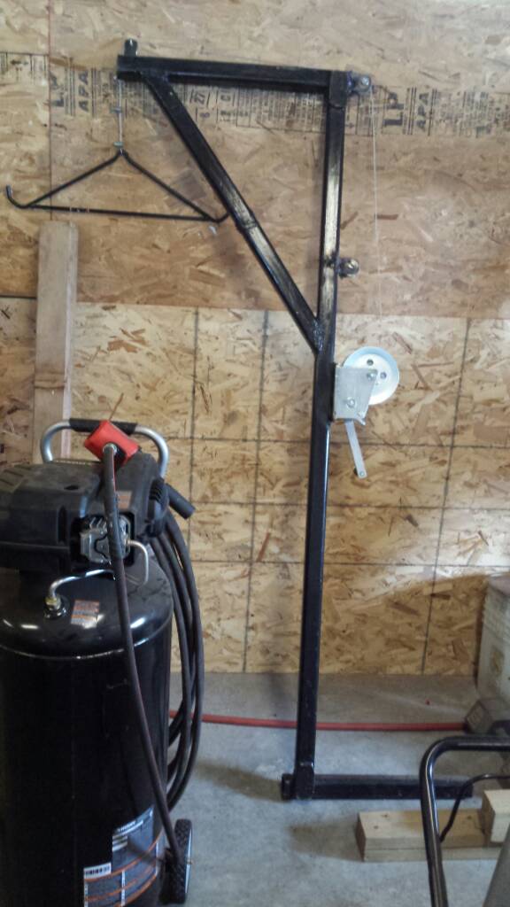

He is the one I put together made from iron that was left over from the cultivated build. 2x2x1/4 sq. tube HD! 3/32 cable.20170204_104758_1.jpeg

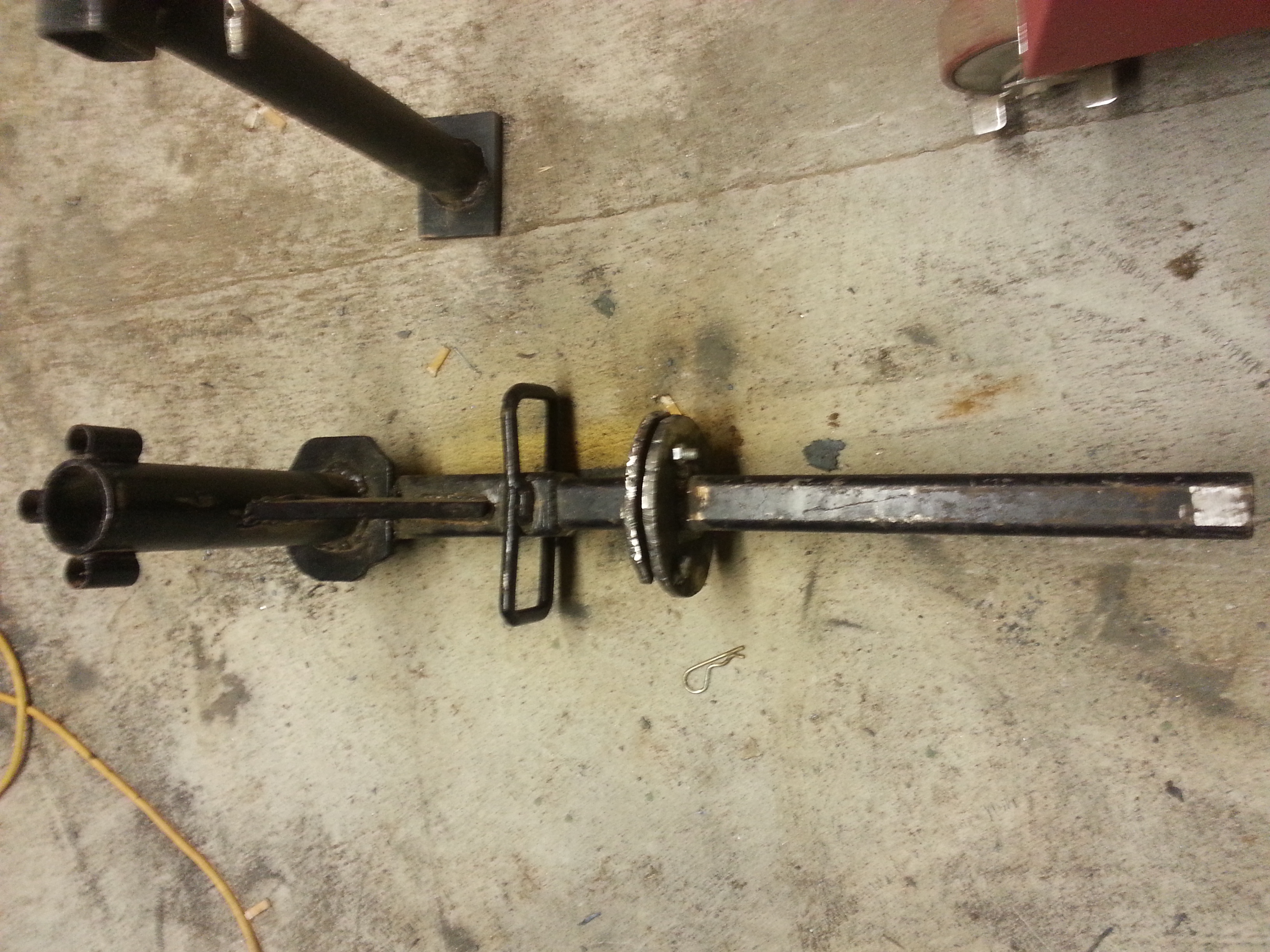

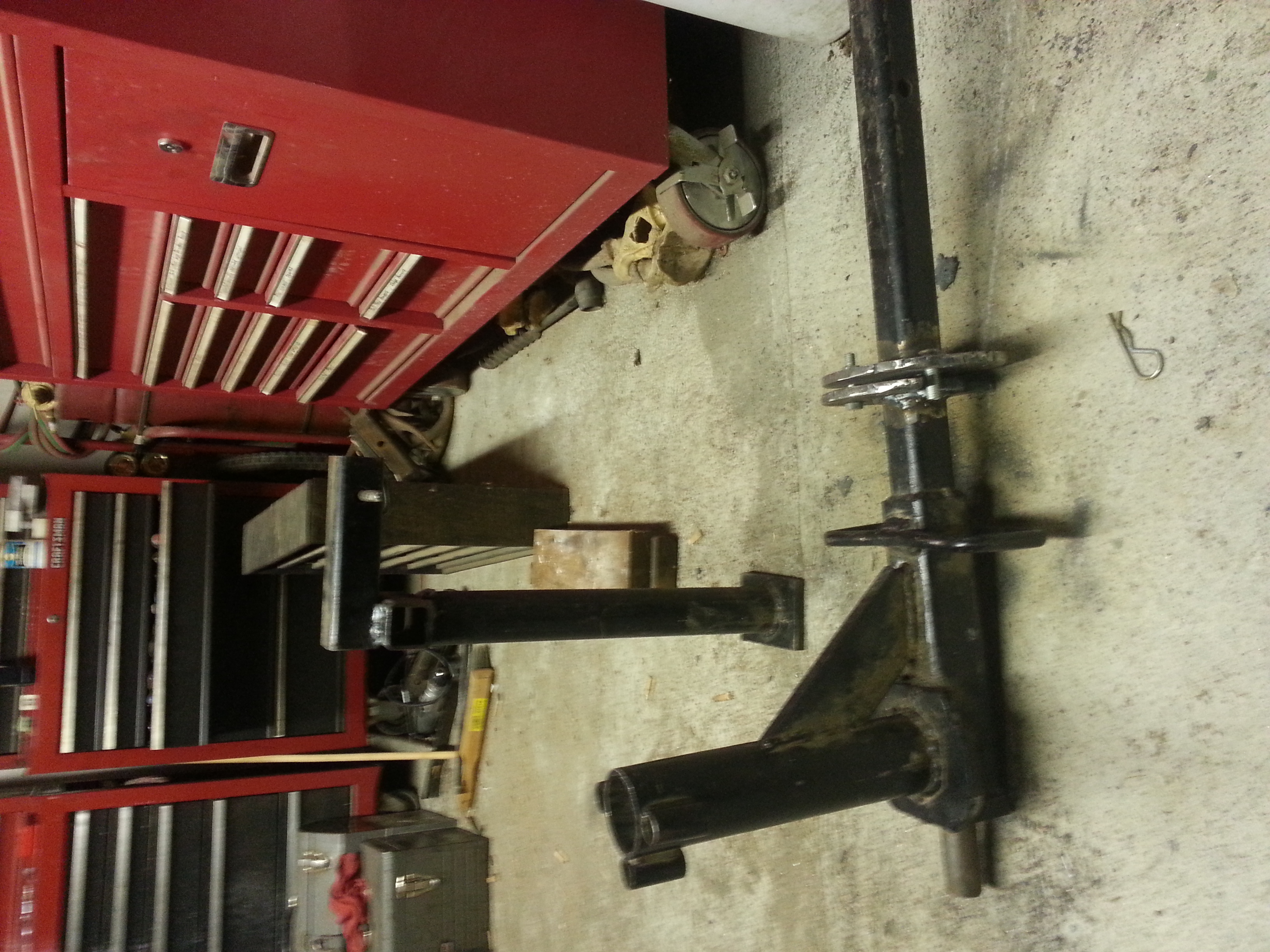

Here are a couple of pictures of just the base unit that slides into the reciever .
Dang thing weighs likely 40 or 50 pounds + , thus We have it the entire set up in components and now We will assemble in the horizontal position then rotate vertical either using the winch or winch and 1 of the many 27' 4000 pound ratchet straps that I have around here . I am the youngest at 57 , thus We be to old for to much manual labor . As they Say " Work Smarter , Not Harder " !!:thumbsup:

In the second picture , the " Leg " off to the side that can be seen , is a piece of additional 2" reciever tube welded to a pad that will slip onto the 1 3/8 solid rod that extends out of hitch extension and also slips into the extension thus it makes for quite a brace or " Foot " on the back to hold the weight .

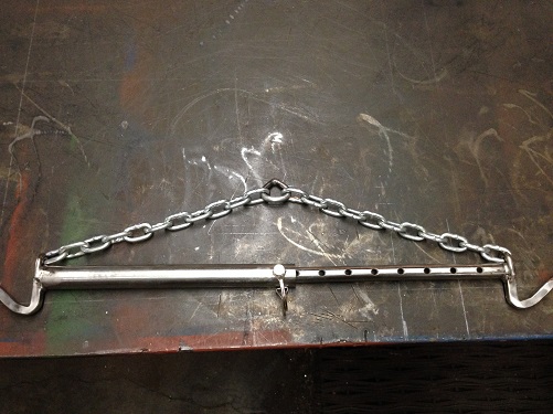

Here's one I made last winter, put an offset hitch on the truck so I can still pull a trailer and let my tailgate down. I even made a stainless gambrel that adjust for large or small deer.

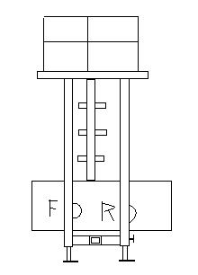

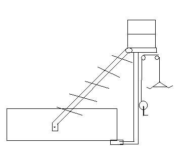

Here is one of them not yet built, but in my head. This is a combined gaming hoist/ feeder filler like this model of game hoist 5 Best Deer Hoists of 218 – Hunting Fishing Plus - Hunting Fishing Plus Please excuse the poor Cad tool (Paint) and everything is sure not in proportion or even close to scale, but you get the idea. Also feel free to make any suggestions my way.
My feeders are quite high, and now I stand on the bed rail and closed tailgate and can barely get the sack over.
I have a turn over gooseneck hitch so, so I decided to drop the ladder end into it to help stabilize it. Then pin it where it meets the platform.
Here is the rear view, and I have two vertical parts with my legs down to add extra stability.
