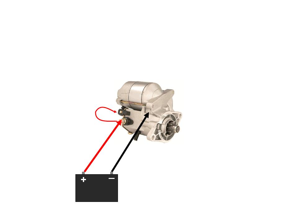

You said you jumpered from your L2800, but if you did that to the G1900's battery, you didn't prove a thing about the starter itself. You need to jumper from a battery directly to the starter as I've shown below. Put the black jumper on negative and clip it to the body of the starter or some other good solid metal ground on your tractor. Take the red lead and jumper that to positive on the battery and to the large terminal on your starter. Then take a small wire and jumper from the large terminal to the small terminal as shown in the illustration. That is the only way to test the starter for sure. If that makes the starter work, then your problem is a switch, bad connection, or the relay box on your tractor.
EDIT: If you want to do a quick check of your battery without an external battery, just jumper the small red wire as shown. That should make your starter spin if your internal battery is strong. That wire eliminates all the switches/relays and gives you direct hot wire connection.

Thanks for the illustration. I tried it the way you described pulled the L2800 battery out of the tractor set it to the side and hooked up the cables to it. I then grounded to the starter and placed the hot cable to the main terminal on the starter and then linked a small gauge wire from that post to the flat terminal on the solenoid. Off the tractor the starter worked the way that it is supposed to. But once hooked up to the tractor it attempted to spin but just bogged down and stopped all together. Again I checked to see if the engine would turn and I could turn it several revolutions. I also checked to see if the alternator was stuck which it was not. So with all that said is it safe to say the starter just doesn't have what it takes to turn the engine over. And can I assume that this bypass method would get me around bad switches or ignitions? I guess I just need to shell out for a new starter and see what happens.
/ G1900 Diesel won't start. #9
Well, there you go. . . sometimes there's nothing to do but buy another starter. At least you know you've proven this one bad. You could check with a starter shop to see about rebuild, but you can probably buy one and send your core from an online source just as easy.
