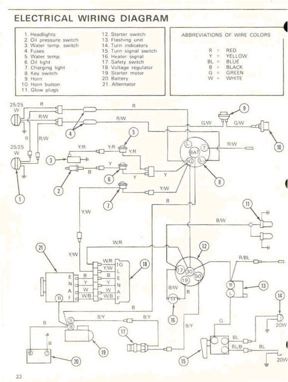

I need a voltage regulator for my tractor can anyone help?
And can someone post pics of all wiring please.

If you want all the details on the wiring I'd recommend getting the service manual. It also shows the schematics for the alternator, regulator, and starter which are helpful. Then you'll also get all the other service info you might need in the future. Parts lists and service manuals are a MUST in my opinion if you want to keep these tractors going into the future. I'm a bit surprised the manuals aren't readily available for free d/l on the net, but they are worth the purchase price from dealers anyway if they can help keep things running correctly.
/ G174 need voltage regulator #6

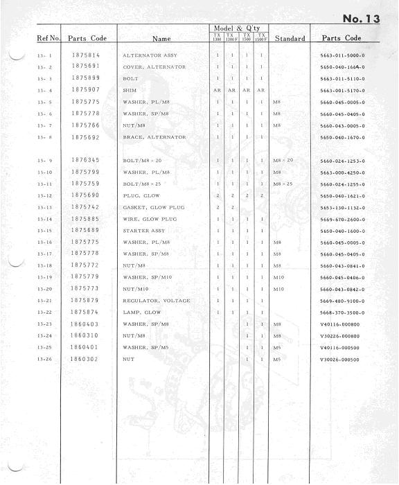

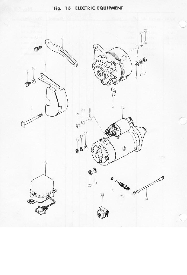

The Bolens G174 is the same as an an Iseki TX2160/TX1500F - built in the same factory,same HP, gearbox, axles, diffs, pumps, linkage etc- the only major difference is some of the early series to maybe c.1981 Bolens use a K75 2cyl Mitsubishi engine whereas the later Iseki's use a KB3 3cyl Mitsubishi.
Attached is an extract from the parts book detailing the voltage regulator part number you seem to require, together with the wiring diagram.
