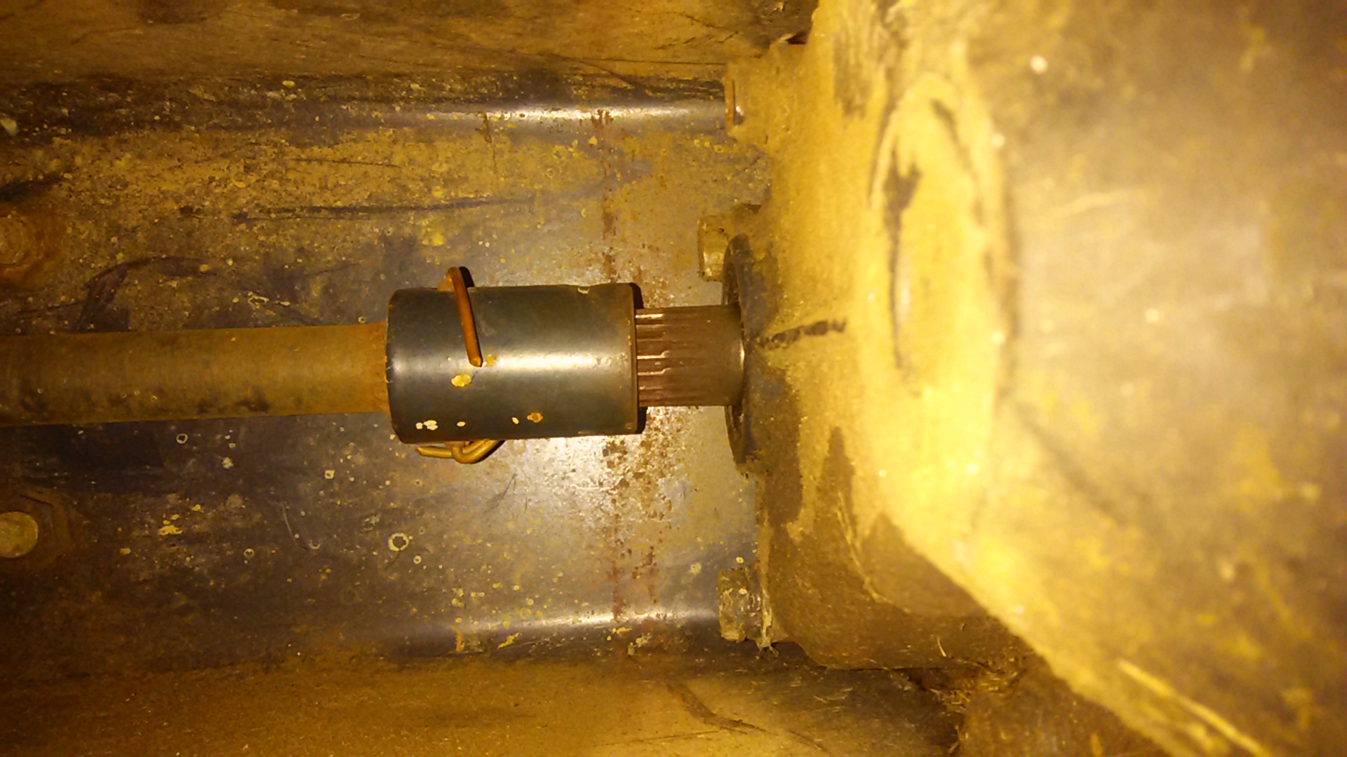

So I found the problem. My spline boss pin on the transmission side had come out, allowing the shaft to slide towards the clutch, disengaging the splines on the tranny input. I simply slid the shaft rear ward ensuring I aligned the holes, installed a crush pun I had on hand and I'm back in action. I got lucky in that it seems my splines survived. Hope my crush pin holds up to some plowing!

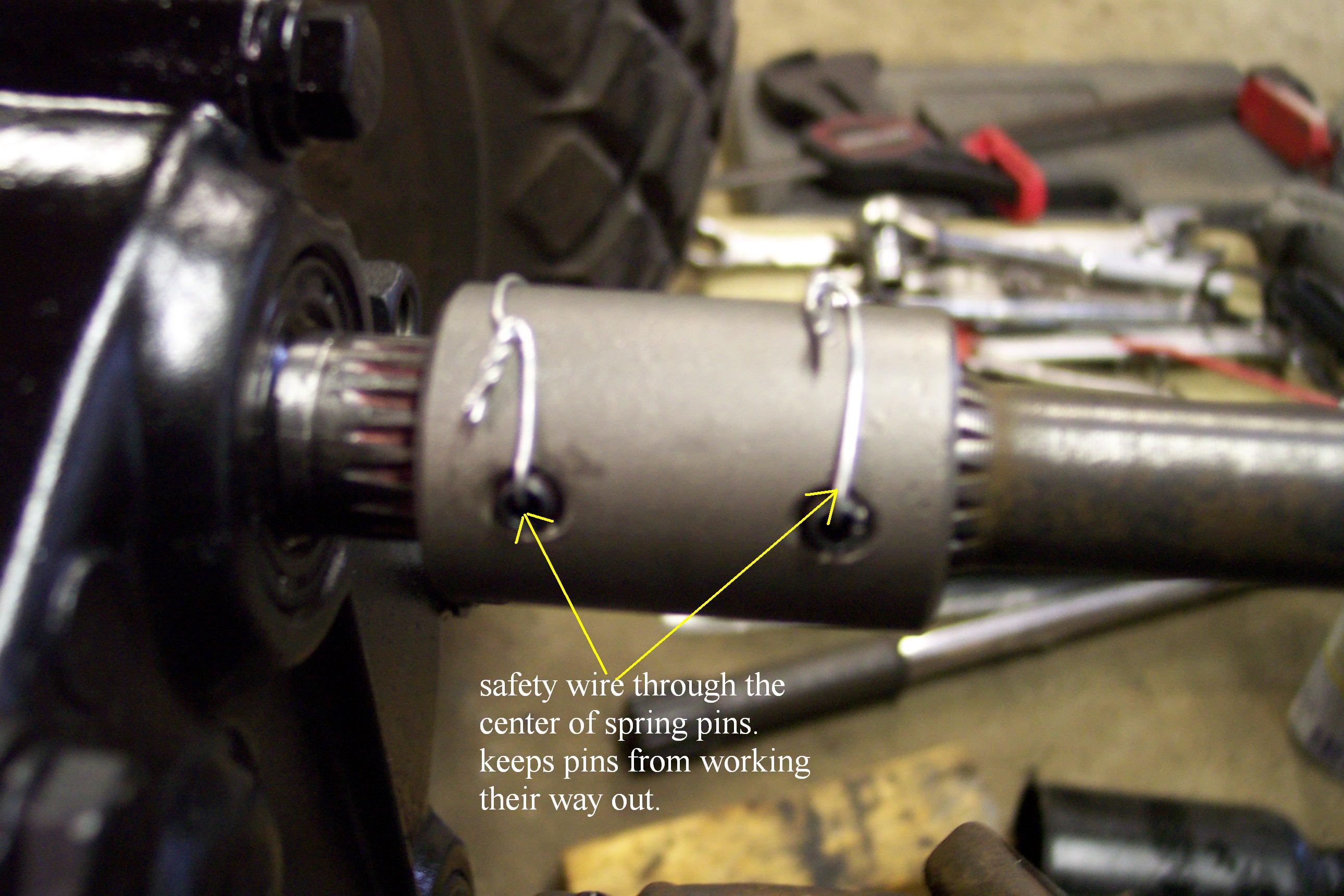

Glad it was an easy fix. I have a G154/TX1300F and the spline boss
in mine was shot and the input shaft in the transmission was almost
shot. I welded each spline on the shaft and then hand filed each one
so it would fit a new spline boss. The new spline boss at the time
I did mine was over $100. The input shaft was around $250 so I
fixed the input shaft but I had to but a new spline boss. Here is a picture
of mine. Be sure to put safety wire through the spring pins so they
don't work their way out.

Thanks much! I saw a copper wire through the one remaining crush pin when I first diagnosed this, and it looked like household electrical wire. That tipped me off to the fact that maybe I need a safety wire, so I stuck a cotter pin in there and bent it off until I learn what wire is ideal as a safety wire. Probably nothing exotic . . .fxrs55, I love your thread - I learned a lot and appreciate your time taken to document all of this. I bought my tractor as a combination desperation/inexperience move - I had new land, and absolutely no tractor experience, combined with low funds. Bought her off of Craigslist not ever having been in a tractor seat. I have to say I have worked the heck out of this beast doing all kinds of things it probably shouldn't, and I love it more each time. I now have a Power Trac 425 in addition to the Iseki and between the two, I can do more than I ever imagined. I'm pretty grateful that I didn't have to attempt to weld spines, because that is way beyond my skill with a welder . . .

Nice, Glade it was easy. Thanks for the picture. Its nice to
see what is wrong with other peoples tractor for
future reference.

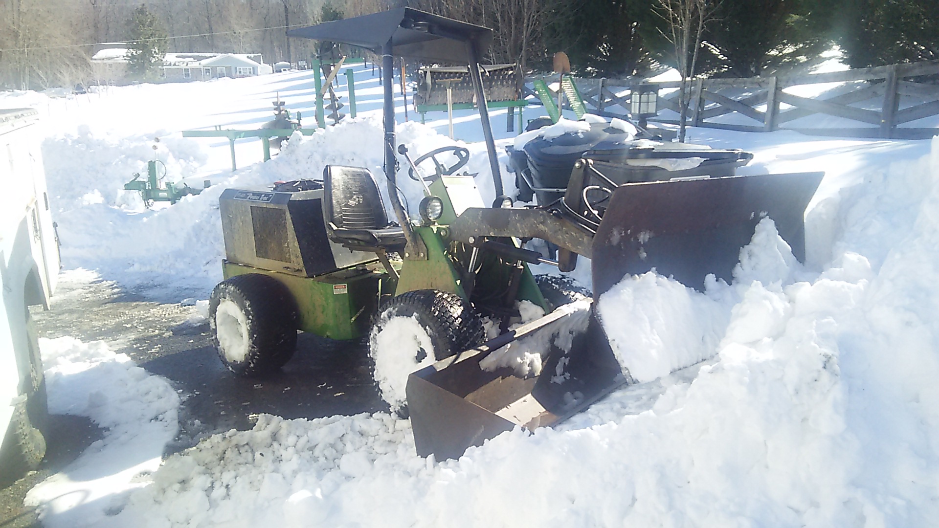

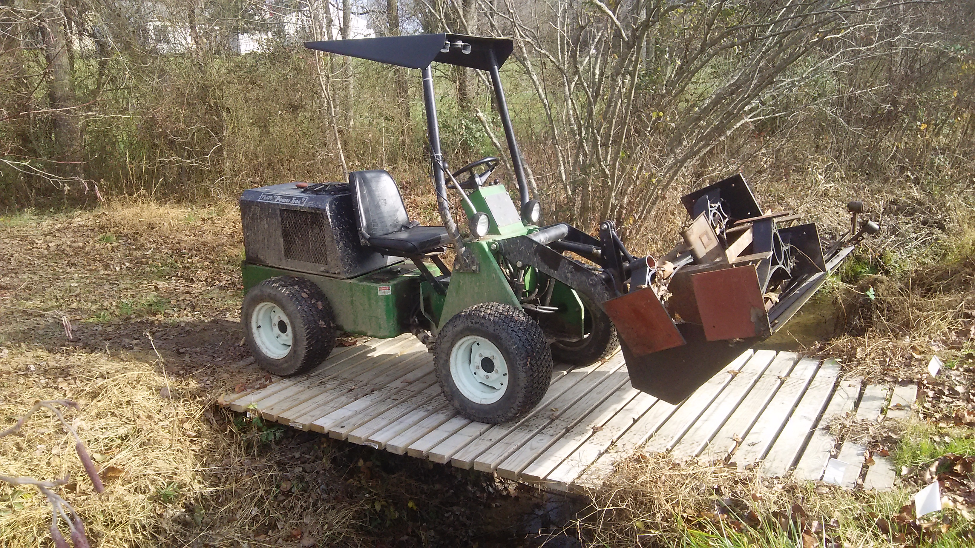

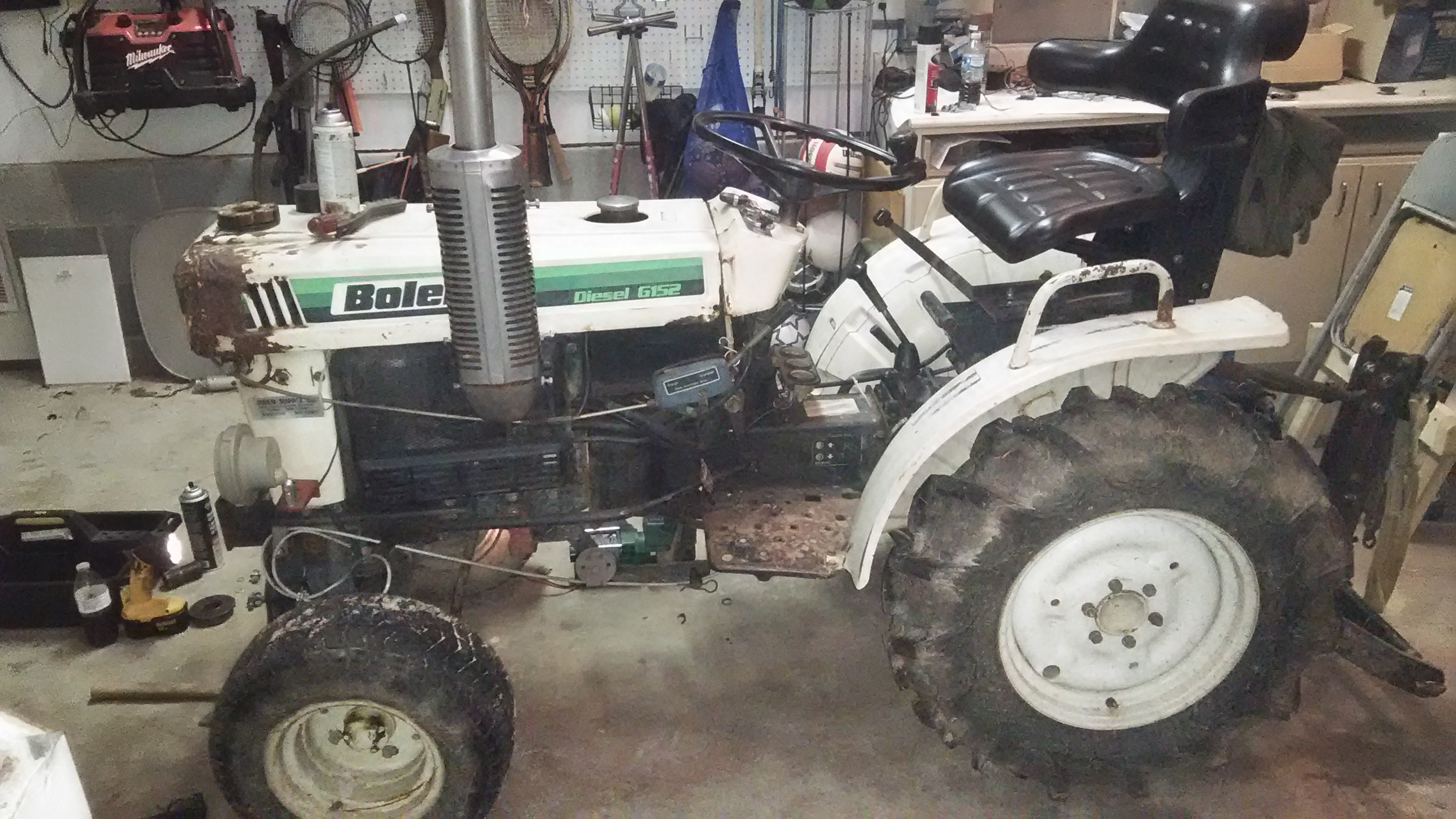

Here's My PT-425. I real workhorse, but I noticed the non-traditional tractor layout turns some of my neighbors off. Of course, I have used it to help them all out a bunch. I really like it. There's a whole page devoted to PTs on the brand specific forums and the folks there are incredibly helpful. It was from them that I got the idea to start looking for a PT. But this being the Iseki page, here's my baby:

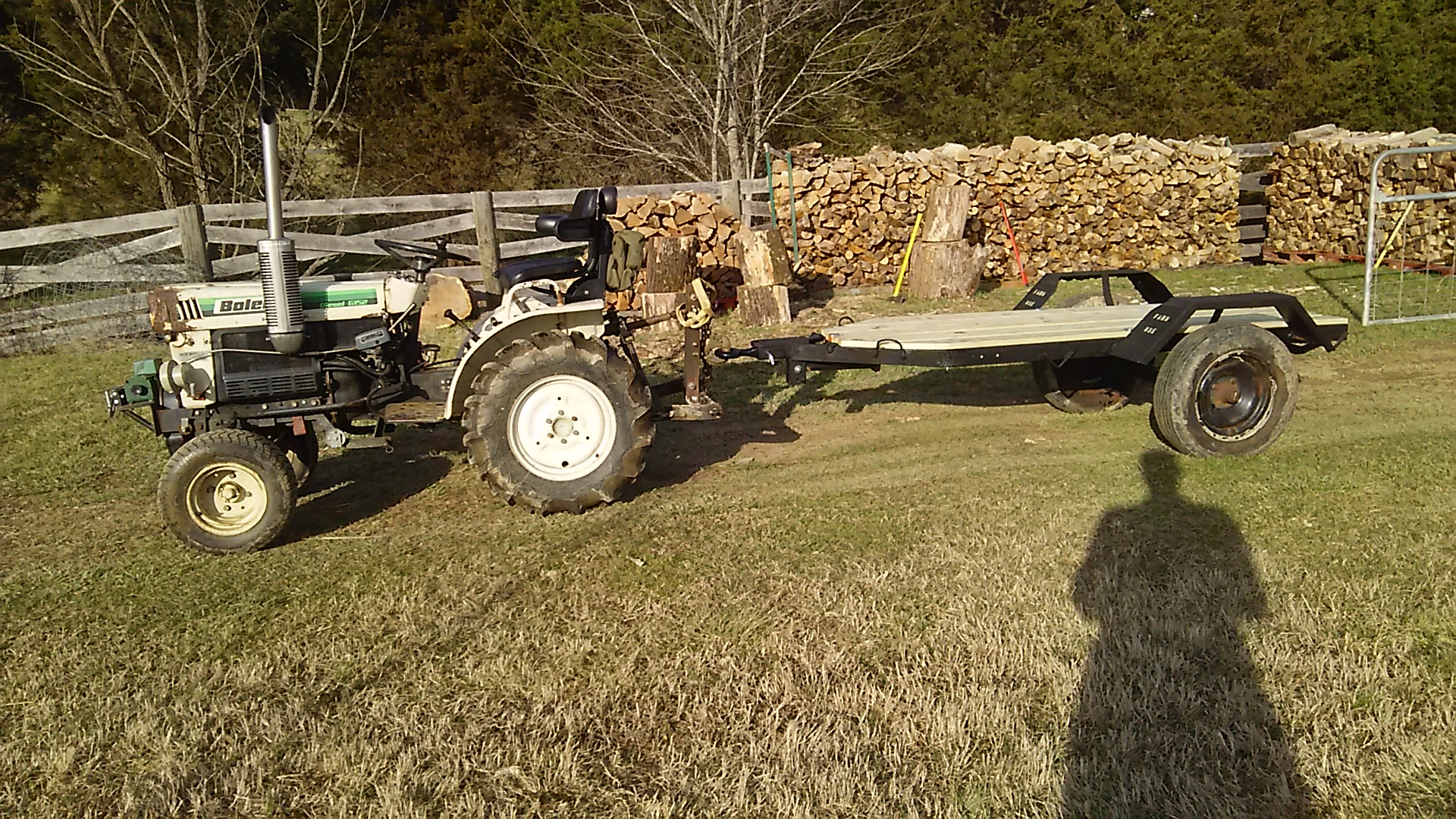

I see you have the front PTO thats nice. What do you have hooked up to it
in the picture of tractor towing the trailer?
Also is the PT-425 4 wheel drive? I'll bet your neighbors think it looks
good when you're using it to help them.
/ G152 Dead in the Water
#12
The PT-425 has four hydraulic motors on the wheels, and I think they are plumbed in two circuits, so it's a four wheel drive, but there is a differential effect that - I'm just not exactly sure how it works. I had traction that flat out surprised me in our big snow this year, and I could "crab" the PT with the articulated steering if I got in a spot where all four wheels spun.
On the G152, I had to rebuild the front PTO. There is nothing hooked up to it in that pic, but there is an electric winch on the front. I bought the tractor with a belly mower, which works pretty well if I adjust all of the mounts regularly. It has a small brush hog (3pt) which it struggles to power so I have only used it a few times. A Bolens front mount snow caster, which I tried this winter but I struggled with the cable lifts and I am not sure I get the rpm out of the G152 to actually launch snow out of the caster. Maybe the blade needs a weld on the screw where it meets the shoot to close the gap up some. Will have to figure that out this summer. Also have a snow/dirt blade on the front. I took a tip from the PT blade and put a horse mat rubber lip on it. I garbage picked a Deere 3 PT finish mower, but I think it was designed for much higher RPM as after a refurb, I can't really get it to actually cut grass- another project to figure out. The previous owner put a HF winch on the front to raise and lower the blade, but I think I have the cables from the 3 PT almost figured out, because the winch has a lot of lag so it's hard to be accurate. I think I need weight in the rear, but I'm not sure how much . .. I couldn't drive around in the snow with the caster mounted, which is probably a good thing since I didn't get the caster working so well anyway yet. It's really a good time figuring all of this out while I go, and the G is such a forgiving tractor to learn on it seems.
